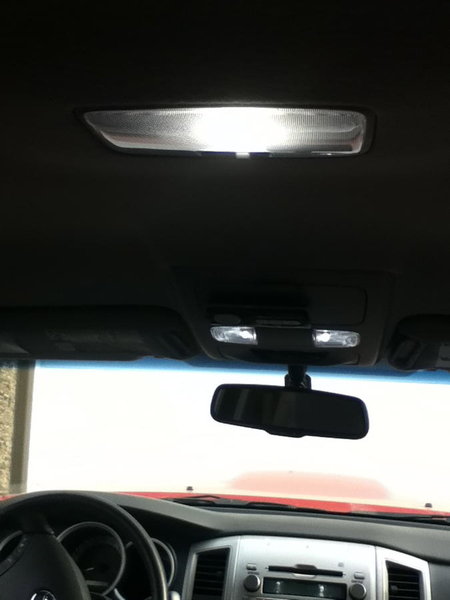

    finally rechecked just a couple minute ago. still has the same issue. it's drawing enough power that it's noticeable. it's only on the map lights. it only shuts off completely when I put the dome light switch to off. anyone got an idea? is it the LED's itself? it can't be the wiring since I did it the same ways as this write up.
    it's noticeable when you're actually inside the cab
