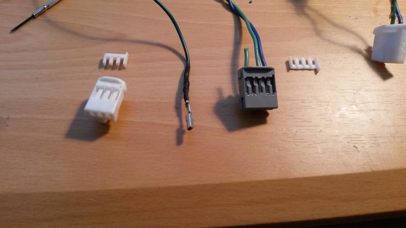

    You have to lift up the tab on the clip and the wires will become loose.

    Just did this mod, I found that the terminals from the factory speaker plugs are the same as the terminals for the map light plug. Fits great, I felt that is was more secure than just bending the tab.
    Does anyone have an easy way too hook up additional lights to work with the dome light? I'm working on putting some 12v led's in the foot wells and the only way that I can see to set them up so they fade with the dome light is to run them in series from the head liner.
    Does anybody have any ideas or proven methods?
