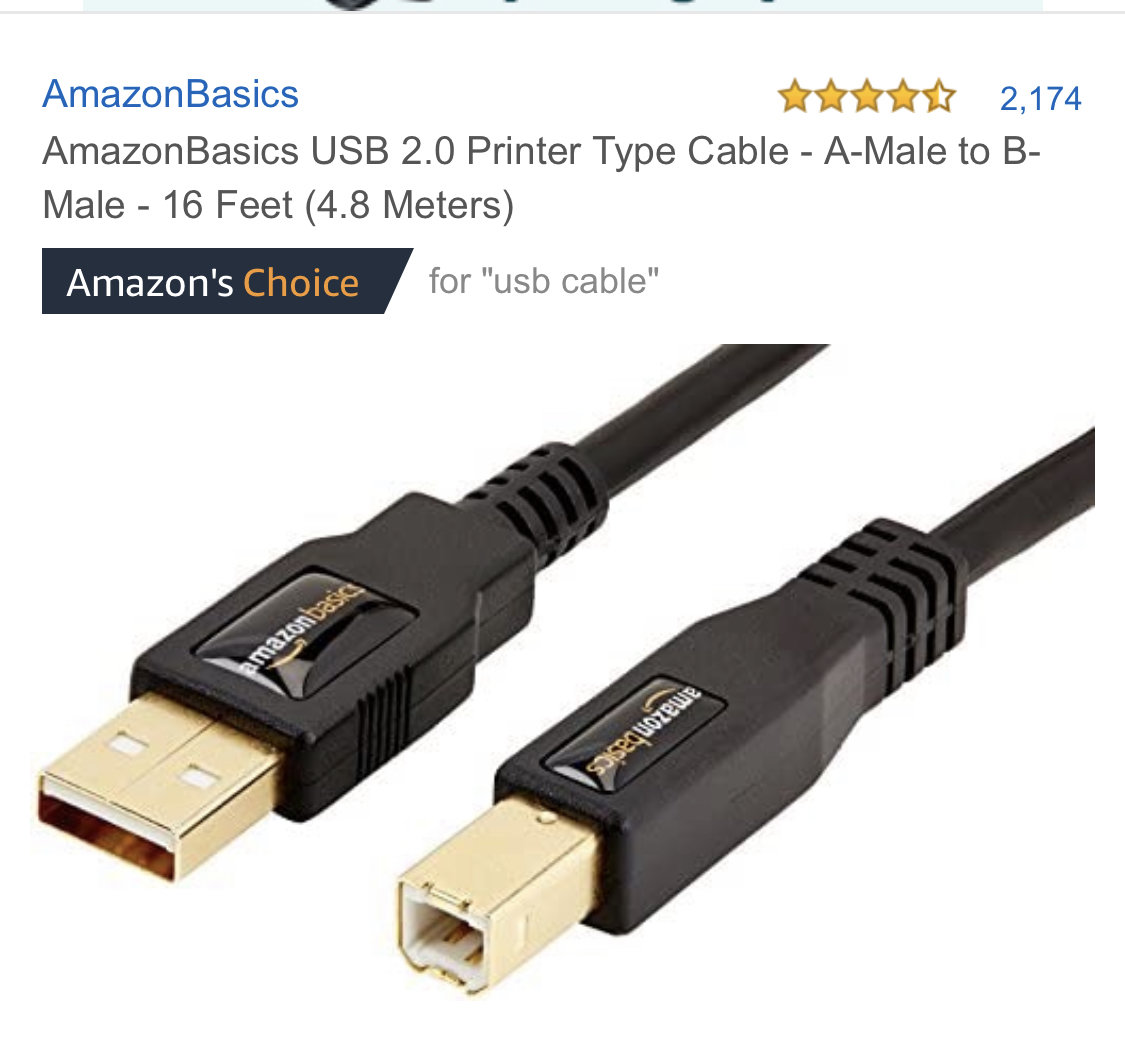

    What are you guys talking about with the printer cable end? My MAPECU3 is usb on both ends. The computer end is USB-A like every PC out there. The MAPECU3 end is USB-B, which is the square USB plug.

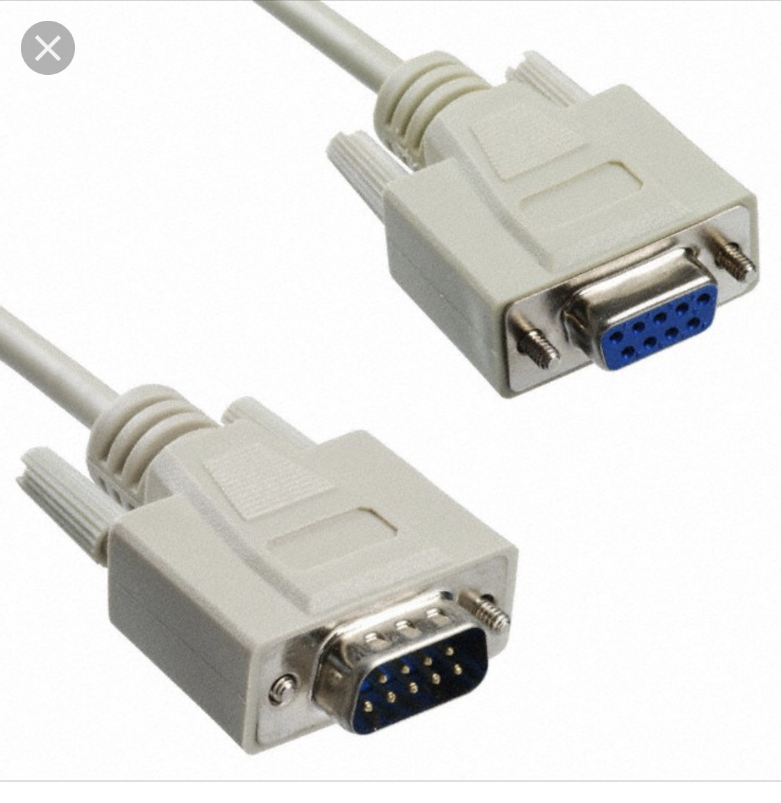

    USB-B
    Printer Port
  8. Nov 5, 2019 at 7:04 PM
    #28
    tacoglock19
    tacoglock19 [OP] Well-Known Member
    Mar 25, 2014
    #126188
    456
    Jawja
    2019 Nissan Frontier SV V6 4x4
    Stock as shit!
    It is not the top one for sure. It is a variation on the lower one. Not as wide and not near as many pins.

    That's a DB9 serial port connector.

    Oh crap good clarification. Yeah use a USB A to B cable. If you do use serial you need to change your settings to serial

    So, I got it connected to my ecu and was able to run a data log. Don't know exactly what I am looking at yet but I have my foot in the door...
