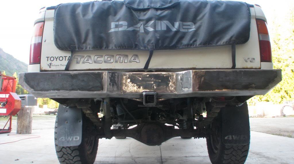

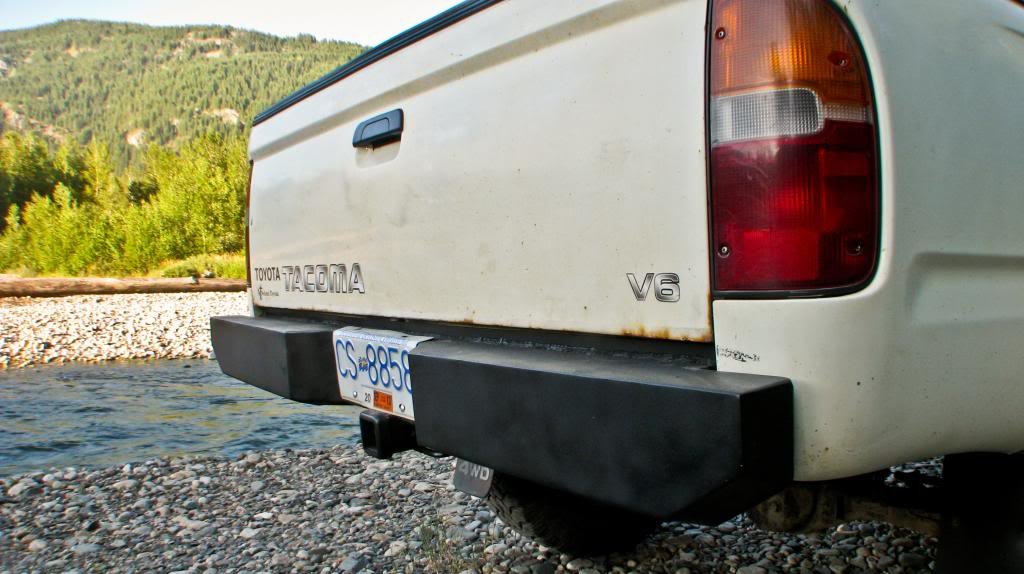

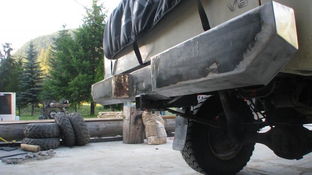

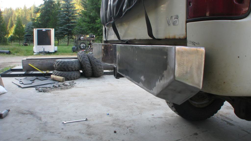

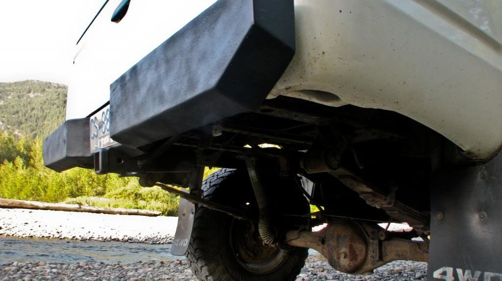

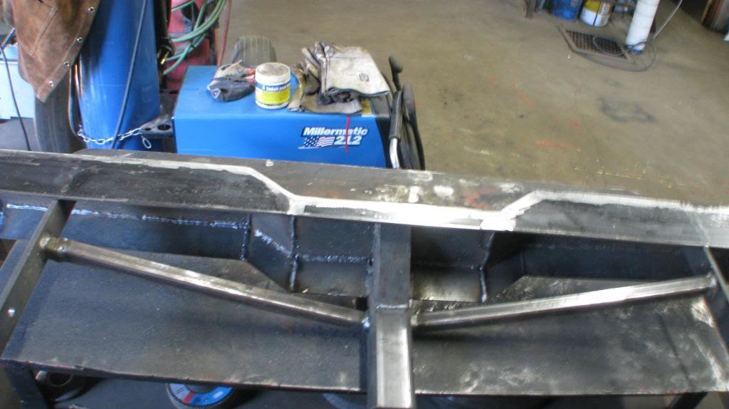

    Custom Rear Plate Bumper
    Specs:
    3/16" Plate steel for the main body
    1/2" x 2" Flat Bar for the frame mount
    1"x1" 3/16" Square tubing for the hitch supports
    1/4" Hitch tubing
    Couple thing i want to add:
    LED License plate light
    Recovery Points (Although i can use the hitch shackle)
    Bedside protection
    Tire swing mount
    IMG_2708_zps1effd6df_2d348d98512661fe05e335310234ecfb4a900737.jpgIMG_2709_zpsc5fcd0af_8e0d8641f6bd42158817fed99ad9703899cd76e3.jpgIMG_2710_zps6c22587a_851781db489eee540fd0682d311610666dec2cef.jpgIMG_2711_zps2af9d7af_2f5f0a96eccd2c7386fab5325766b1444d485531.jpg

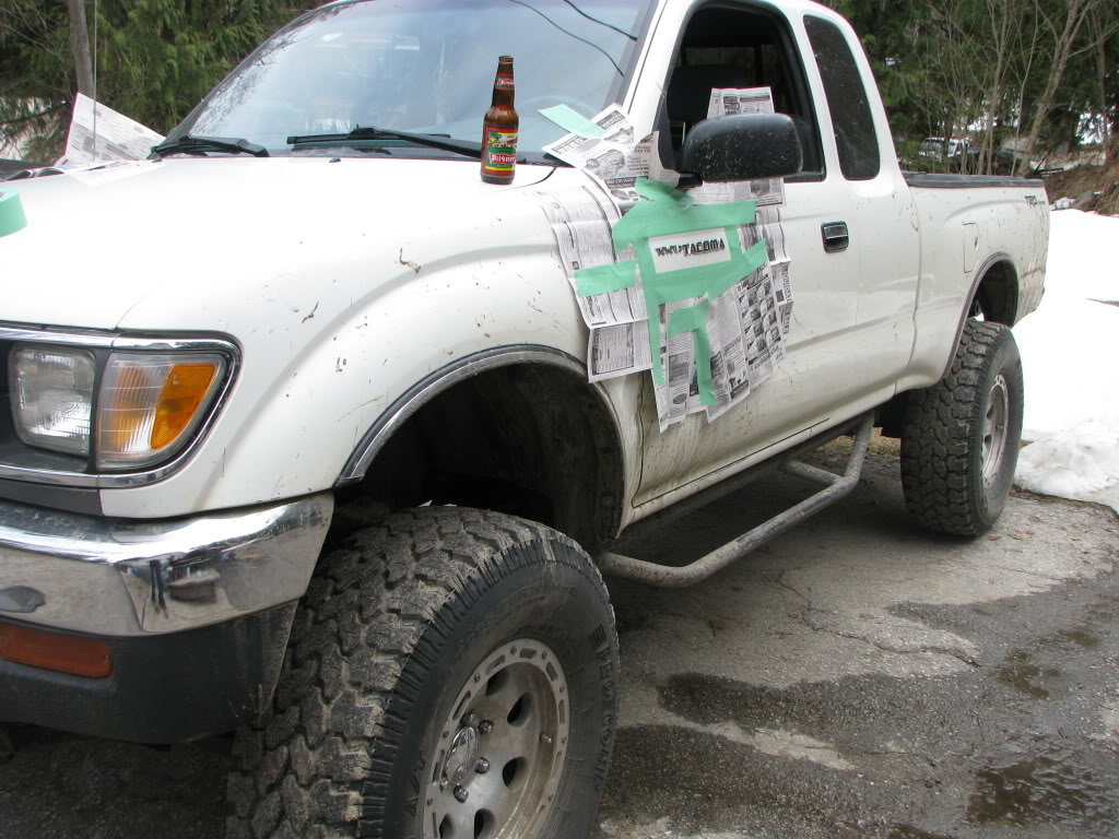

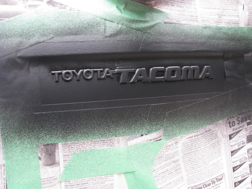

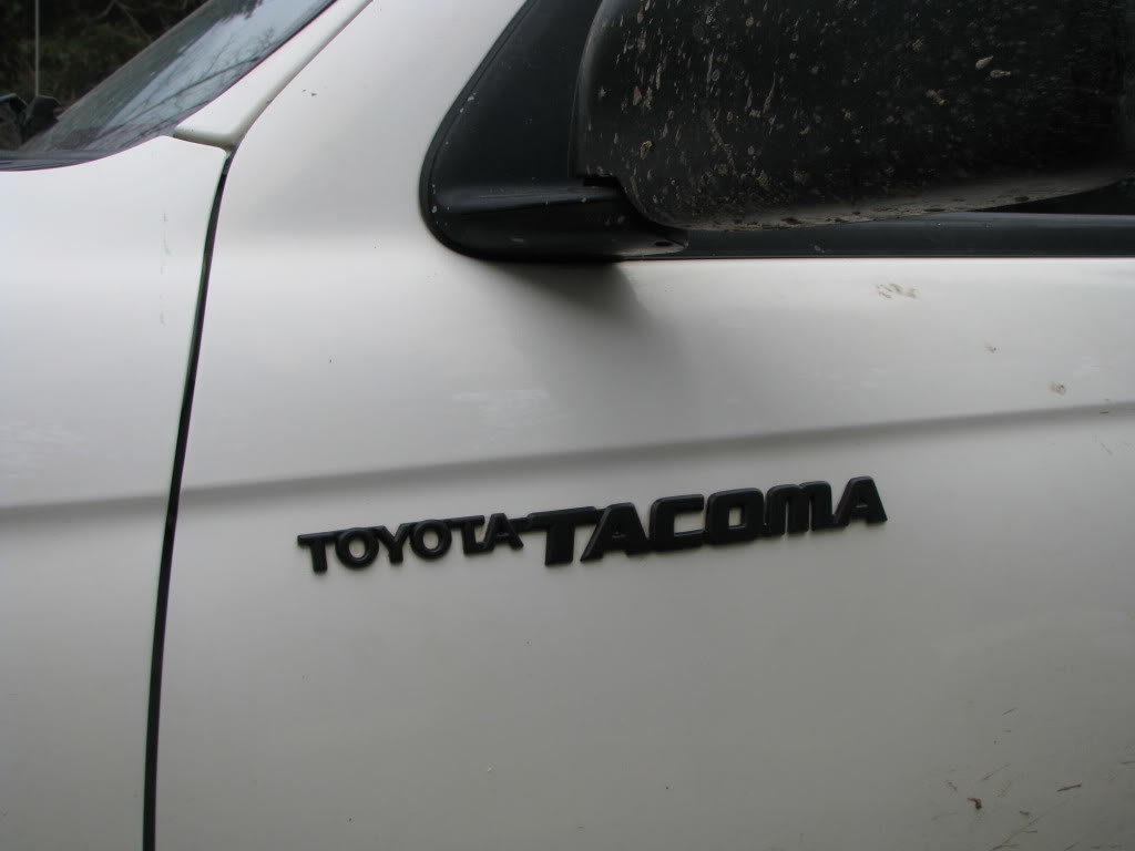

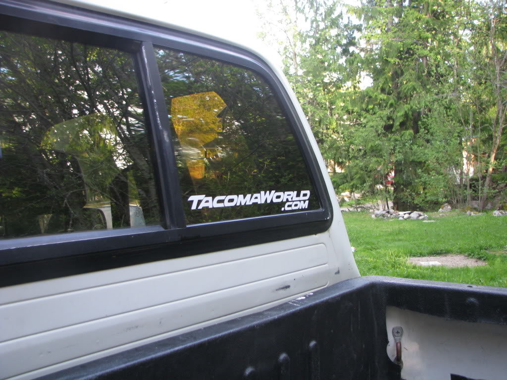

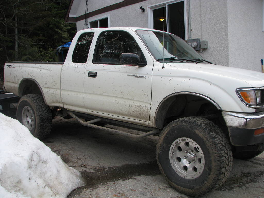

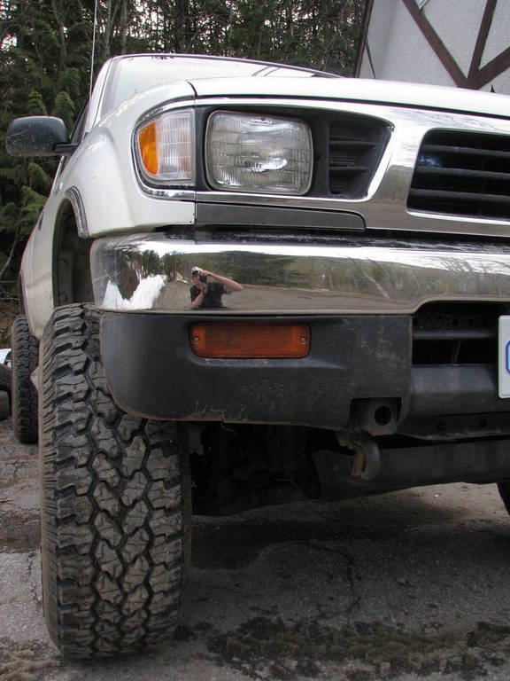

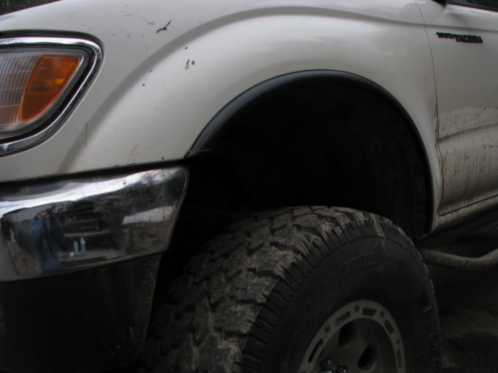

    New tires!
    Pro Comp Extreme A/T 285/75/16
    Plasti Dipped (or should i say sprayed) my badges and fender trim
    Deckplate mod installed :cool:
    TacomaWorld Sticker
    Painted the skidplate and installed clear blinkers.

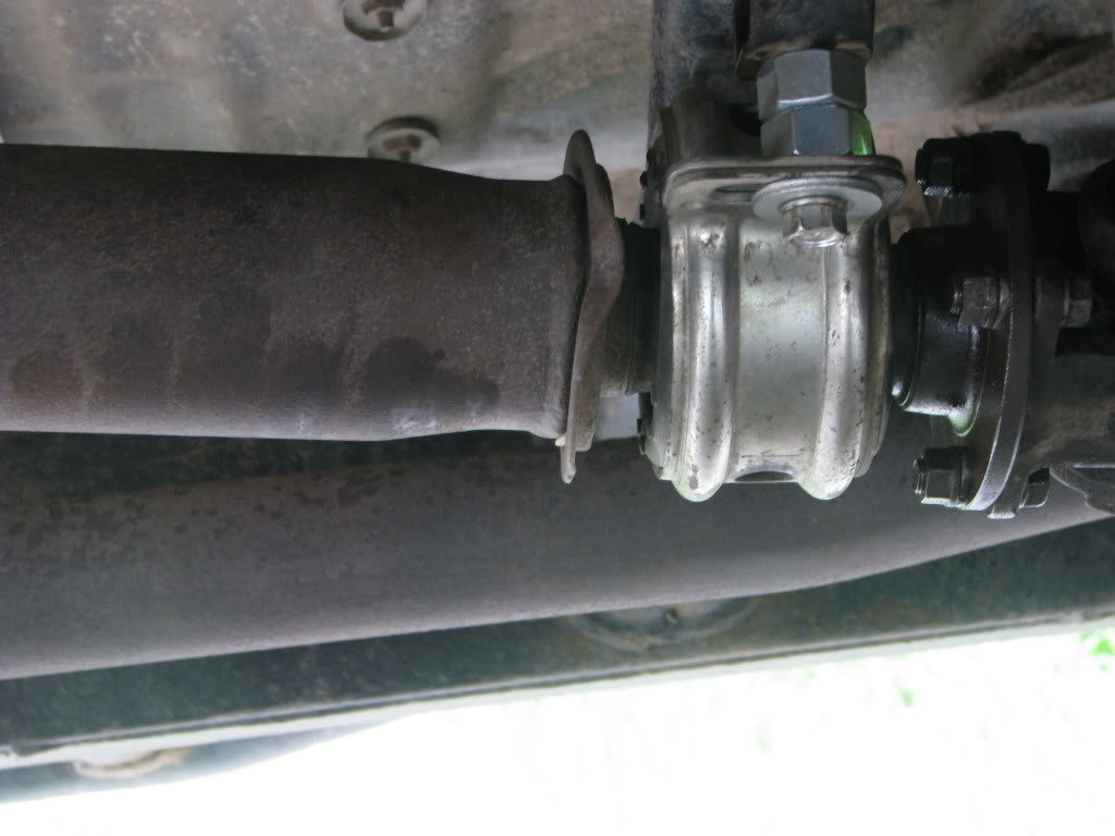

    Replaced carrier bearing, so i had to rig something up for a drop. (4) 5/8" nuts

    lookin good! is that a body lift or suspension lift? i cant tell

    Its a 3" body lift and leveling kit. 3" blocks in the rear and a 1" spacer in the front. Im swaping the front and rear suspension for Bilstien 5100's and ebiach's.

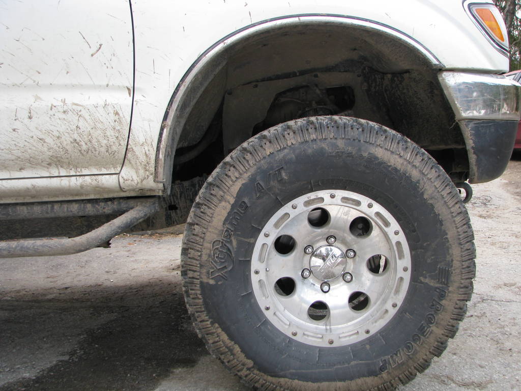

    Those still look pretty good! Im having some rubbing on the bumper when i compress fully, rubbing on the frame at full lock, and slight rubbing on UCA's
    Not to sure how to fix it without putting in wheel spacers.
