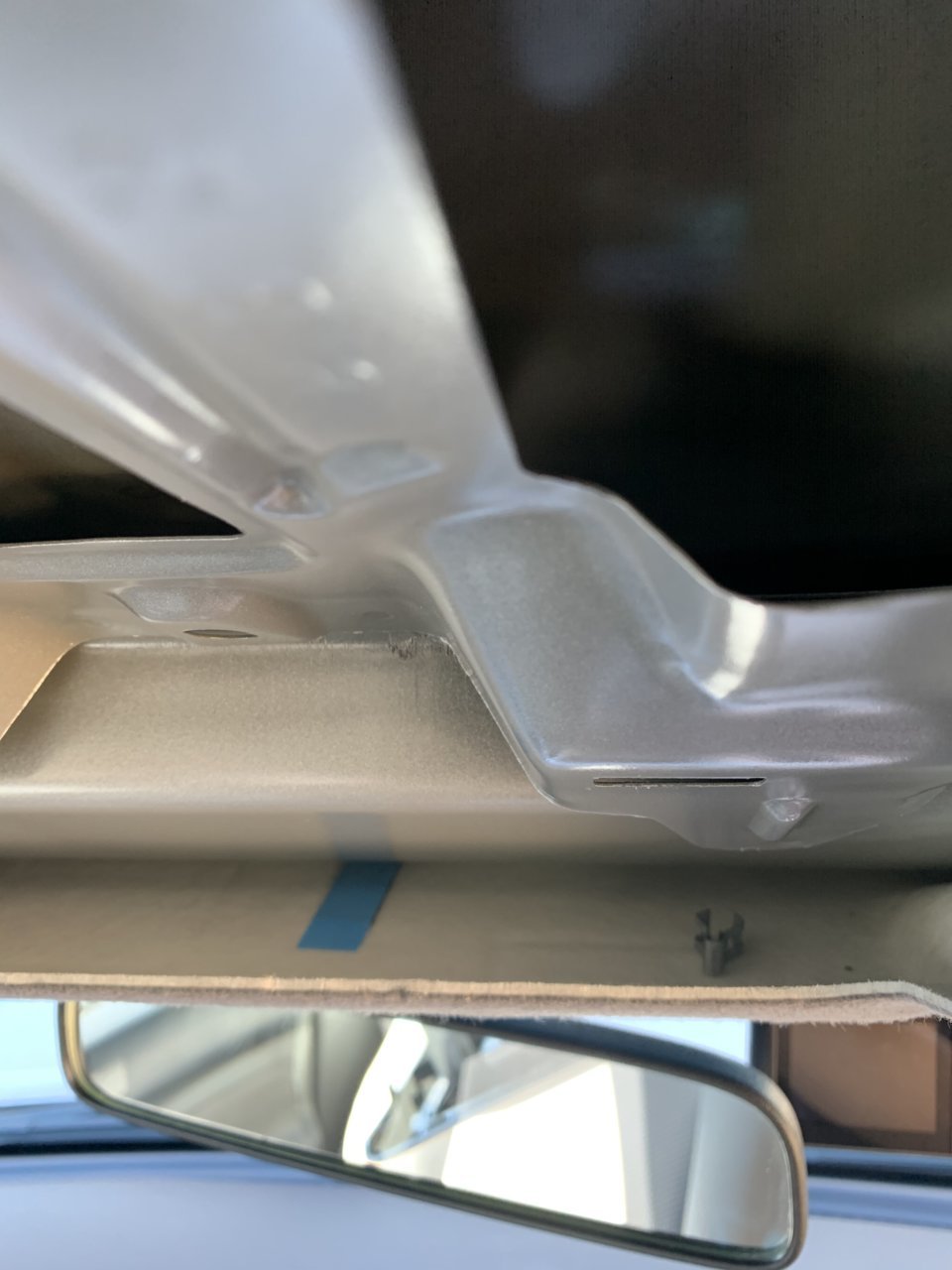

    Think I found it

    So pretty sure I have the same problem, but I can’t quite tell what you have removed here to find the clip. Any help would be appreciated as it’s driving me bonkers.

    I pulled out the overhead console with the temp and map lights. It's one screw in the glasses holder that you remove to be able to take it out.

    Thanks much for the reply I will give that a whirl. So funny I would have bet money it was behind the dash

    Let me know if it works.
