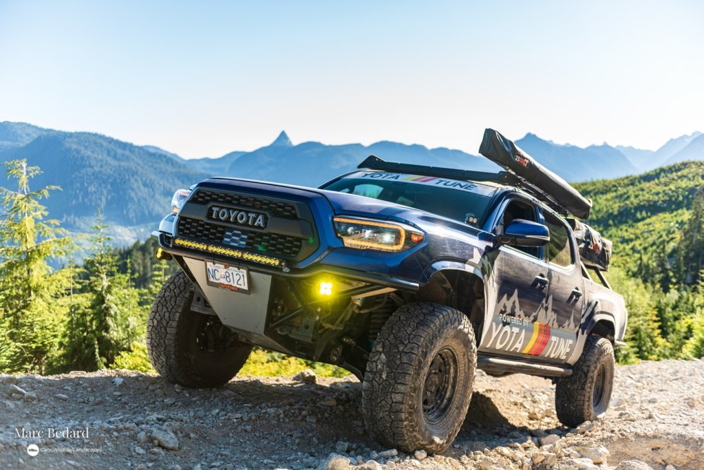

    April 2024

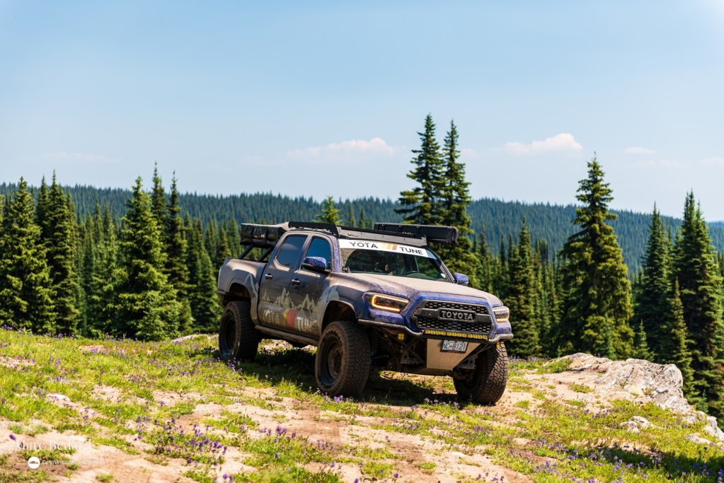

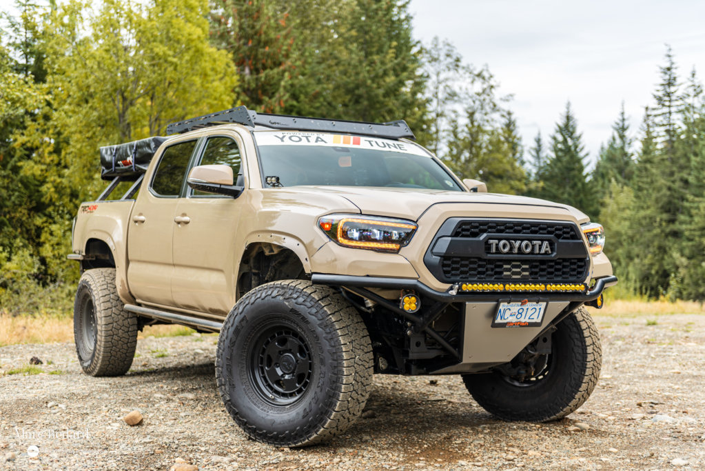

    Finally got out to shakedown all the recent additions over the winter; I must say it's been a blast to head back out there! Nervous at first as i was pretty rusty and out of the old "pack up and go to trails" routine. Not being sure how things would feel like or if something else would then fail. Have to say, the truck handles better than it's ever did. What feels featherlight in the rear with the new C4 bumper (vs Coastal Offroad), frame reinforcement and no rtt gear.

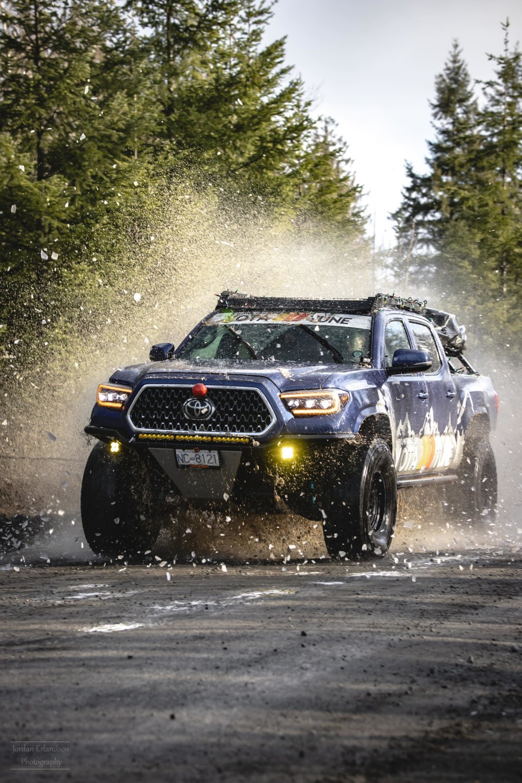

    Aired down to 15psi, normal speeds on FSR (30-60km/hr) the truck behaved well over ruts and pot holes, a few good hits of the full travel in the front but nothing to be alarmed about. The front end felt tight, letting go of the wheel, the truck kept tracking straight over bumps and holes in the road, the rear end felt planted, ramping up speeds at time (80-120km/hr) everything feels incredibly sound and stable. Over washboards, the truck doesn't feel like its hoping around sideways as it used to do w/stock everything. I know many mentioned the frame flex is huge but I would've never thought it to have this effect once plated/reinforced. Well worth the extra work and time.
    We took the trucks through a few varied trails mixing up the fast pace, to slow & technical crawling.

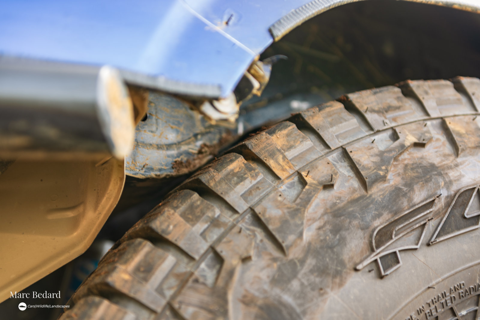

    I still have to fab the rear corner pieces but gives you and idea of clearance i suppose when the rear end is up in the air.

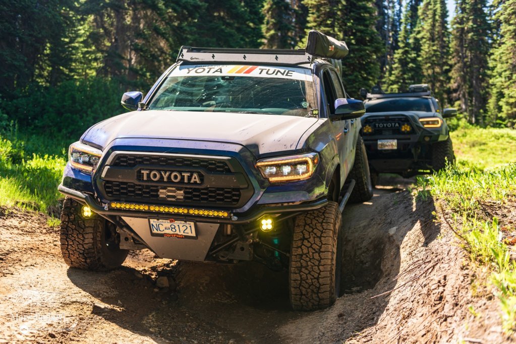

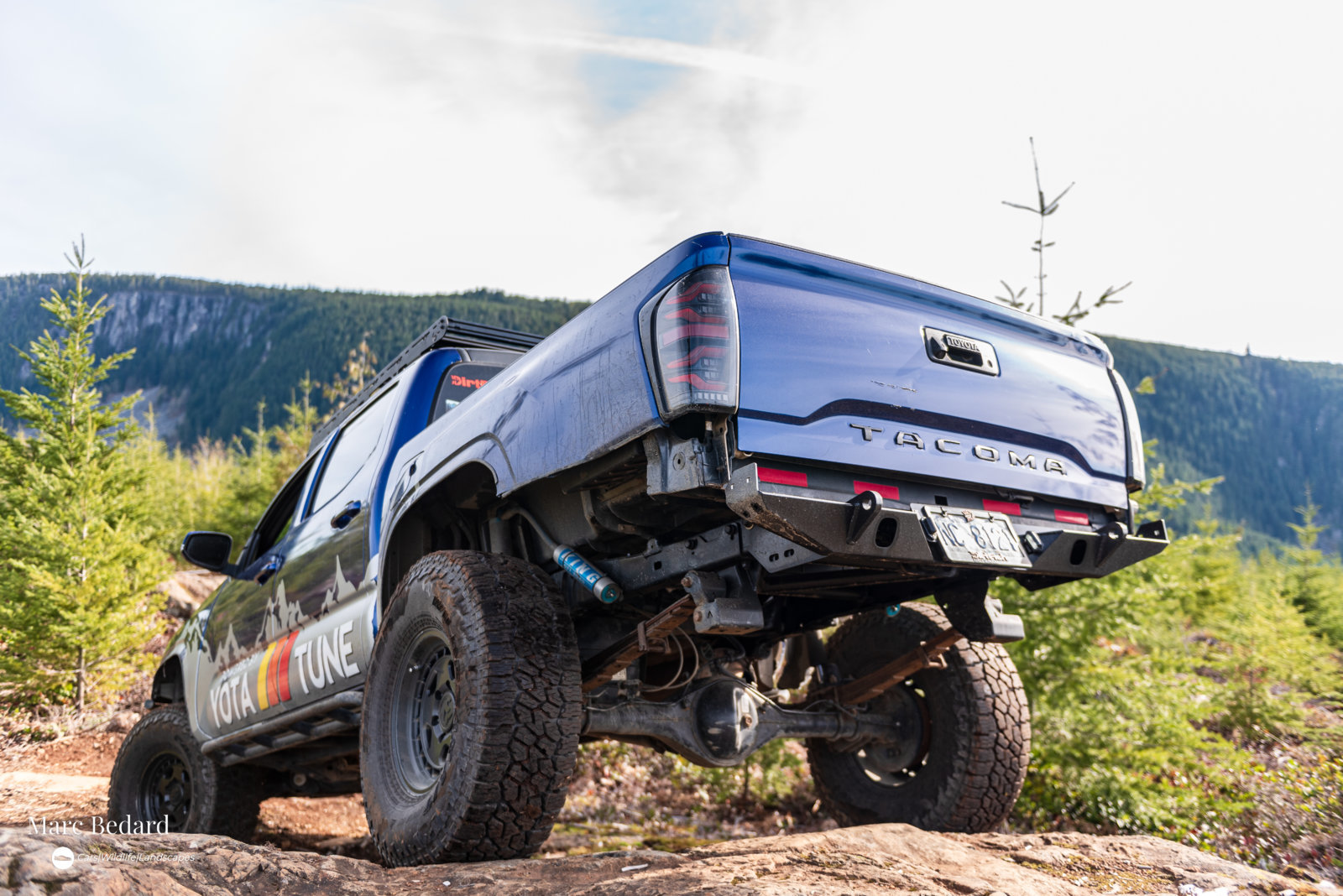

    Finding some old technical spots through the forest, narrow passages at times!
    One of my favorite trail with a fun flex shot. I remember an older photo from that exact spot w/older step up and its nice to see the build growing as the year goes by.
    2022 vs 2024
    Now stuffing the 35s up front...
    Cue in "i'm this close to lose my shit". Eventual plans are to say good by to the inner fenders and get my hands on the JD Fab inner fender kit.
    Quick pit stop while friends ahead are going down a steep bank.
    Photo will not do justice to the incline on this one, as the dash came up with the "add engine oil" light.
    For the time being, incredibly satisfied with how it all handles; with the gas prices skyrocketing higher, it's hard to go out and relax, and enjoy it as much as i used to years ago...But it's time for some regular upkeep and planning forward for what's to come.

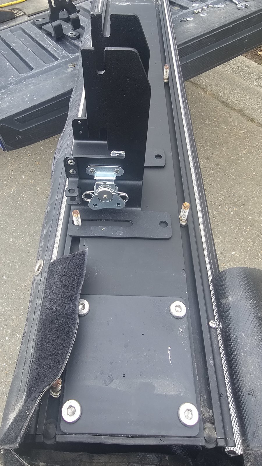

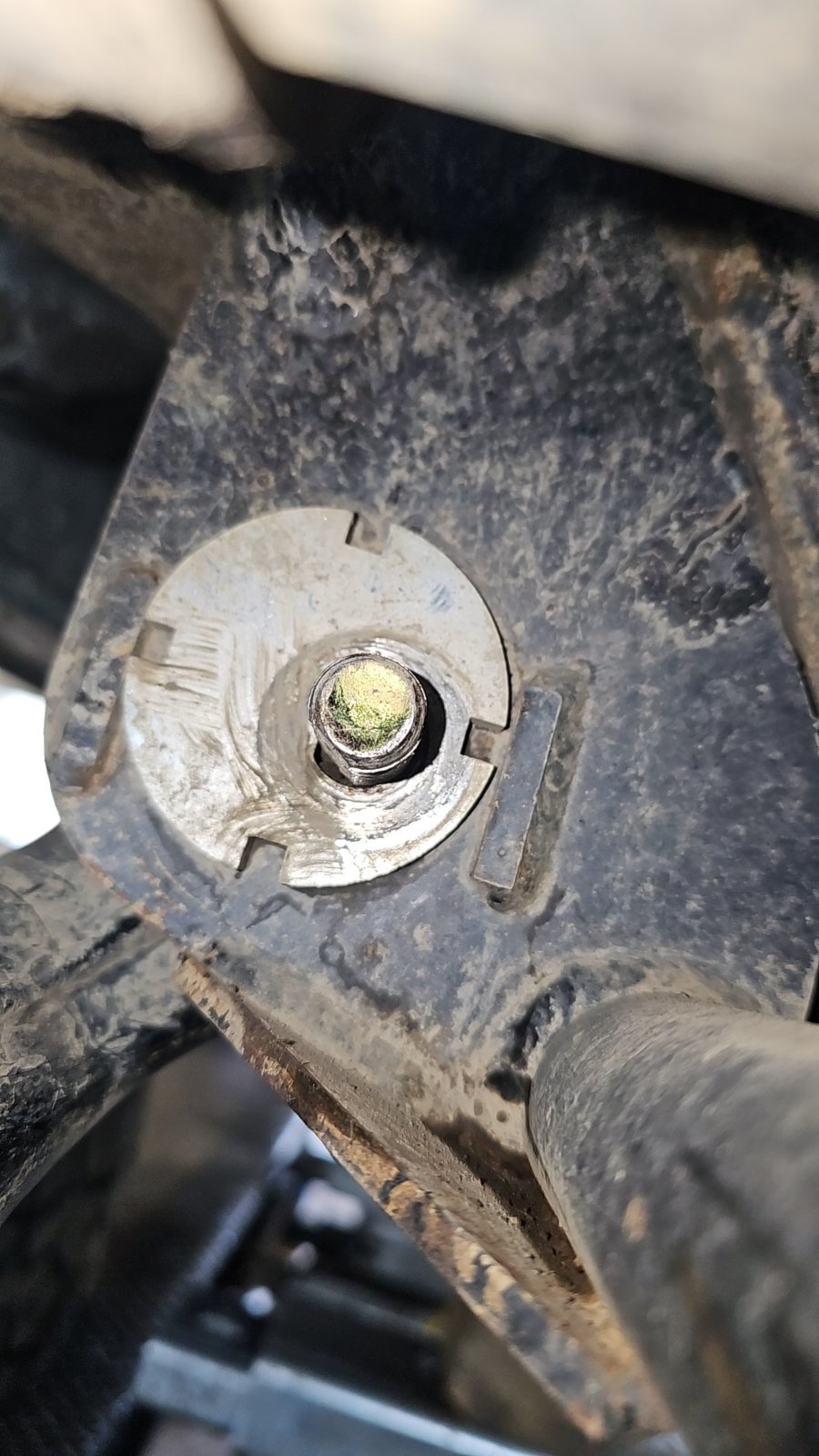

    Finally tracking down some clunking noises, both Lower BJ had a decent amount of play in them. Ended up getting new arms for simplicity and faster repair job...until I noticed that the shop who did my 2x alignments last year messed up the JDFab LCA pivot kit hardware...
    Initial was done May 16 2023 right after having the LCA Pivot kit completed w/new LCA arms and everything freshly greased...Second alignment was done October 2023, after upgrading to the JD Fab. stock width billet heim tie rods.
    I could not get the rear bolt out due to the shop using air tools for whatever reason...resulting in the shank bolt & washer to "cross thread" and the front 28mm (1-1/8") bolt had threads missing as well!
    After a little bit of confrontation, they manage to agree to cover the cost of new hardware and a new alignment...Huge thanks to Overland Outfitters to scramble out of their way and get me replacement hardware within 2 weeks!
    In the meantime, Baja Designs warranty dept. shipped back the S2 lights with updated internals, bezels and housing! Couldn't be happier with the outcome, overall took a few weeks and customer service was great start to finish!
    Forward a week or so, Prinsu Quick release awning mounts are NOT compatible w/23zero Peregrine 180* awning. Ended up returning and putting money back into a set of Baja Designs S1 amber wide corner to complete the rear bumper chase lights.

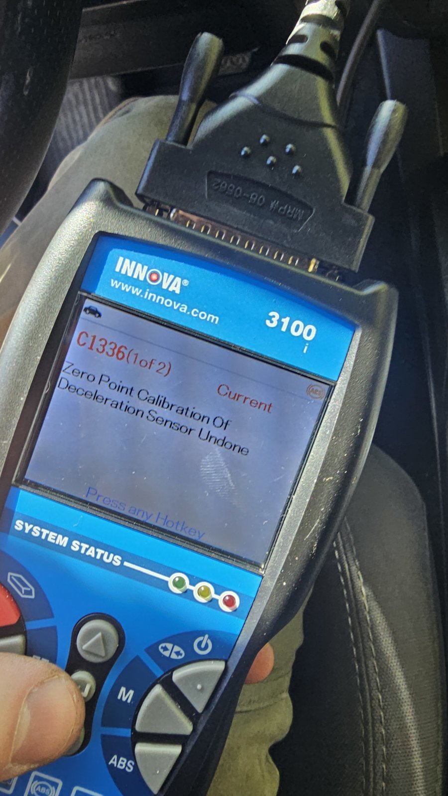

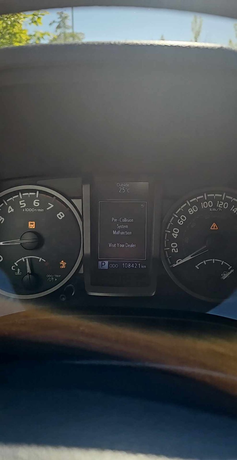

    Fast forward to yesterday and recent week...Sawzall the LCA, threw in new replacement arms, greased everything, and got it in for alignment as soon as i could. Previous specs were roughly 5* caster, 0 Camber/Toe....
    For whatever reason they couldn't get to 5* again but close to...
    Buddy coming back from test drive mentioned it drove really well and tracked nicely; although the Pre-collision sensor came on. Which followed by sometimes they pop up after alignments and go away...Figured it was the sensor being dirty, but drove right to Toyota dealership to have it scanned....
    200$ later and no conclusion other than "how deep do you want to investigate this..." there was many codes and uncertainties of where to begin diag. followed by "truck is heavily modified"...OK Tire mentioned they always relearn the steering angle sensor after each alignment, and due to the fact i asked for "out of spec / oem numbers" it could've been why it tripped the sensors...Although all my previous alignment were out of "oem spec"
    Spent all morning trying to self diagnose with no luck.
    C1336 - Zero Point Calibration of Deceleration Sensor Undone" comes up, cleared but comes back the moment i lurch forward or reverse.
    - Cleaned radar/cruise control sensor + disconnected etc...
    - disconnected negative battery terminal for a while.
    - inspected cables/plugs under dash/steering wheel area.
    - inspected under trim pieces of steering wheel for signs or possible clock spring issues? Everything seemed fine.
    - Found 2x sensors, 1x under each headlight next to the radiator w/yellow clips but i figure those would be airbag/crash sensors...
    - Attempted the 2nd gen paperclip trick, nothing worked.
    - Traced a few wires, nothing obvious showing up...
    Quote for a new sensor was roughly 1K $ and new cruise/radar sensor roughly 700$+tax. Which sucks because I've never ever had those issues come up in the past even with the lift. Factory grill and sensor etc.
    Browsed around on forum threads here but nothing more that i can think of at the time.
    I don't feel like throwing a bunch of money to replace random sensors in hope one will work or hopeless amount of money for shop labor either...Maybe replace both wheel bearings & ABS wheel speed sensors? Then again, that would've tripped the ABS light. I only have the Stability Control light on along w/Pre-collision malfunction...no cruise control and no tilt/angle meter as well.
    If anyone has gone through those issues or could lead me in the right direction for a fix, please let me know!

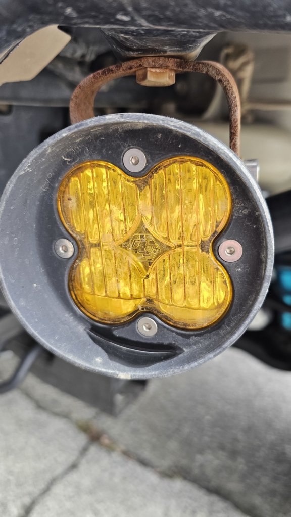

    Early snow dump up in the alpine this year, but my Baja Designs fog lights finally gave out taking in water after 4 years. Might have to reach out again for warranty work.

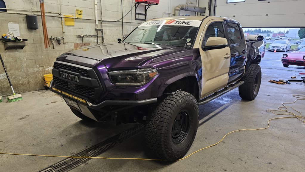

    Chose to switch it up to a "Midnight Purple" and i believe it absolutely came out nice! It's darker in person although pops nicely in daylight.
    First evening ~5.5hrs with a small break, 2x bedsides and 2x rear doors complete.
    Saturday was a full 10-12hr day focusing on the front end, roof & tailgate. Headlights, grille, mirrors, door handles all came a part amongst a few other things.
    Sunday was a quick 4~ hrs finalizing the pillars and rocker panels.
    End product:
