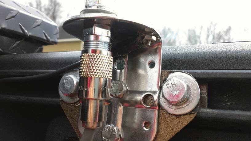

    Best to run the hot and ground straight to the battery helps with everything.

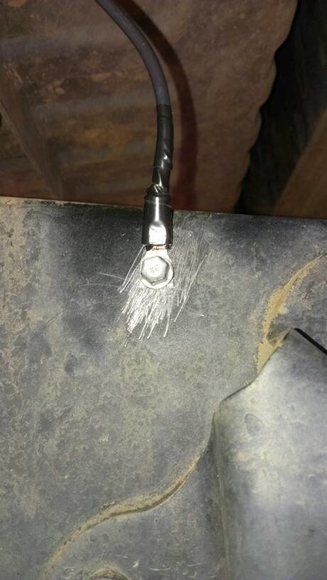

    Receiver ground, yes. Antenna ground, depends on where ur antenna is. A short ground is always best. Or a big ass ground. I ran a #10 about 5 feet to my frame. Ohms out at zero. Perfect ground.

    well you have a good ground. but it also sounds like you have it fixed lol. you know the plastic nylon washer? for the longest time the one i was using was allowing the ant. to ground out on my mount.. kept effing things up.

    Yeah that's what I thought it might have been too but I have an advantage over a lot of other folks installing cb's ...... I'm an industrial electrician and have a $140 volt meter and know how to test, troubleshoot and fix most things electrical including grounds. Lol but hopefully I fixed whatever it was cause damn that shit is annoying!
