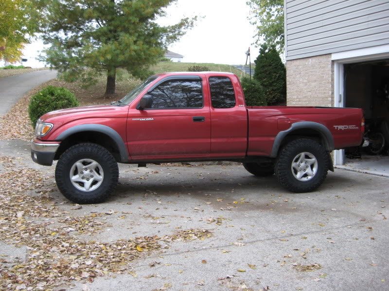

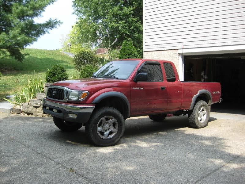

    Bought the Taco when I moved to Kentucky. Here is the panty dropper near stock... OME 881 and toytec AAL
    Got a job at Good Year shortly after putting the lift on. Used my employee discount to buy some wrangler duratracs in 285X75.

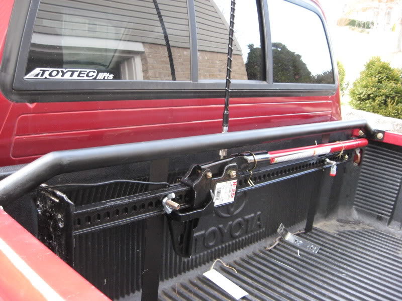

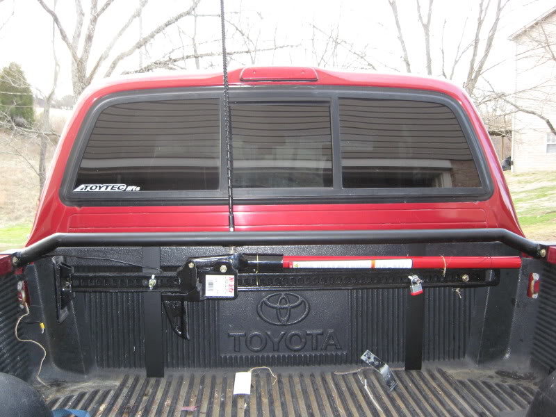

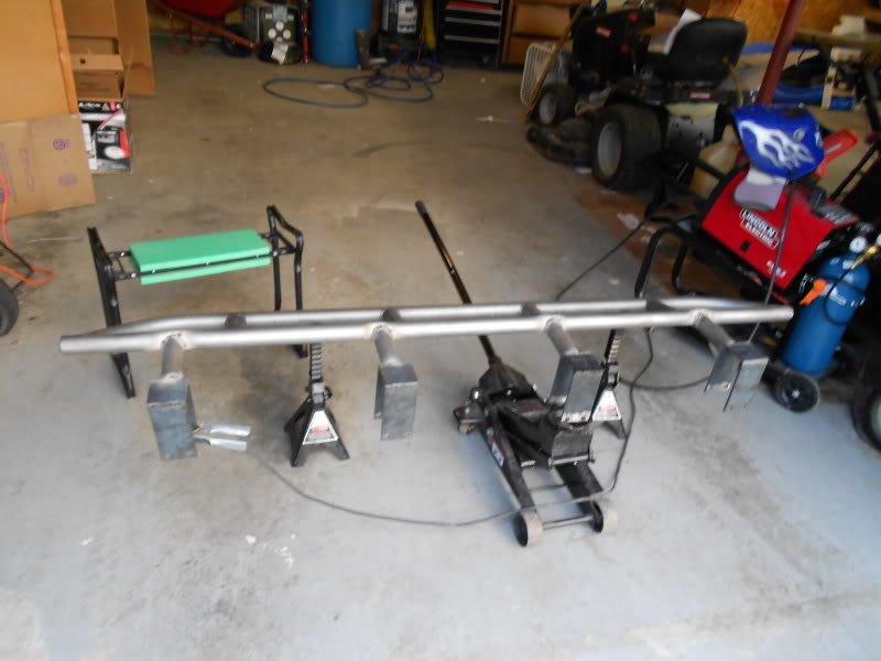

    Picked up a pretty decent 110v Lincoln mig/flux core welder. First project was a bed bar.

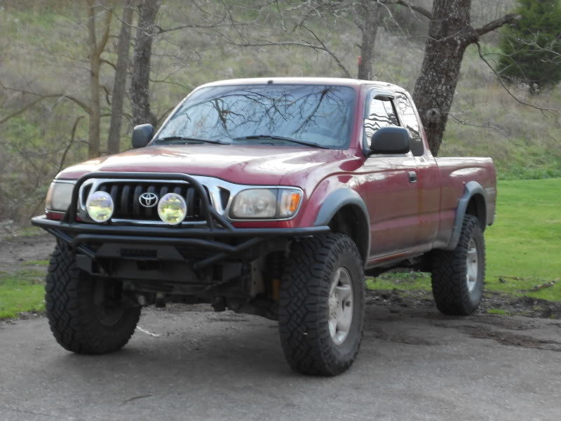

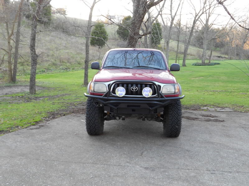

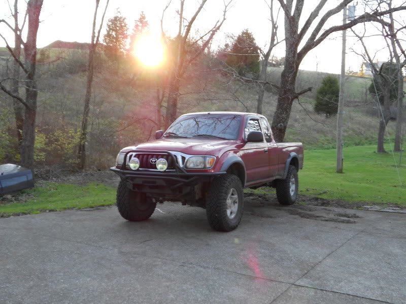

    Started getting back into wheeling so I decided to start getting some armor together. Bought a trail gear low pro bumper and put a stinger on it along with 2 IPF offroad lights.

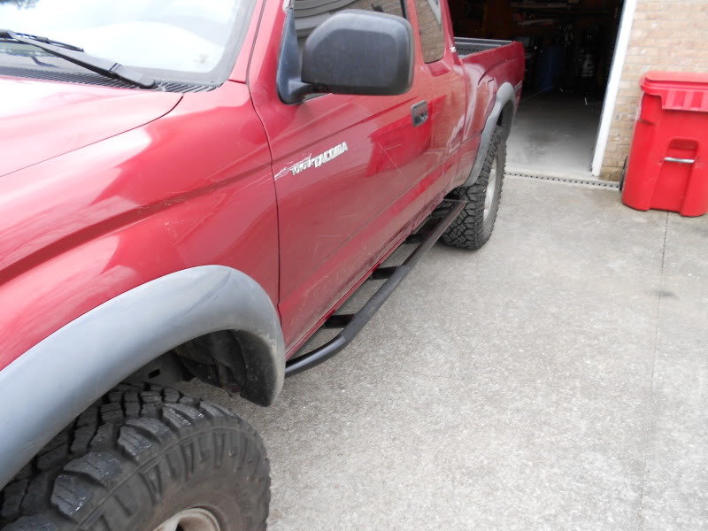

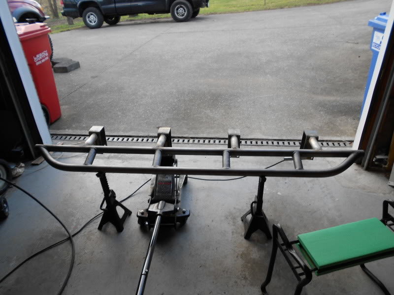

    To bring you all up to the present, I really wanted bolt on sliders in case i ever decided to sell the truck or wanted to take the sliders off for some reason. I couldn't stomach the $400+ for a set of bolt-ons though. Long story short: CBI bolt on slider brackets + trail gear weld together sliders = $240 dollar bolt-ons...

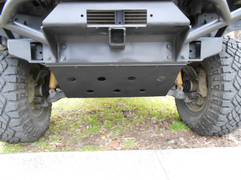

    Also got this awesome skid plate.
    These will be for sale soon and will be a killer deal. If you are interested in one PM haddix here on TW. There is also a thread in first gen classifieds on TW with more pictures/information..

    As for bolt on sliders, my buddy who is a welder says bolt on is the way to go, because no matter how good your welds are, they all eventually tend to crack a little.

    I have also heard that bolt-on is as good or better than weld on because the load produced by a hit is spread over a greater surface area of the frame than on weld-on sliders
