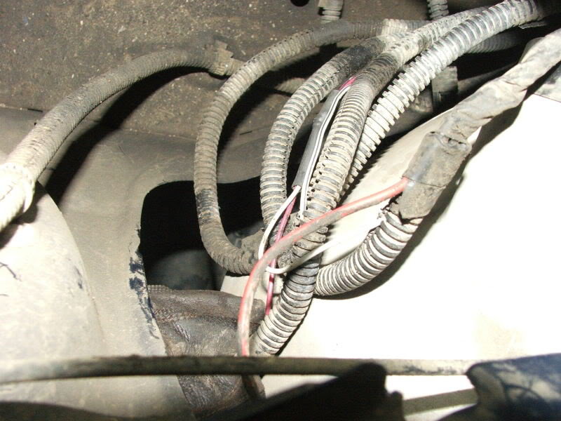

    Yeah I found it, must have just looked over it a few times. Im not sure what i did wrong but whenever i tried my blinker the fuse blew. Do you just cut the black and white wire and splice it into the red? if so what do you do with the loose wire? or do you splice both into eachother?

    B/W into the red. Tape the other end off.

    Okay thanks for the pic. I think i got it now, so you splice in the half of the wire coming from the truck, not the half coming from the light? correct? and tape off the end coming off the light? thanks for all your help

    No, you want the wire (B/W) from the light into the red/black and /yellow.

    Ahh well that is where i went wrong, thanks again man

    That makes sense. The B/W is ground so you were basically shorting the circuit. :thumbsup:
