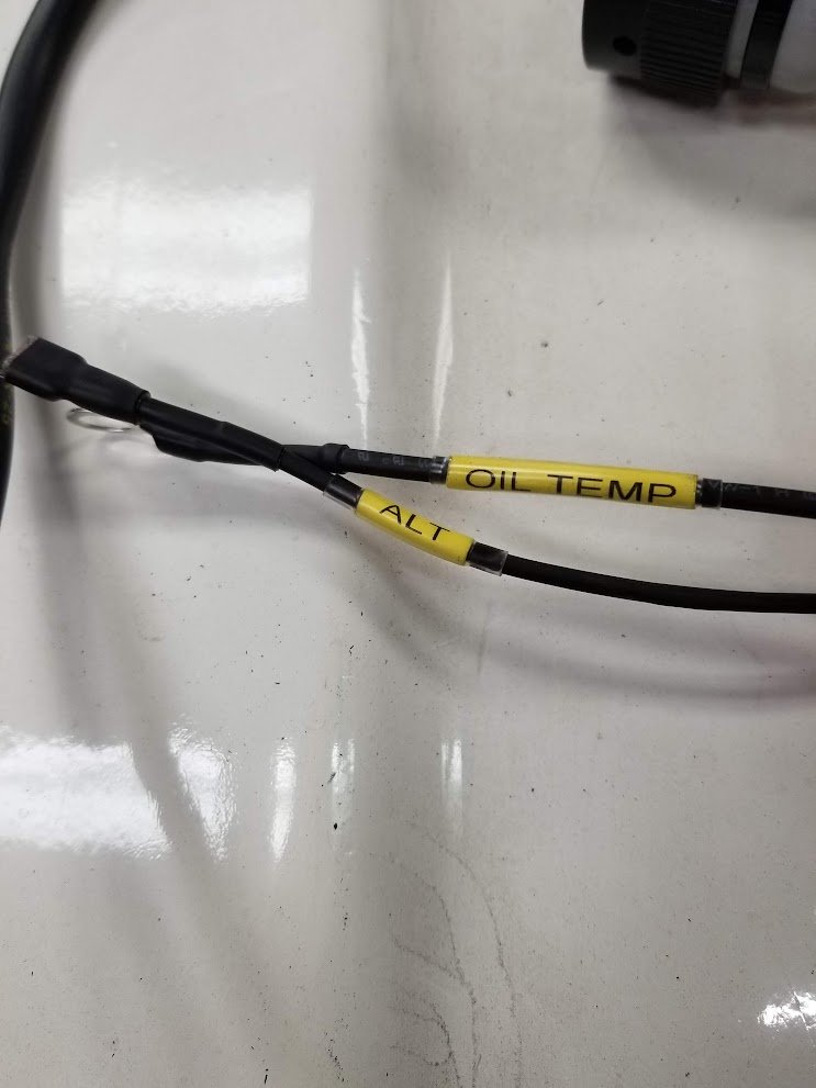

    for me, it depends on what i am working on. for the most part, i like using my label maker that prints on heatshrink. then go over that with clear to keep it from waring off.

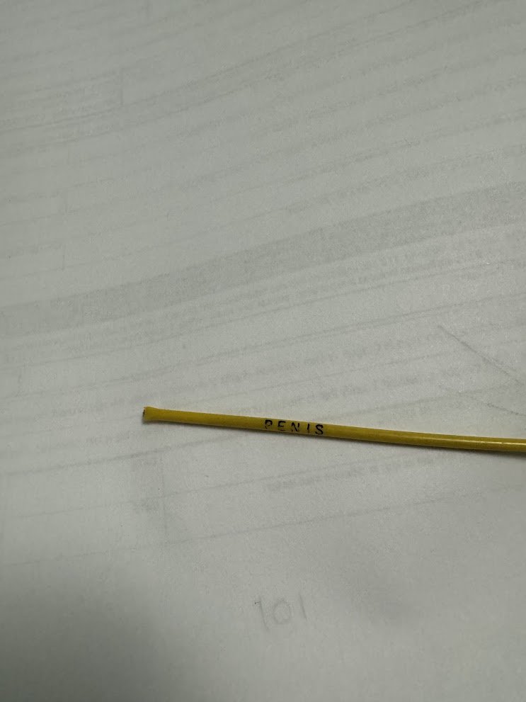

    then if i want to get more fancy i have a old setup from Boeing for printing directly to wire (spec55 wire in pic)
