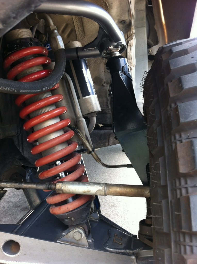

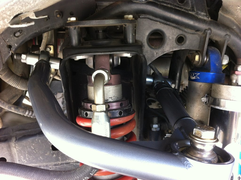

    Work has been killer, wanted to test these badboys out this weekend so DMZ Tim & crew hooked it up and installed the TC spindles and Heimed UCA's for me.
    I was gonna install them myself but Im glad I had him do it, he spent a good amount of time taking the heimed UCA's on and off and adjusting them, trying to align camber. Adjusted my toe, and gave me a general alignment using his old school alignment tools.
    Took it to Firestone, using my 'lifetime', and got the traditional shit from the mechanic when they saw I had an LT kit. I told them that my fabricator adjusted the heimed UCA's and straightened toe as much as he could. They just need to mess with the caster. When I picked it up the tech said " you cant be any happier with those numbers". I dont know anything about the degrees and measurements but he said that he got everything pretty close to OE specs.
    Drove the truck today and it has never driven this straight. The steering doesnt have slop like it use to. When you turn the wheel, it turns! no slight delay. And on the freeway its so responsive I can steer using my knees LOL
    Sorry for the long post, but usually the more you make your truck a dezert truck you never see these "stock" luxuries again. The squeeks get louder, the MPG gets worse etc.
    The arms sit in the middle of the travel now. Cant wait to see how it will run this Saturday now that droop/bump #'s are more even.

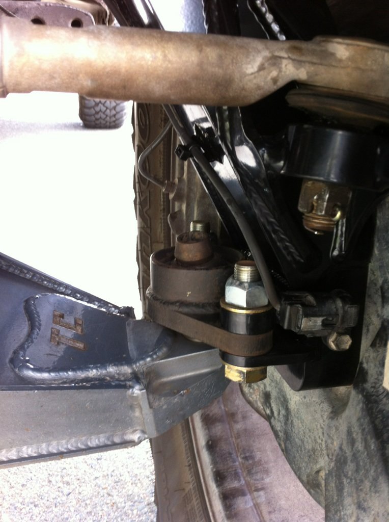

    are your lowers solid mounted or did you tack weld the alignment cams?
  8. Apr 25, 2012 at 5:55 PM
    #148
    Marnes2986
    Marnes2986 [OP] Well-Known Member
    Feb 25, 2010
    #32089
    507
    Mark
    Anaheim-Corona, Ca
    No they're not solid mounted or tacked. Ive got a "paint pen" and I just draw a line from the cam tab to the frame. If its ever tweaked, I just line up the lines.

    are your cam tabs reinforced?
    I finally have mine tacked and it's so much better.
    I used to do the marker and line them up after, but the whole point is to keep your alignment in the dirt to help your handling. With my shit tacked, i dont lose my alignment unless I hit something BAD.

    Yeah my tabs are reinforced. I might have someone tack them and try it out!
  11. Apr 26, 2012 at 9:06 AM
    #151
    blackhawke88
    blackhawke88 wo ai ni bao bei ^_^
    Jan 11, 2009
    #12478
    16,598
    SGV, CA
    07 TRD Offroad
    nice! it only takes a couple minutes, you just have to make sure they tack it in a location that is easy to grind off without grinding your whole alignment cam off haha.
