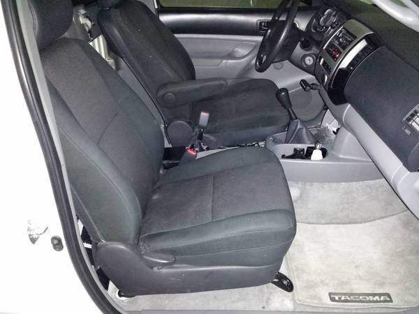

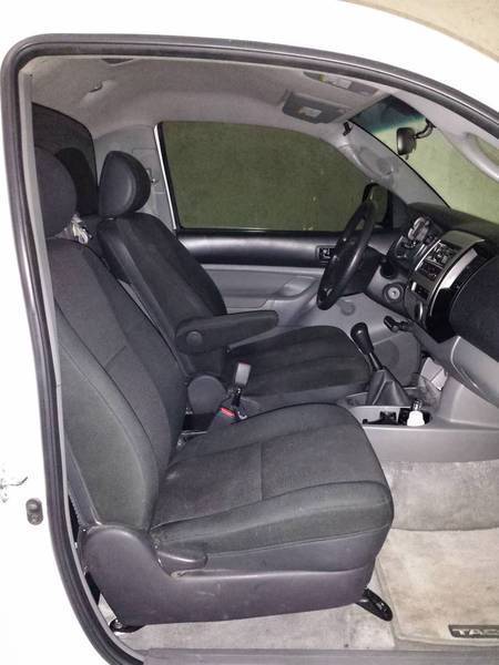

    Done. Thanks for the tip!

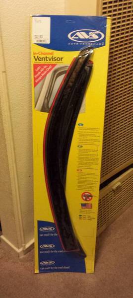

    FJ Seats installed, gotta work on the seat belts next... just couldn't wait to install them and test drive them to work tomorrow! Plus, I'm gonna have them shampooed on my lunch break.
    Tomorrow's project... Window VentVisors

    Hell yeah man! They look great, how did the maiden voyage go with em' in?
    Nice work, but you got a little more to do...hehehe. I replied to your PM.

    It completely solved the "falling out of the seat" issue. I've always had bucket style seating in my vehicles. Having that bench seat and trying to go around corners wasn't as effortless as I liked. Secondly, they are much stiffer (not less comfortable but stouter) and provide better support which my back will surely thank me for. It took some getting used to with the armrest, but I love that feature.

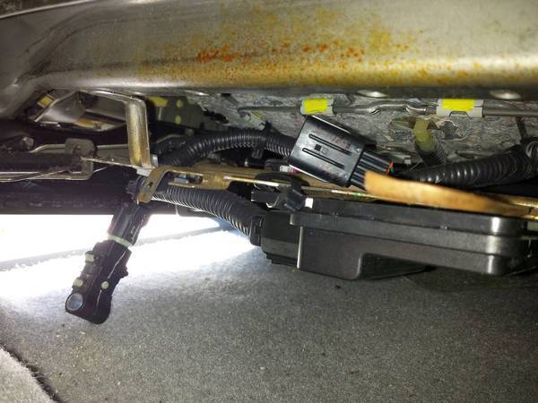

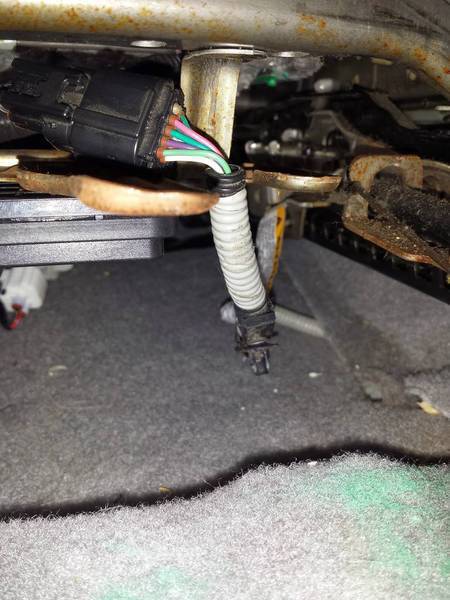

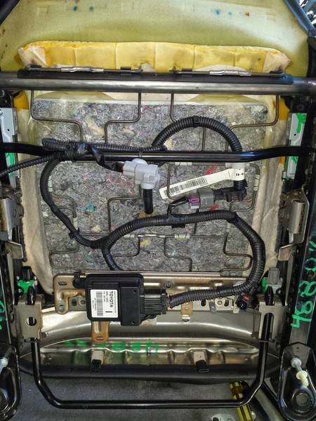

    1) You have to transfer the airbag sensor system into the fj seat and all the wiring from the bench seat will convert over with a little finesse.
    2) There is a hidden grey wire under the passenger side carpet, near the center console.
    3) Then plug in the magnet sensor from your bench seat and just let it hang there.
    4) You'll have to convert the seat belts too...
