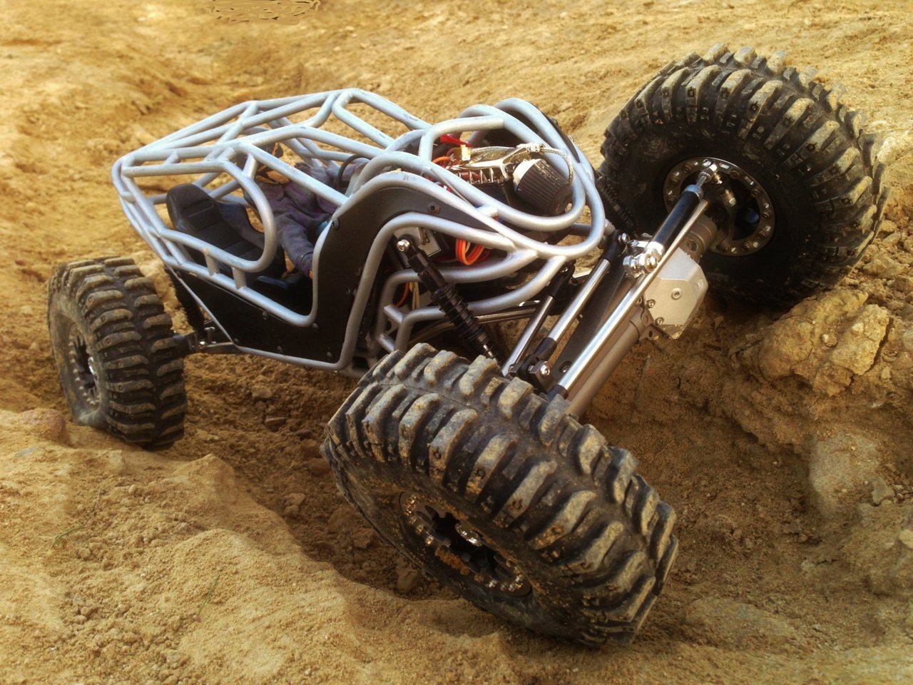

    Yes. You're just reducing the gearing waaaaay down, multiplying the amount of torque put on the ground. This way you won't need to throttle out and stress out your parts climbing up hills. It's better to be underpowered but overgeared instead of the other way around in terms of rock crawling.
    For instance, look at Fred's rock crawler. No taco box but it lets the gearing do all the work.

    As opposed to a Bouncer:
