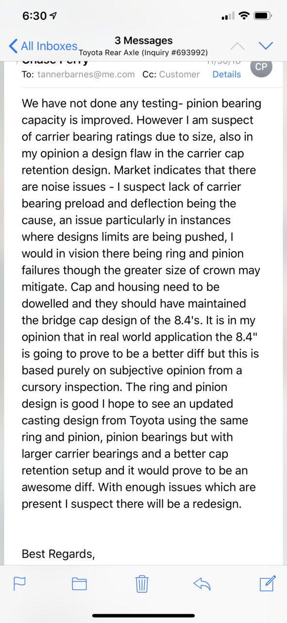

    Here’s what I got when I reached out to reputable shops in the east on buying a used 8.75.

    More deflection, with smaller teeth, in a shock-loading situation is certainly a recipe for failure.

    Hmmmmmm interesting!!???!?!!??!

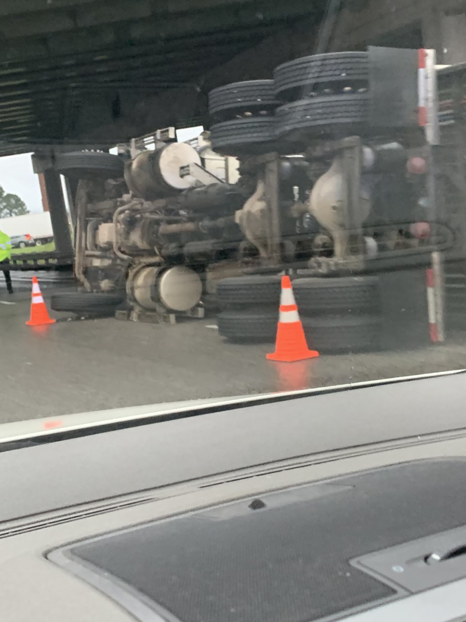

    So it’s on it’s side and ready to pull since you guys want bigger axles.
    This was beside my house. It was a slow moving off camber turn pretty sure guy was okay.
