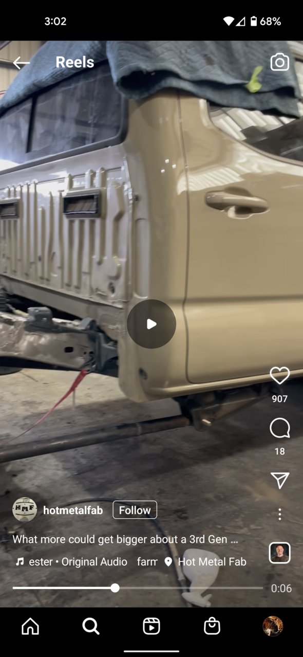

    :popcorn: A week's difference. Ballsy not running any skid plates
    https://www.instagram.com/p/CZYTMiTL9oz/

    Not only short links but on a terrible angle. The axle side mount should be above the centerline of the axle if the frame side is going to be so high

    I usually like nate's stuff, but if those links are shorter or similar length to stock 4runner links, then that would be a major L

    Link length definitely isn’t a one size fits all approach. Wheelbase and angle plays a big factor. If links get too long and start to get close (or beyond) the center of the truck some weird stuff starts to happen with chassis control. Plus they will bend and hang up easier. Longer links will help flatten the angle out though, which is a huge positive.. so it’s all a compromise at the end of the day. My front links ended up around 39” and they’ve been perfect for my application

    I hope the owner of that hotmetalfab truck doesn't plan on crawling with it, those lower link mounts are going to be boat anchors. Pretty obvious none of the people involved in that truck actually have experience crawling LWB IFS vehicles.
