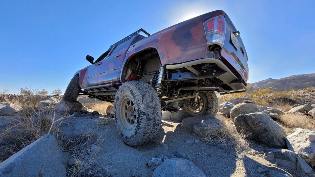

    DirtlifestyleNate
    DirtlifestyleNate Member
    Feb 6, 2022
    #389457
    23
    Nate
    2021 Toyota Tacoma
    Long travel suspension front and rear
    Multiple was to address this question.
    First, share the data you used to determine stock wheel travel. Then site your source for the data on my truck. Clearly I'm asking for a reason... you are guessing.
    Second.
    If you have 38s with stock travel you still have a far superior truck. But that isn't the case here. This truck has tons of travel however I'm willing to meet anyone with a stock tacoma and hit the RTI ramp so email me if you want to proove me wrong.

    DirtlifestyleNate
    Feb 6, 2022
    #389457
    23
    Nate
    2021 Toyota Tacoma
    I build stuff in my shop and share it with folks who want to watch. Concepts that I am firmilar with end up on the white board so I can answer questions in the best way I can. My channel is about creativity.
    But every 4x4 builder knows that packaging dictates the end result. This pan hard is short because of packaging constraints. I understand the sacrifices I made as I built it. A longer bracket on the frame is not an option. These frame are to weak and the mount would drag into rocks. Longer that I already have on the axle side is bad news as well. I did what all chassis builders do and got things as close a possible knowing that this truck will still perform... And it does. This truck kick ass in the rocks, on the trails and even on the hwy.

    DirtlifestyleNate
    Feb 6, 2022
    #389457
    23
    Nate
    2021 Toyota Tacoma
    Lol dudes! I'm trying to put out an olive branch here. The RTI suggestion was just to try and give you what you want!
    Well at least we all can agree on something lol. I don't think the rti ramp directly correlates to trail performance either I was just trying to give you some metrics since there was so much talk about the lack of wheel travel.
    Here is the reality.
    This truck is bad ass as a rock crawler so far. The limits and constraints I have put on this truck due to packaging aren't showing up in any measurable way. The truck has a ton of flex for such a small amount of work. It steers, drives and handles beautifully and it's not even done. The plan was use the suspension and reevaluate when I toss in the new rear axle in june. The pan hard bar might get longer, so might the links, but if you watch the channel you will see I experiment alot! I try and push boundaries and show my findings to whomever is watching.
    Now, I have been gone for a week and I miss my kiddos. I bought them a couple rc crawlers so I'm going to excuse myself for the next few hours to crawl around the living room and get silly. Feel free to ask more questions
