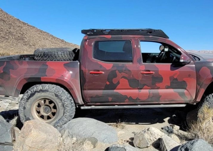

    I'm in Socal and I'm loosely familiar with the trails in JV since I've run a couple of them in my 2nd gen. Based on the 60 seconds of actual crawling in that video it looks like you may have done Boulderdash. Fun trail, but when I ran it you could easily do it in a tacoma on 35s. Did you take your truck on anything harder than Boulderdash?

    Boulderdash/Lower Johnson and Fissure were the first trials I did in my 2nd gen at the Hammers , then the next weekend was Claw Hammer, been hooked ever since.. This was back in early 2008.

    You'll be able to handle Aftershock, Sunbonnet and Wrecking Ball since you're on 40's and linked in the rear. I made it up Aftershock but had to be dragged past the slab near the very top.

    I made it up Turkey Claw with an open front/35s, almost took out the passenger rear bedside and tailight but giving it too much throttle/some liquid influence worked to my advantage :rofl: Need to raise my ride height a little though, too damn low

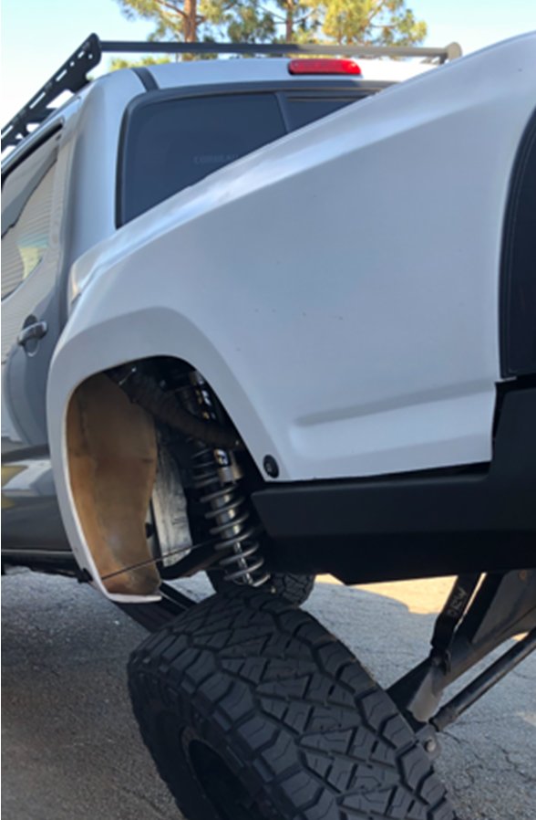

    Agree - I hope he sticks around for Q&A - I enjoy watching the channel. He may not have as much up-travel but I think that rig looks pretty good in the dirt. Also - and this is definitely my ignorance -- seems there is a lot of droop -- so even if it doesn't stuff as high, if it droops lower is the overall articulation going to be the same? Stuff 2" less but drops 2" farther?
    I do have a question about the cab mount. I don't understand the big deal about not chopping or relocating the mount? There is so much welding and other fab going on -- why so much interest in not touching the cab mount? When I went to 35s I was happy to chop it back and hammer the pinch weld and trim some of the fender out of the way - easy and a few less things to worry about.

    It’s not just a couple of inches it’s closer to 6” + and the point that everyone is trying to drive home is that it appears he has less or equal total travel than a truck with stock leaf springs due to all of the design limitations. With links as short as his and the coil over mounted directly to the axle straight up and down best case is that he is getting travel that equals the stroke of the shock. So ie: if he has 14” coil overs he would have 14” ish of travel but he also has those tall bump perches…
