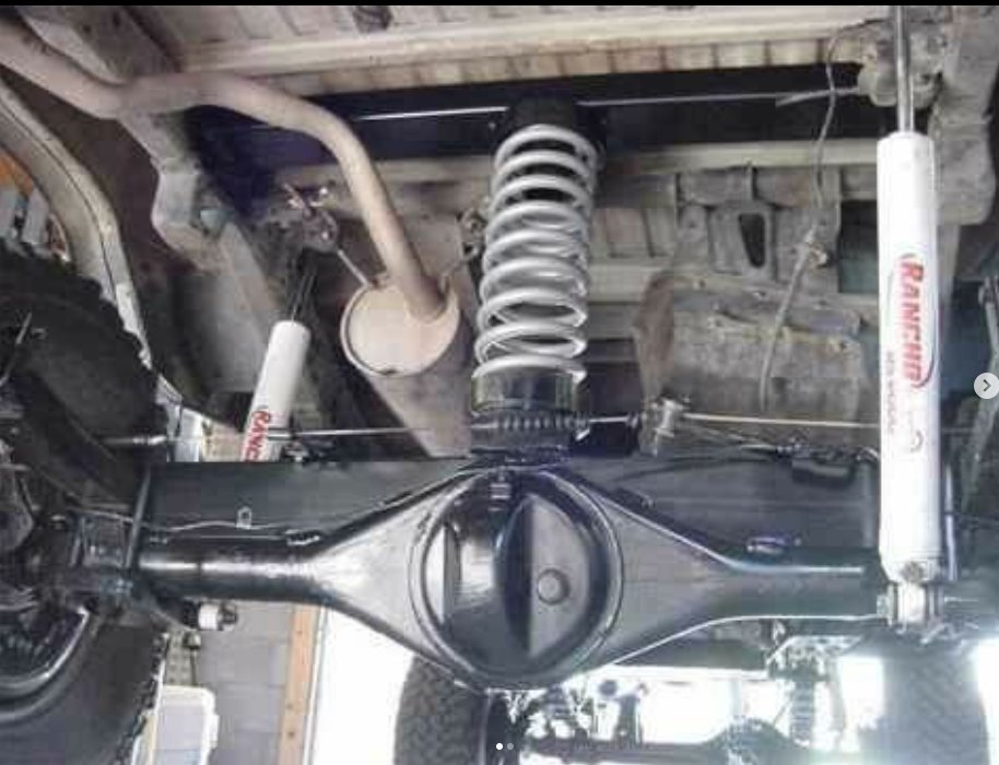

    kinda like running one limit strap in the center. It's still got leafs also on that thing :rofl:
    Where did you find this bit of shear automotive engineering genius it's awesome!
