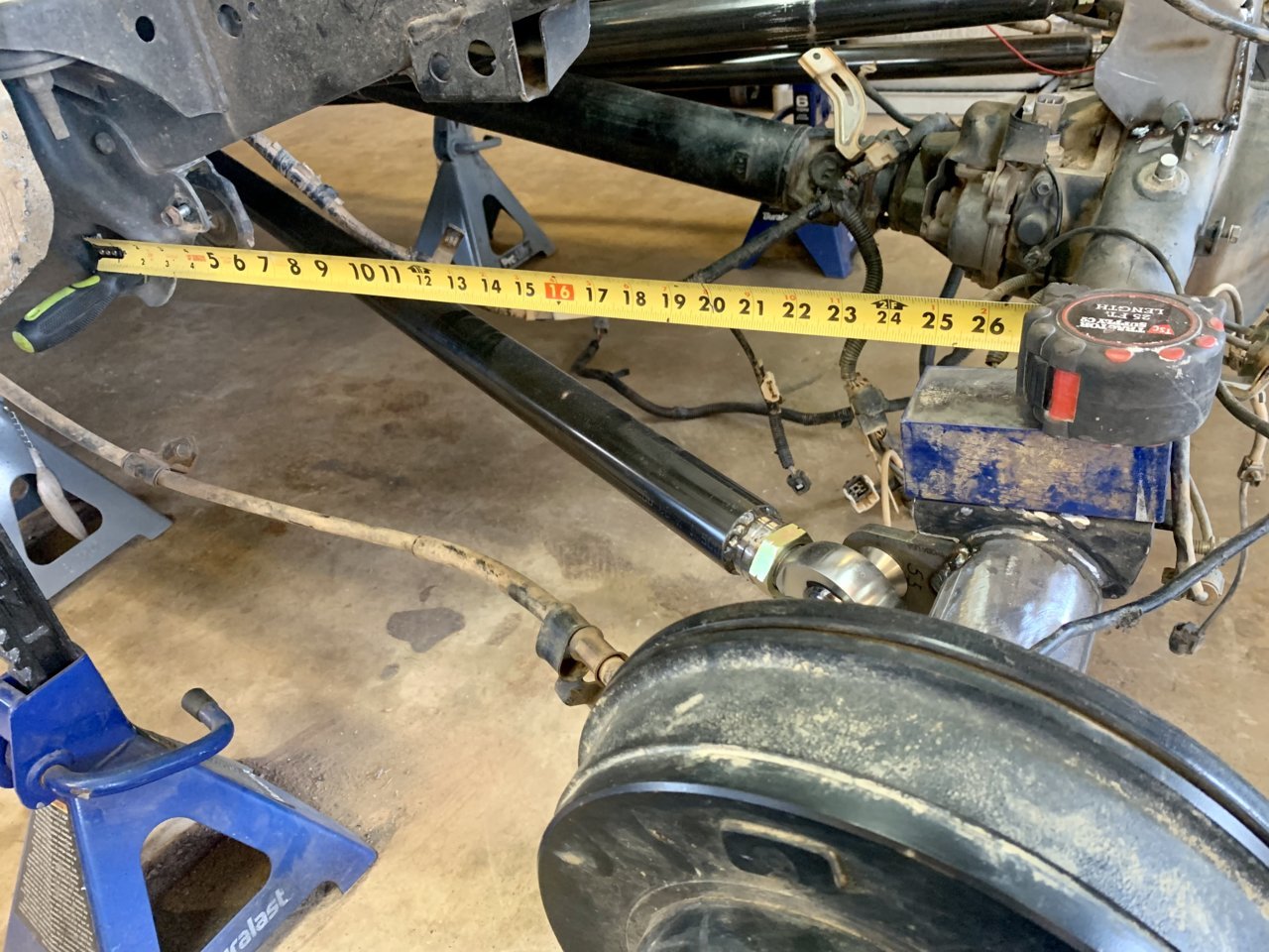

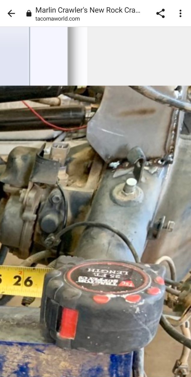

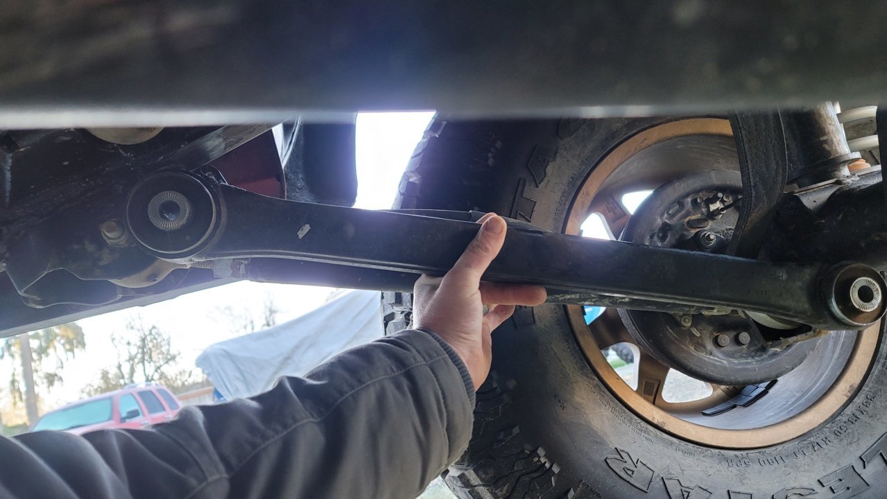

    Nevermind the potential link length, what's up with the welds on the upper link bracket? Yikes!
    Wheel travel is measured differently for crawlers vs prerunners so I'm not at all surprised to see this amount of bickering going on lol. Yeah sure RCLT might have stock travel but its not meant to bomb through the desert, its primary use is crawling where ground clearance and big tires can help a lot when your articulation isn't there. Crawlers can also get away with all sorts of funky suspension geometry because they're used at 1mph or less, not 60mph through the whoops. Apples and oranges

    I’ve got worse welds than that I promise. What I don’t have are 24” links mounted to the factory leaf spring mounts. I don’t see that being good geometry for anyone regardless of application. We will see which fails first, my boogers or rigid links to the factory leaf mounts. Probably a toss up. Maybe mine will be worth fixing if the geometry is good. Suspension travel isn’t measured differently depending on how you use the vehicle. I sure hope the RCLT pulls more travel than stock. If not, what’s the point? 10k for maybe an extra inch of ground clearance over the factory LCA?
    Maybe he is pulling the full 16” out of the rear, but it appears that he has less uptravel than a stock truck due to the tall bump stops. Maybe it’s 3” up and 13” down travel? Who knows. I’m just curious. I don’t have a dog in the RCLT fight luckily.

    Your are close with your welds you just need to give your puddle more time pool up. You aren't welding thin sheet metal so don't be scared to let it cook for a minute before you drag your puddle to start forming your bead. If you have a big gap to fill use a little steel tig rod. You can literally lay it in the gap, zap it with your gun to keep it in place and weld over the entire gap in one pass. It looks like your machine settings aren't to far off you just need to get more hours of experience on your machine to get a good weld. But what you have can easily be fixed by grinding it down smooth, turning up the heat and laying down a fat cover pass over all of it. Make sure you have enough heat to marry your parent materials. Your old weld will essentially act as a heat sink.
    I would clean it really good with acetone and blow it out with an air nozzle a couple time to reduce porosity in your cover pass.
    Anyone can shit on a guy for not have great welds. For some reason very few will offer ways to help him improve his craft.

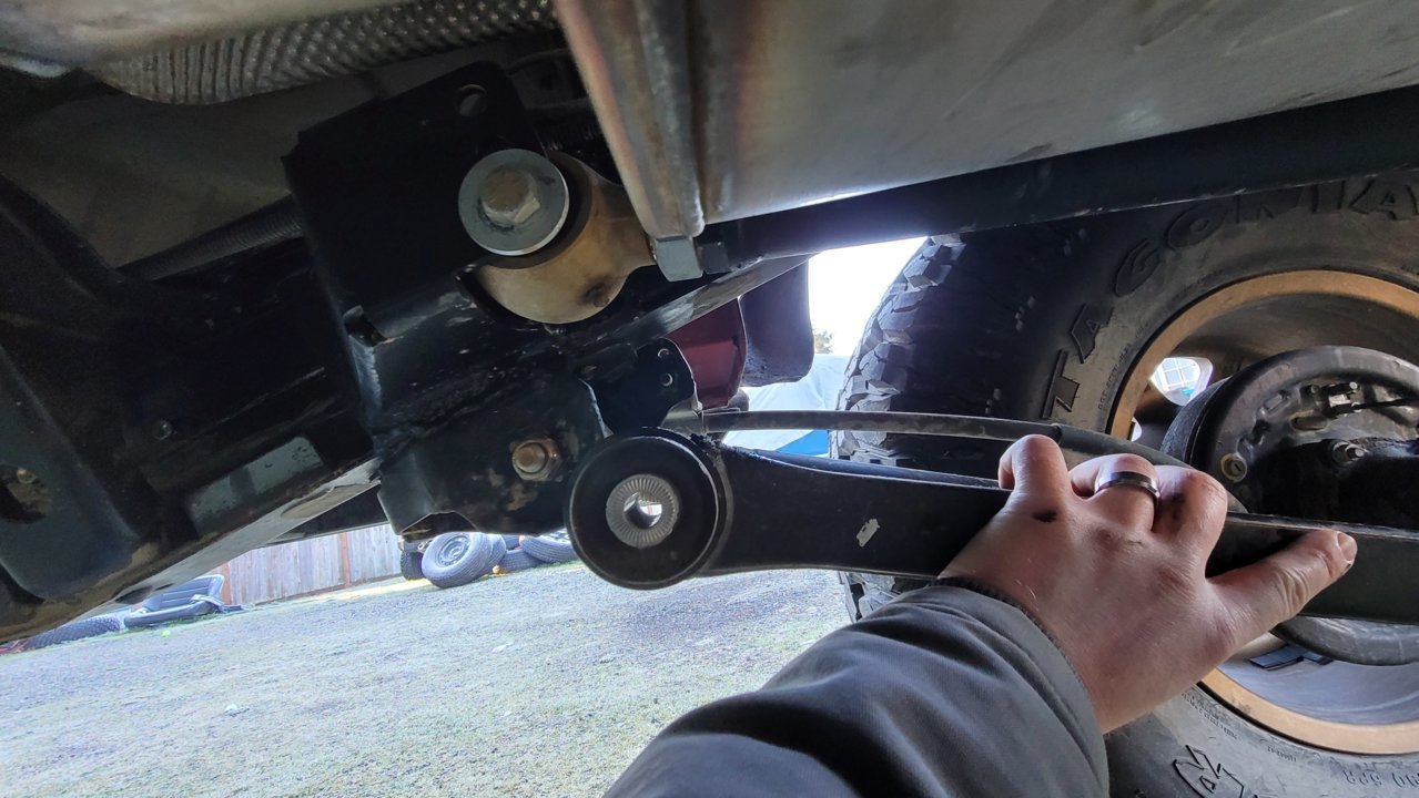

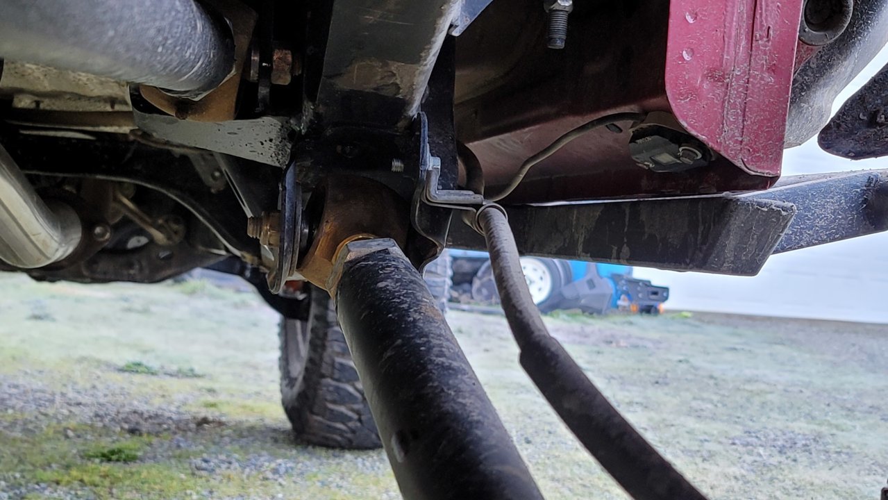

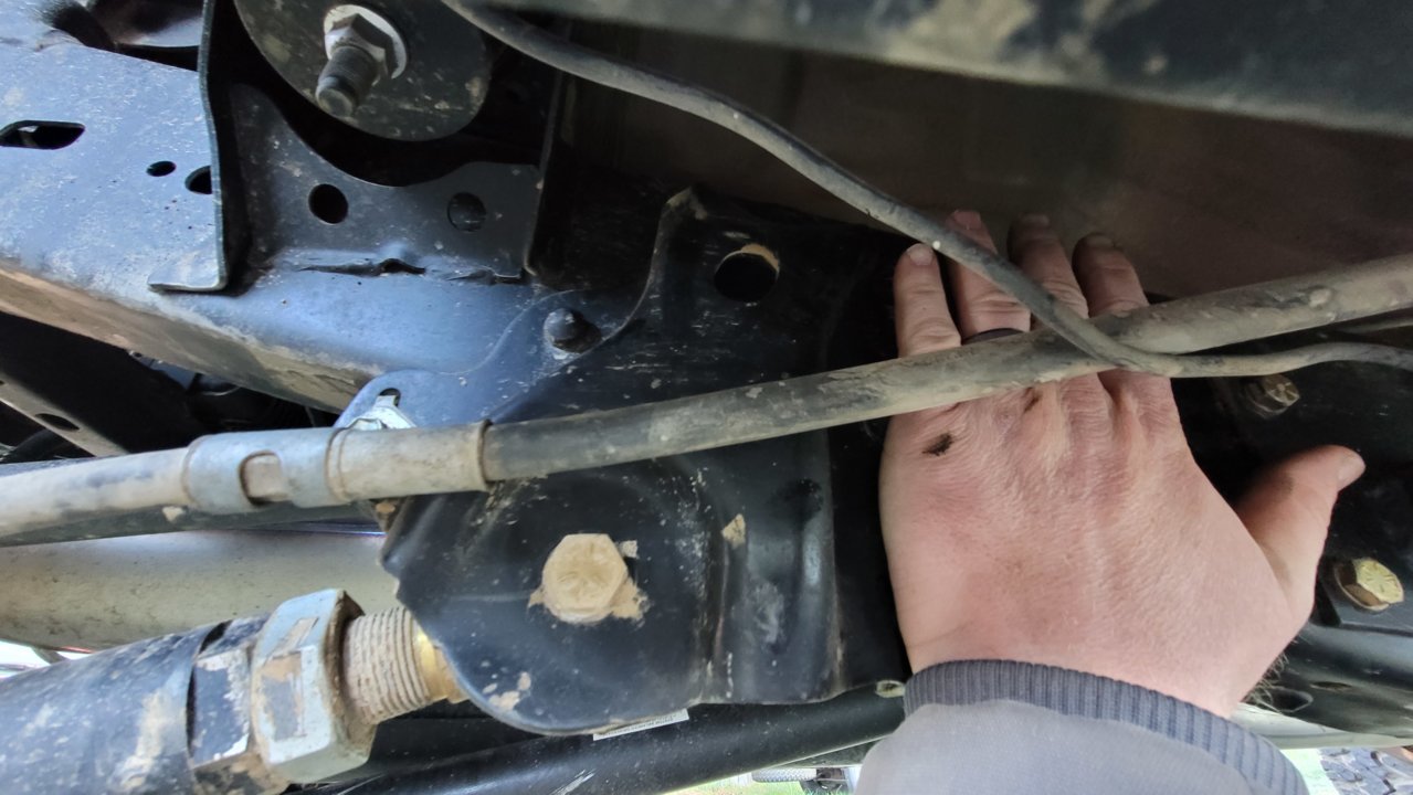

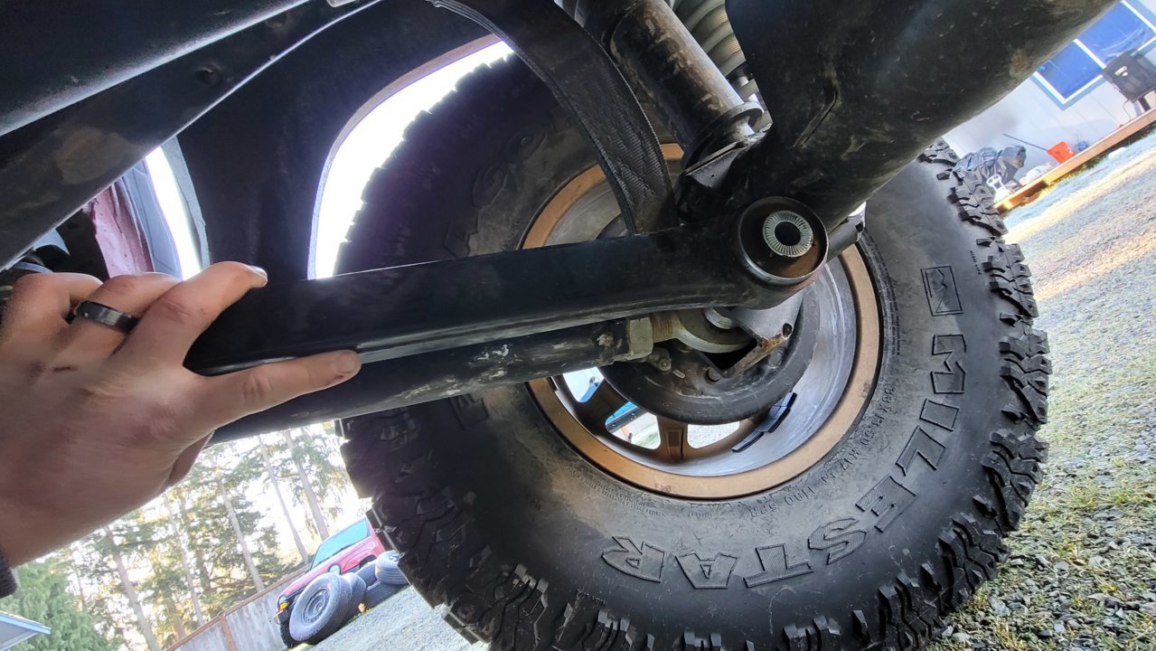

    As for the links.
    Take a look at these pictures.
    "What I don’t have are 24” links mounted to the factory leaf spring mounts. I don’t see that being good geometry for anyone regardless of application."
    Here is just one of many examples of other applications with the same size links.
    These are factory rear lower control arms from my 2021 Jeep gladiator. It's now on a 4 1/2" lift with the same length arms. The only difference is the new arms have more flexible joints and are adjustable. Thousands of gladiators all over the country are on the same size lift, with the same length arms and perform great on and off road.
    Buddy. I'm not your enemy. Stop trying to find things wrong with what I've done when you have so little experience. And I'm not trying to sound insulting at all but you are digging yourself into a hole by trying to make me look bad. And for no reason! I'm a nice guy! I promise! Let's put down our weapons and have a hand shake.
    I have installed "long arm" kits on jeep tjs and xjs with arms that are shorter than these. The length of these arms on my Taco are fine.
    As for the mounts. I understand your skepticism and your questions are very fair. At least they were until the last comment.
    But look at these pictures. This mount is huge and has a great foot print over ALOT of surface area of the frame. I'm testing this as a location because it was just soooo easy to take advantage of and it is super high clearance. Having your LCA mounts hung up on rocks sucks. This is an easy way to make the truck a little more slippery in the rocks if it works. If they rip off you will know. But after using this truck a bunch at Hammers and bombing through the snow yesterday, I have no distortion in the mount what so ever. Time will tell and so will I

    All of these pictures are taken of the stock 2021 lower rear gladiator control arm next to the arms on my 2021 tacoma. I just want to be super clear about what everyone is looking at.
    Enjoy the rest of your weekend folks! I'm heading out to install new suspension and a new engine in my son's RC crawler lol. Try and unplug today and spend a little time with your kiddos if you can
