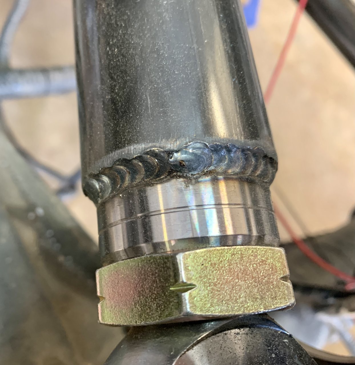

    Nothing wrong with flux core. I did my SAS and Toyota axle flip with one and haven't died yet. Part design matters way more than welding anyway from a strength standpoint. And you are right the thin Toyota frames was a PITA for the 110v flux core machine, 240 would bring the suck. Probably the most used welder in this hobby is a 110v Hobart 140.
    Don't look at any of my most recent welds in my build thread, I'm fighting shitty power in my garage and I'm rusty LOL!!! I was damn near stacking dimes at the end of my sas with the flux core machine, barely any splatter!

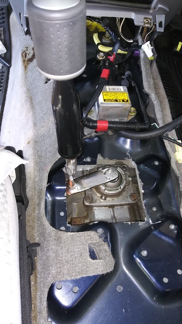

    Nothing more than a few hours of mig practice here, and the beads are getting to be....meh.
    I hadnt fired it up in awhile, and learned about the rust factor here in Florida.
    The .035 had gotten rusty on the spool and was causing the feed to stutter and hang up in the gun.
    I had cut and was doing a repo on the J-shift for a manual tcase swap in the 4Runner.
    Managed to get it done but it was FUGLY.
    Could have cost me a lot to replace that shifter.
    I'll be inspecting the rig more and doing a couple of practice passes before I start on anything important from now on.
    Thank God for flap disks.

    looks good, id bevel that edge to help with undercut. But not bad man!
