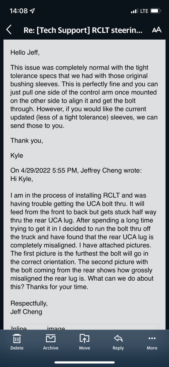

    Tight tolerances my ass. That side is clearly misaligned to the other side. Tight tolerance would be the bolt is hard to slide in either sleeve or the UCA is hard to get into position. That looks like either welded hot and fast without a jig, taken out too early from jig, or the jig was misaligned. Sounds like they are trying to punt and avoid the actual truth of the matter.

    My thoughts too. Who cares about the sleeve tolerance, its the cup that's off.

    By no means am I trying to defend anyone. It is interesting to see the difference in what one thinks is tight tolerances or what a precise fit is. Having the opportunity to visit a number of Nascar shops about a decade ago as a supplier and being shown well beyond what the average person gets to see. One particular team shared what the tolerance was for their crank stroke lengths. From the shortest to longest across all four was (0.00005")
