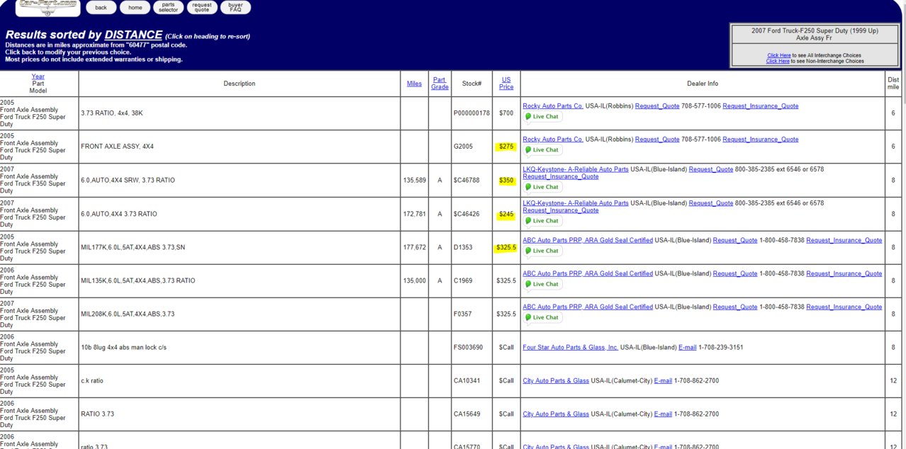

    Front SD 60's are $250-$350 all day by me. A solid axle swap is all about being patient, finding deals and doing the work yourself. Those three things can result in a very affordable SAS.

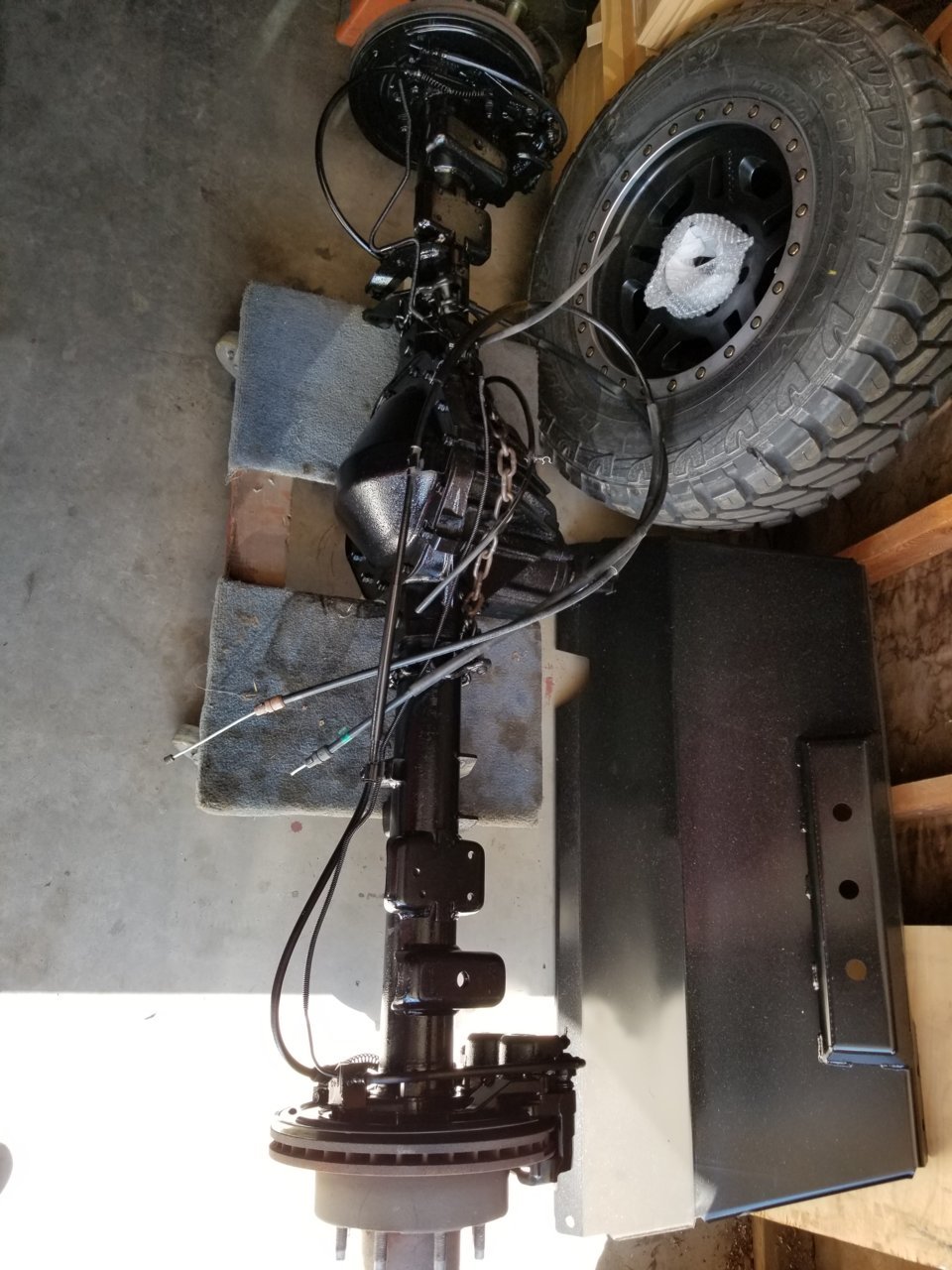

    Agreed, I have done a few SAS. Right now doing one to a 97 Suburban and just picked this up for $500 bucks. Hunting for a front axle now. Going big on this build. Going to run some 40s.
