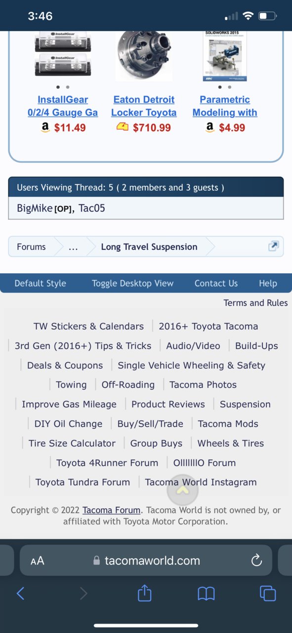

    It is interesting to me though... at the bottom of the page is the list of who is viewing the thread. BigMike was viewing when I posted my last comment and for a while after as well but he isn't commenting. Why not? I started watching this thread because of the struggle I've had with Marlin's business practices and not for the RCLT content. This thread has given me more questions rather than answers.
