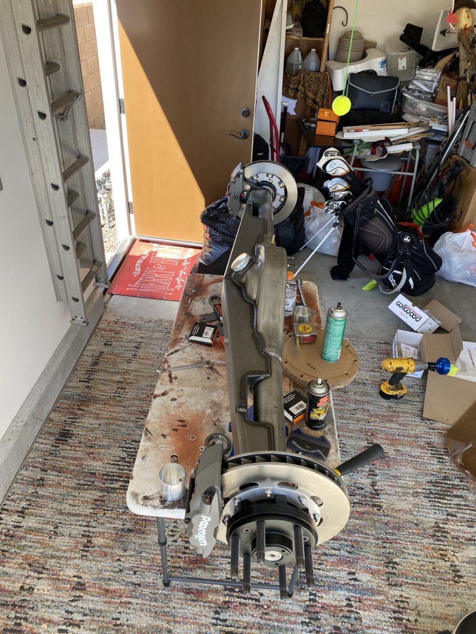

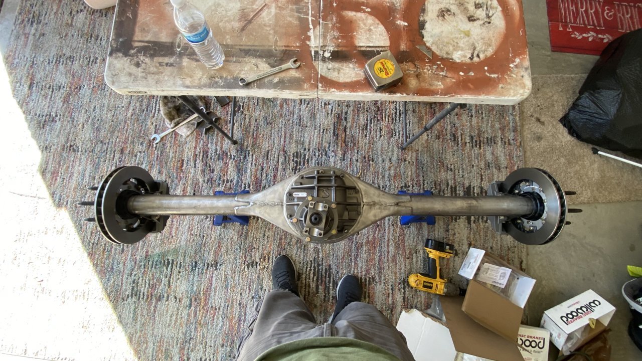

    https://www.tacomaworld.com/threads/airdogs-2012-prerunner-access-cab-slow-build.264263/
    Pretty sure this would work. I just got this from JDFab. Installing it this weekend.

    @Airdog nice nice; very shiny :drool: . Going linked with that or sticking with leaves? also, do those calipers have e-brakes or whatcha thinking for that? edit. nm. I see the spring perches in the photos. purdy welds on that housing.

    ford 9"? Or what is your 3rd? It looks like a regular tacoma axle but that 3rd member looks neat.

    Ford 9. Full float. 70 inches wide. Housing is a speedway engineering Grand National housing with a JDFab custom truss and larger filler inspection port. Axles are a touch bigger than stock6214E507-3579-4130-9027-549DD9194707.jpg
