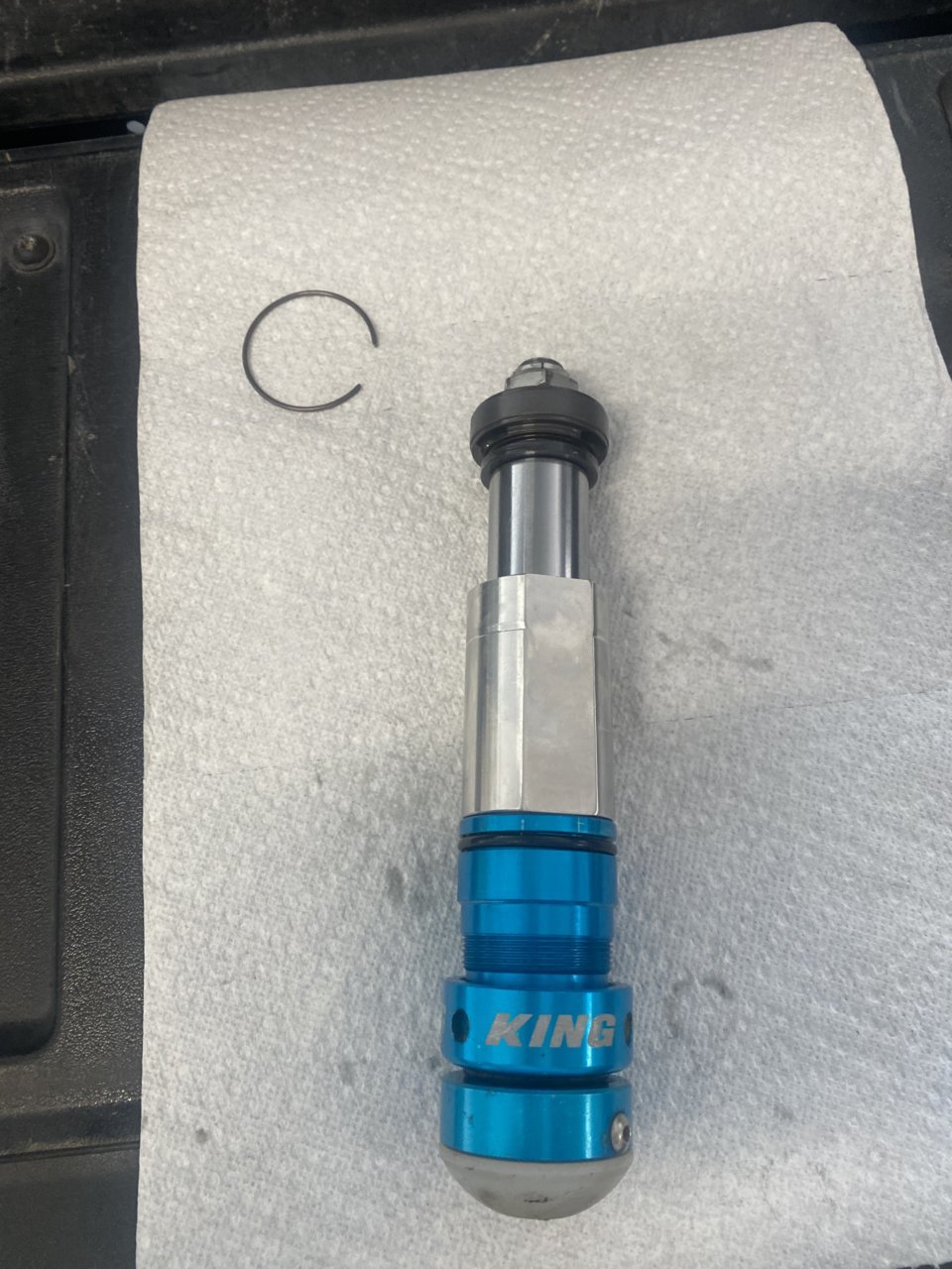

    Regardless of what they say there is nothing stopping you from doing it. If you are willing to take the time to tune it properly you can alleviate that issue. But your standard customer does not usually have the knowledge or the know how to do it. Take me for example....I had 4 inch bumps on my DMZ setup....didnt like how quickly I would get into the bumps and the resulting quick rebound that didnt actually buck but was in the ballpark....so I made spacers to shorten them up to 2 inch bumps and lowered the pressure in the hydro bumps and messed with the rebound tube on the bypass and made it much better. More people than not dont have the tools or capability to do that.

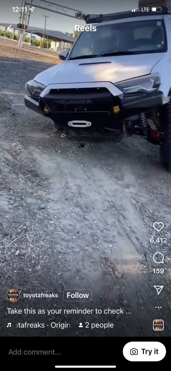

    My rig? Mine is all good, just ran a few trails over the weekend actually. You talking about @amg_t4r? He broke the stub shaft and add housing on a trail. Then looks like he drove it without the front PS axle and the bearing backed out and wheel fell off. The outer cv and axle nut keep the bearing in place. I keep a set of inner/outer CV stubs with me, no axle shaft, just the stubs.

    Not sure why everyone on IG is slamming RCLT for this one. He broke factory components (add tube and stub shaft) bc RCLT is beef and moves the weakness to the few factory components remaining up front. Also, this guy wheels the crap out of his 4runner so it's got some wear and tear on it. Driving it around with no PS CV axle, and therefore nothing holding the bearing in place, wasn't the best idea. This scenario makes a strong case for keeping the CVs as the weak point and/or keeping it to 37s.
