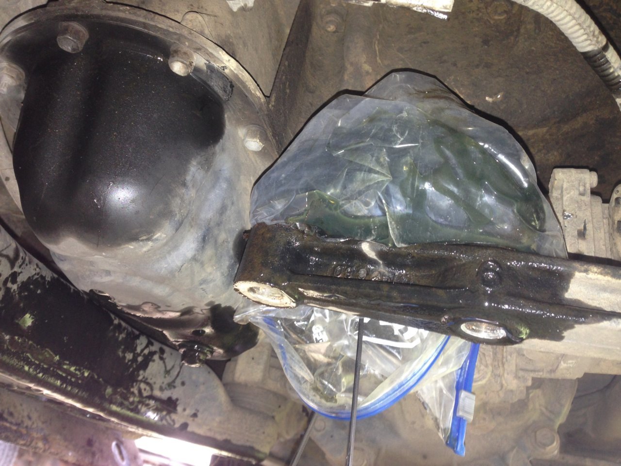

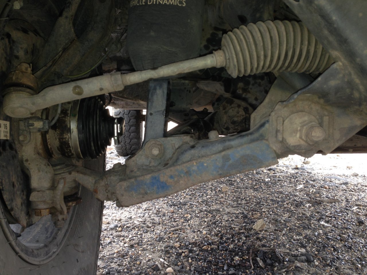

    I ended up having to cut mine when I busted up the ADD housing years ago. Wrapped the diff in zip lock back and zip ties to keep the fluid in, and created my "stub shaft emergency kit" LOL
