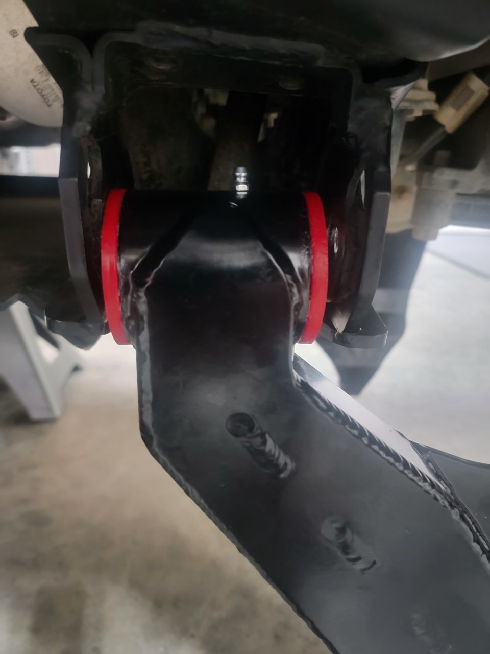

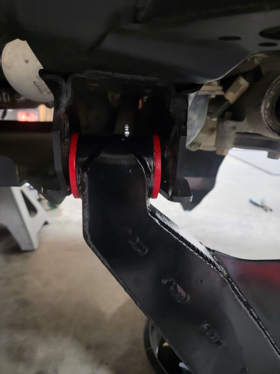

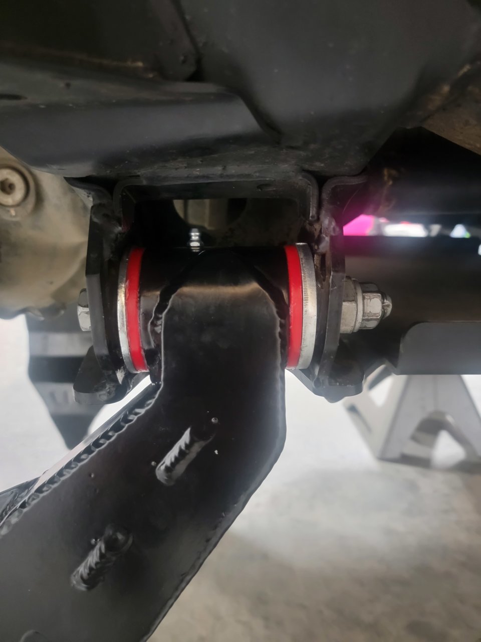

    Has anybody seen this? I can't see how my LCA pockets would be off (driver side lined up). Marlins gusset kit was installed prior to rclt. Had DK LCA's with no issues.

    Compare the width of both lower arms and make sure it isn’t an arm issue. Someone else had an issue with an upper arm.

    For comparison. Appears there is some discrepancies on what is center or offset. Just noticed this after pulling measurements. Will be contacting Marlin tomorrow

    Can anybody confirm the location of their passenger side rear LCA pocket? Replacement from Marlin is exactly the same. Same fitment issues..

    What washer stacks are you using on the other side of the LCA (the side of the problem LCA that is not pictured)? What measurements do you need? I'm planning to pull my skid plates off this week and I can measure the distance between the LCA mounting points.

    Washer stacks are same thickness on front cam (which are the most thin washers supplied). I basically need to know the location of the pivot point where it is welded to the LCA towards rear of truck. Whether it is centered or offset slightly. This makes 1/8" difference between the pass/Driver arms.
    Driver side:
    Passenger side: centered

    I found a pic from my install and it’s offset to the rear on the pass side. I’ll check them tomorrow.
