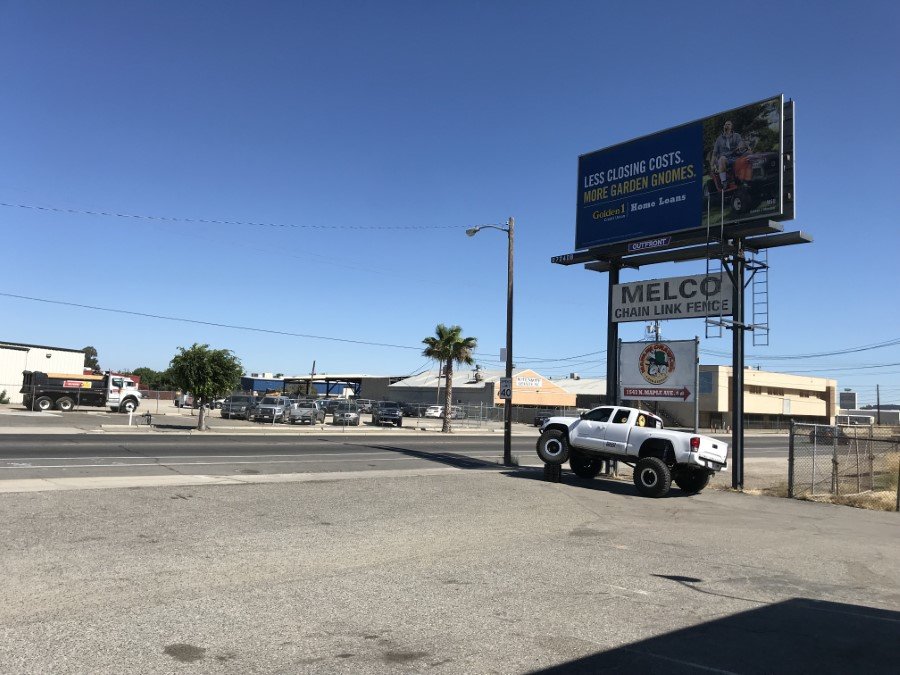

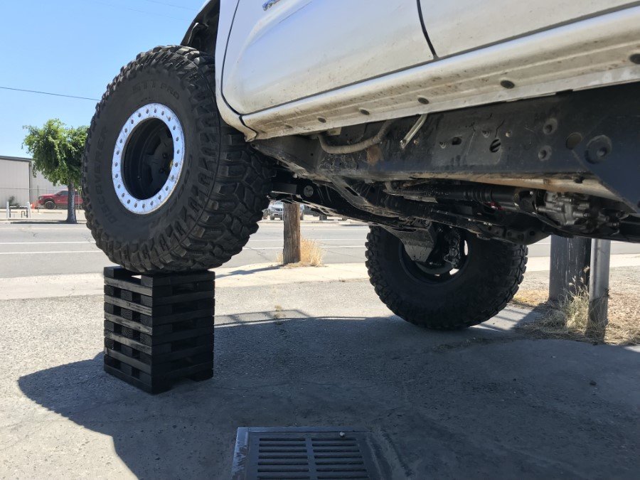

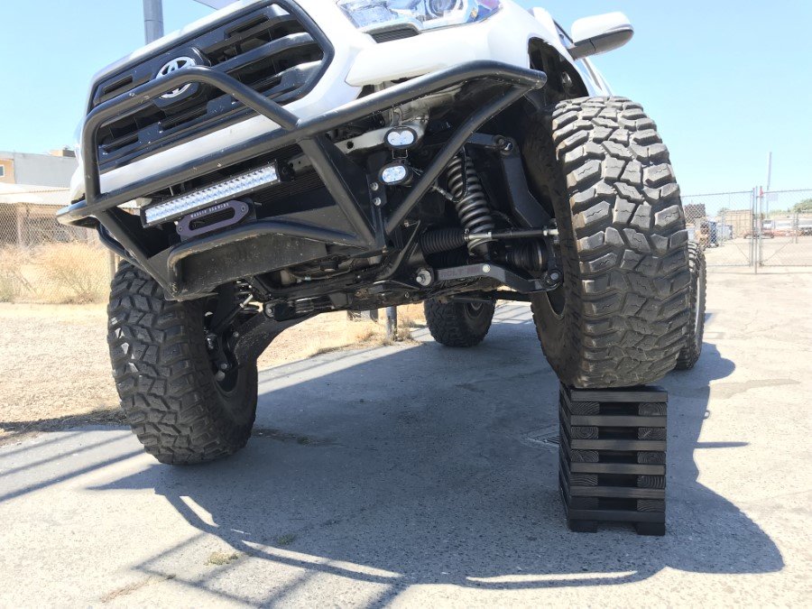

    Decided I can't leave the thread without some new pictures.
    We made a simple wooden display stand to show off RCLT HD in our parking lot. We have a main stand which is 19" tall (could be taller) and an intermediate stand which is 12" tall (which is removed once up).
    I'll have to take a video of how easy the TacoBox makes it climbing up and back down. I don't even need the intermediate stand to back down; Just shift into reverse and let the truck idle down incredibly slow without any brakes thanks to my 494:1 reverse gear ratio ;)

    It should fit already, as well as clear the steering despite moving the axle forward so far. The space concern would be with maximum down travel.
    Down travel is limited in order by:
    1. Inner CV joint -- Only remedy is diff drop
    2. Tie Rod End -- Easy to fix by adding a larger offset angle in the CNC billet steering (I am already considering this)
    3. MarRack Inner Tie Rod -- I already have plans to improve this in case someone with a Prerunner wants to run RCLT HD
    4. Finally, Upper Control Arm interference with Coil Spring outer diameter.
    Would you mind measuring the OD of your coils? Thanks
