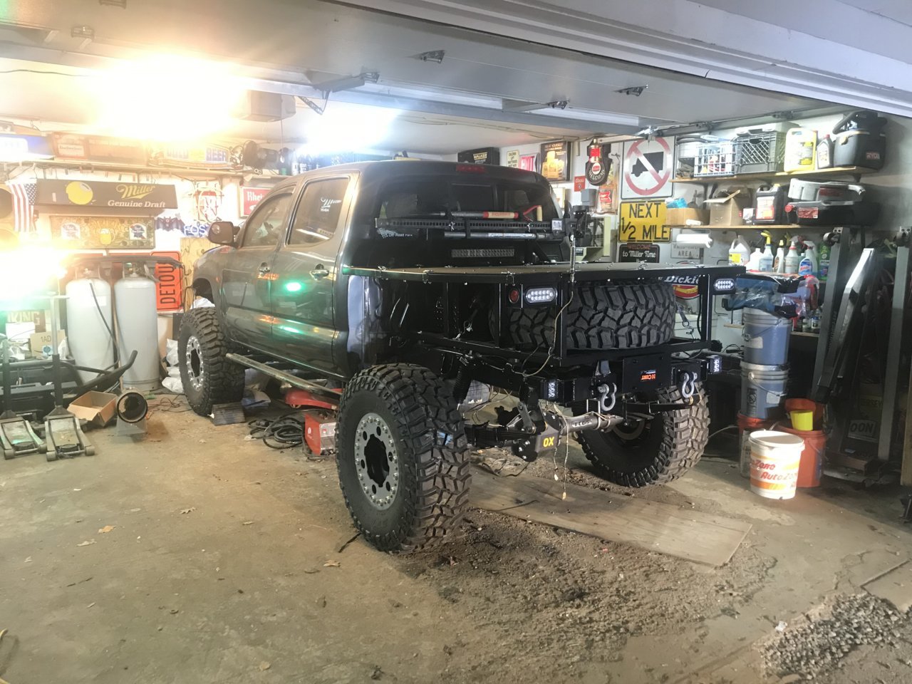

    I am going 37s on stock width and 95% of my wheeling is rock crawling.
    I already have spindle gussets. I have stock length RCVs on order as well. I already did the cab mount relocate etc.
    I love the design of your entire kit, but TBH, it will be some time before I can afford it. I know you haven’t posted a price yet, but fabbed spindles and UCA & LCAs is obviously going to be very expensive.
    Add to that the premium you will be able to charge, being that it’ll be the only kit like this on the market, AND it’s being sold by a very reputable shop.
    I just did an ECGS built Dana 60 in the rear of my truck, 37s, weld on beadlocks, etc. As you know, that was expensive...
    I still have money set aside to upgrade the steering. I’ve just been waiting on your MarRack to be released. If it WILL work with stock width, I’ll keep waiting.
    I think you would sell a lot of MarRacks to guys who can’t afford, or just don’t want to spend the coin, on your entire setup.
    The only other option out there, that I know of, is a modded Tundra rack. I JUST learned the other day, that even those, still use Tacoma Tie rods. I obviously do not want to go that route.
    My truck was heading, most likely, to an eventual SAS. I could see myself, at some point, going with your full HD kit now though. It really is quite impressive.
    And, my truck has never been to a mall.
