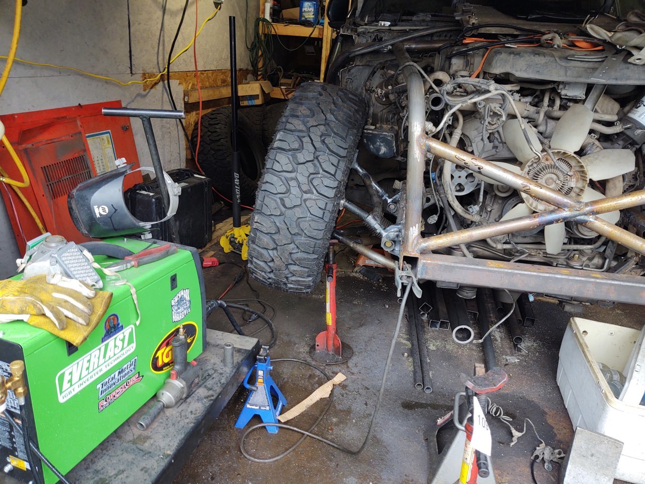

    @81Trekker does that picture of a "stuffed" 40 look a little off? The hub is roughly even with the rocker panel/frame.

    Not a super great angle but this is mine stuffed at metal to metal on upper uniball and hub is about even with rocker/frame. Granted, you’d expect more out of a vertical uniball but we shall see.

    There is more uptravel to be had but the bigger issue that tire won’t turn stuffed like that. A 40” tire at 2” forward will be into the back of the headlight

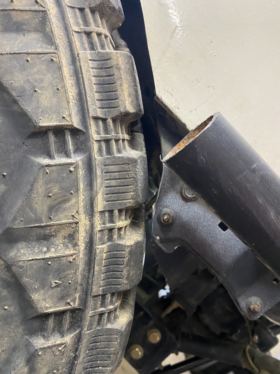

    Do you know how much shock shaft is left when your uniballs max out?

    On my kit I had 1.375” of usable shaft left. That was with the 3/8” thick coil seat on it. But, that also put my 315 right up near the inner fender so any higher and I would really have to cut away. I’d already done some some minor tubbing at the rear of the firewall and up near the headlight, which was still necessary. So many variables at play which is why I look forward to see you cycle yours.

    Exactly, with a vertical uniball and custom spindle I expected something like this, enough up travel to drag the belly on the ground. That's a 34", btw.
