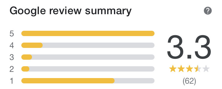

    Legit doesn’t explain all the one star reviews. Once again 1st gen and older yota guys have been saying your experience is better than average if you receive your product you ordered. They promise a lot and deliver much less on a pretty regular basis.

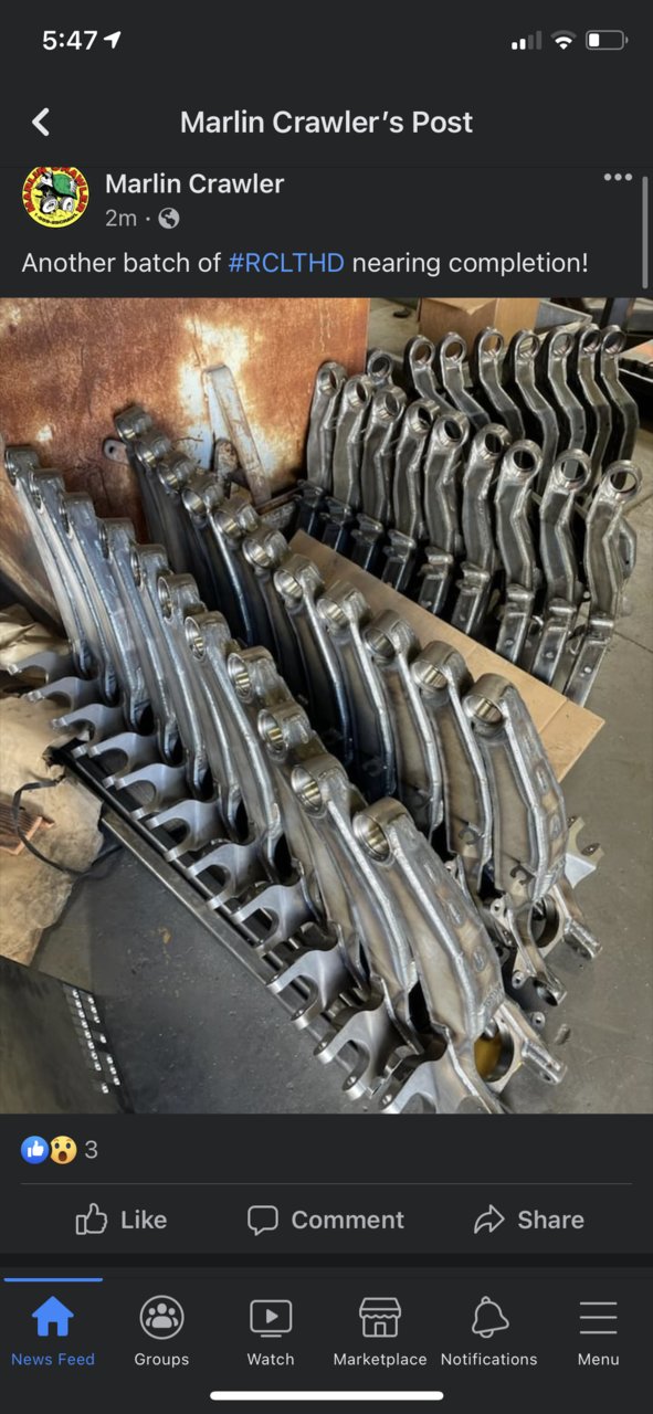

    If it weren’t for this thread I would think that marlin was shipping these kits out left and right.

    That looks like the entire first batch of 20. Here I am waiting for mine. Ordered Feb 19th.
