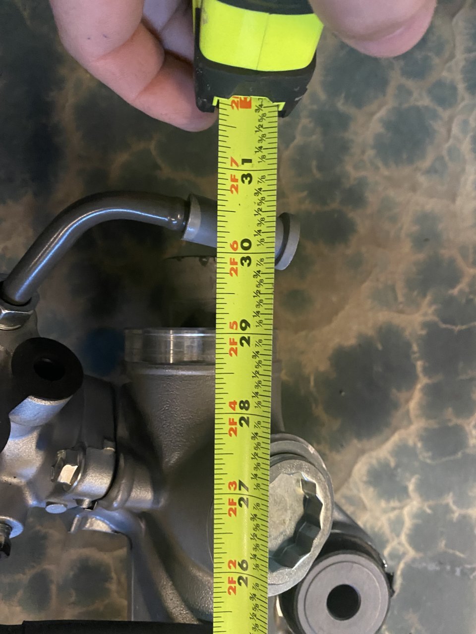

    @RokMgmt do you have a measurement on the LC200 rack from ITRE mount faces?

    Ha, no, looking at the rack by itself instead of the Tundra one that most do. Do you have that measurement?

    That would be great, I meant from between the inner tie rods on the rack, the width of the rack without the tie rods on.

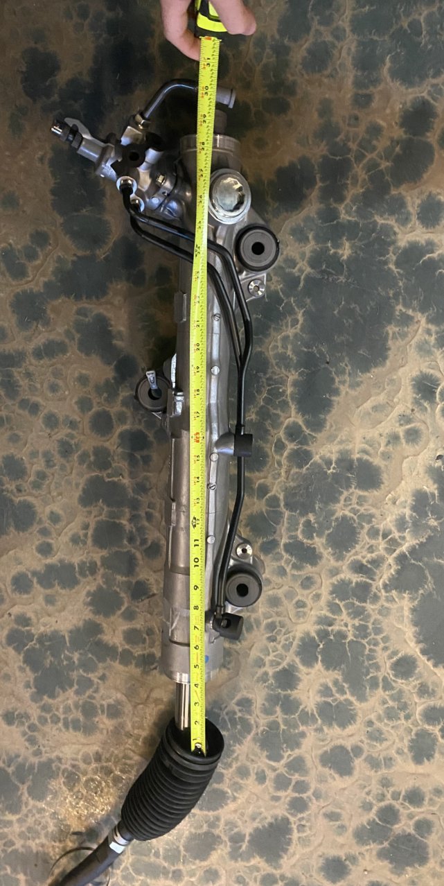

    LC200 rack inner inner tie rod mounting surfaces are about 29-7/8” wide

    Killer, thank you!

    Good deal. I couldnt measure it that accurately when installed.
