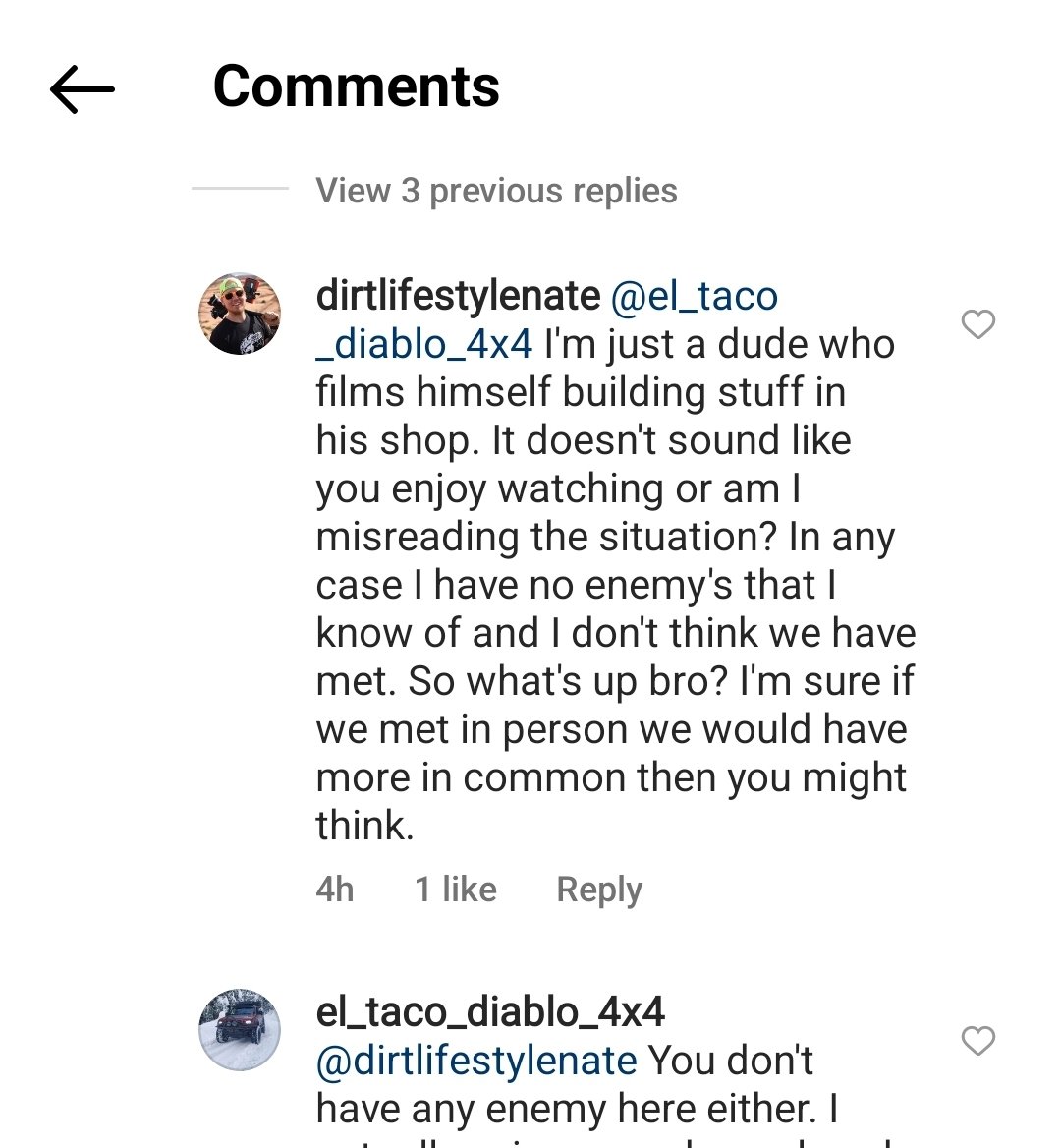

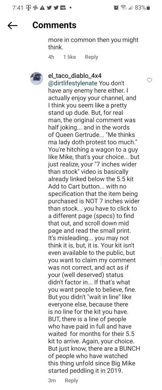

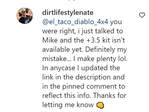

    Well... Nate seems like a stand up dude. According to him, he has contacted Mike about the kits.
    Nate is making the necessary changes to his description. We'll see if Mike does the same. As of the time I am posting this, he has not.
    But at the end of the day. I think this is a good thing. I like Nate, and his channel. It looks like I don't need to lose any respect for him. I don't begrudge his opportunity with the kit. I believe he's capable and will, in fact, probably provide a lot of valuable information on the kit over the course of his series.
