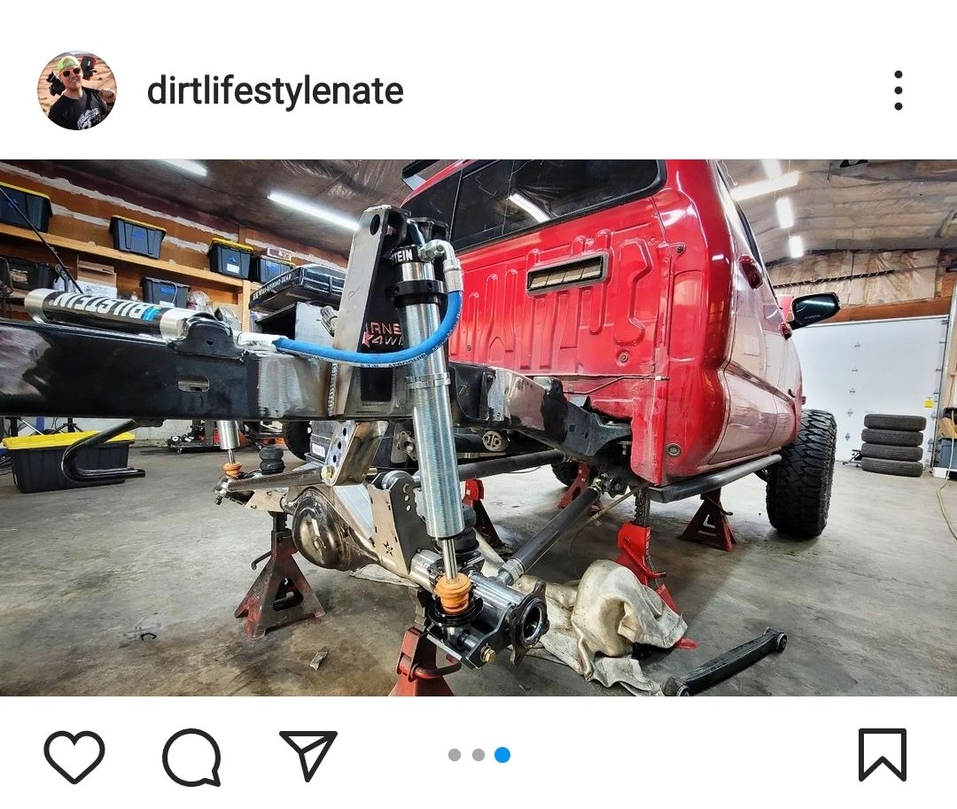

    This will be the first thing to fail in my opinion. Toyota factory panhard mounts are wrapped around the bottom and side of the frame and tied into a crossmember. I've seen two setup like this fail because the force wasn't distributed enough. Boxing in the frame and plating it would have been a good idea, and not much cost in time or materials.

    Agreed, doesn't look like that panhard is gonna clear the diff either. I had to come pretty far into my frame with the towers to clear the coilovers. I had to go back in a few times after tacking and cycling everything. Was a pain in the ass.

    Same here. And that's exactly how mine is setup. I haven't experienced any binding, and after watching hours of GoPro footage of my rear setup doing its thing I can say that it moves well and doesn't bind. I only have about 6k miles on the new setup tho, so jury is still out on if the joints wear out faster.

    I dont see how these shocks are going to clear the bed sides. Maybe it is just the angle / perspective.
