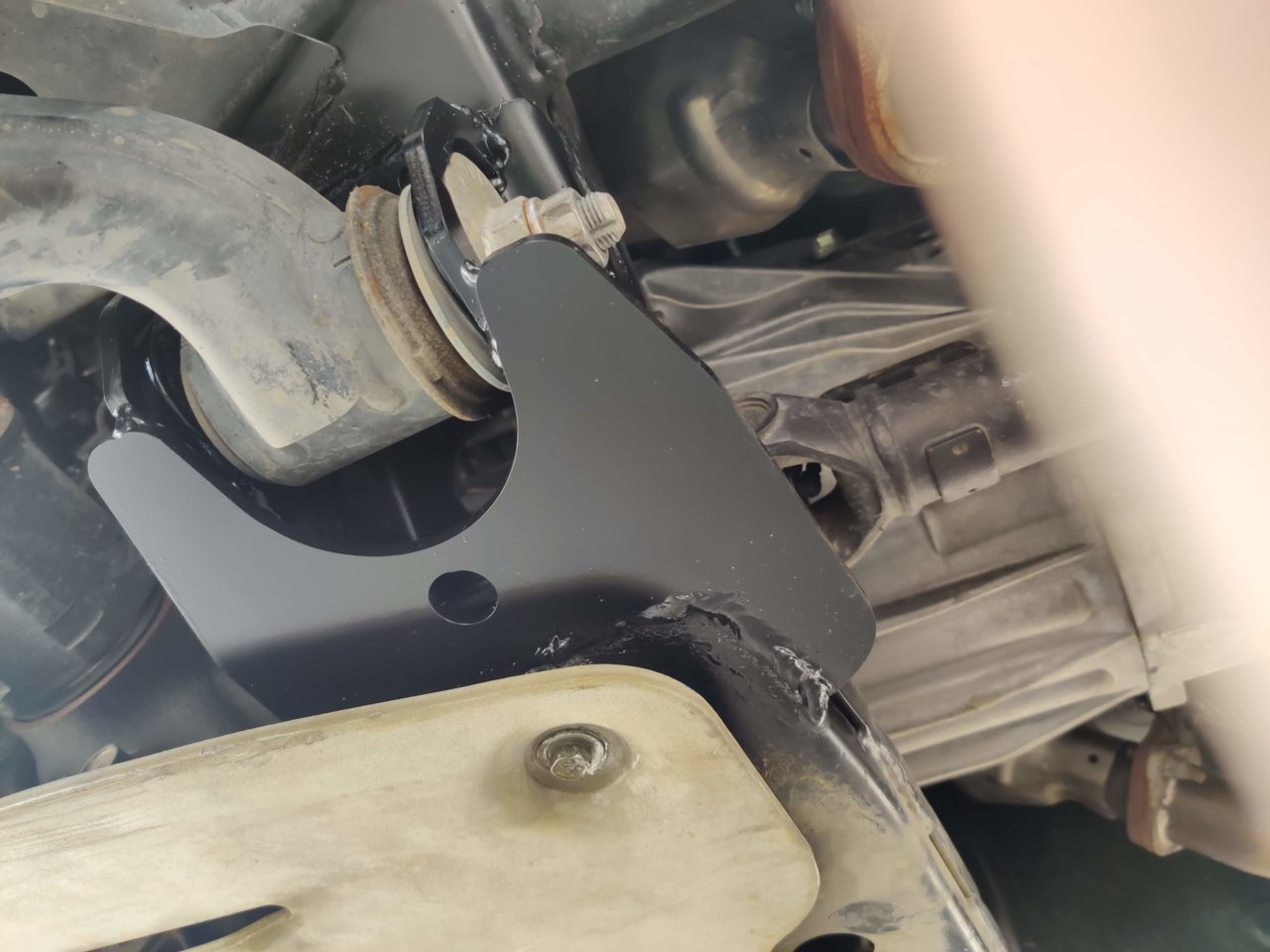

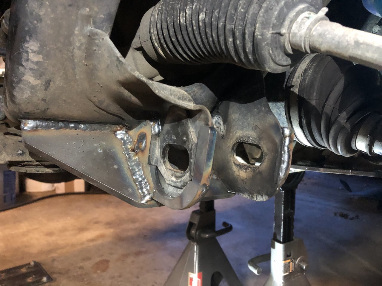

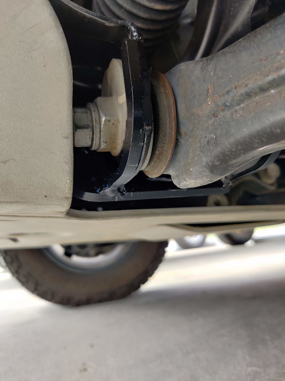

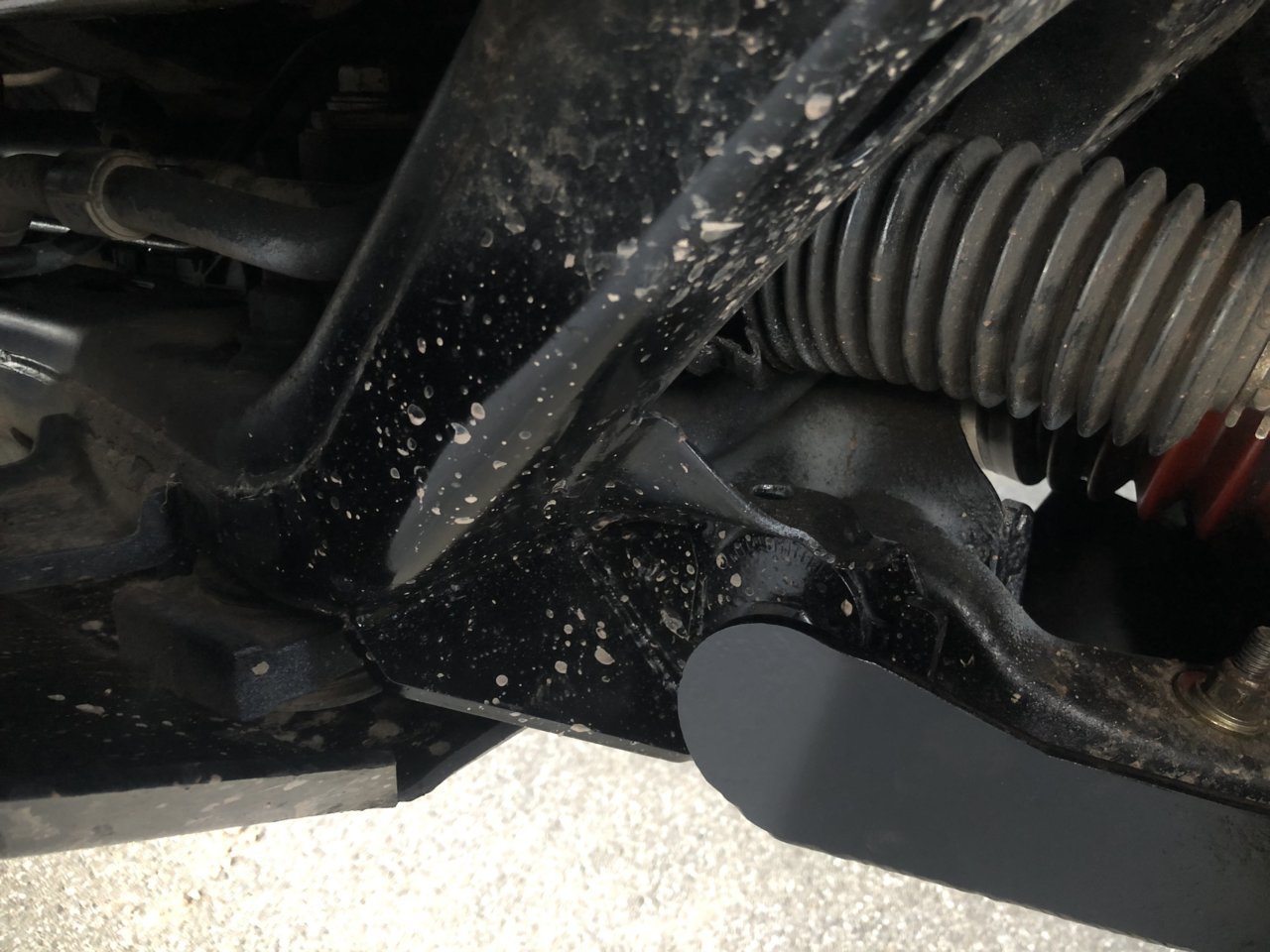

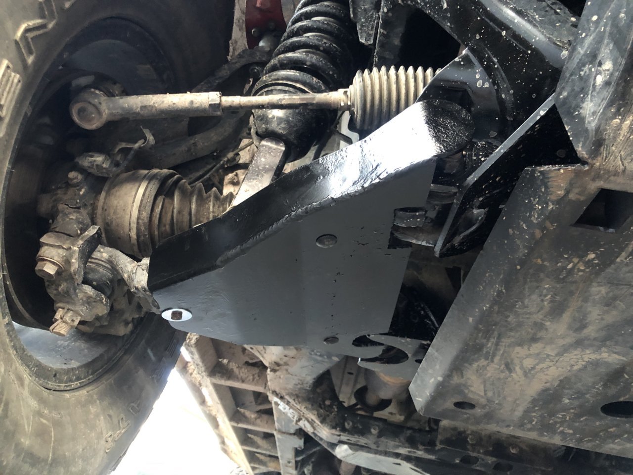

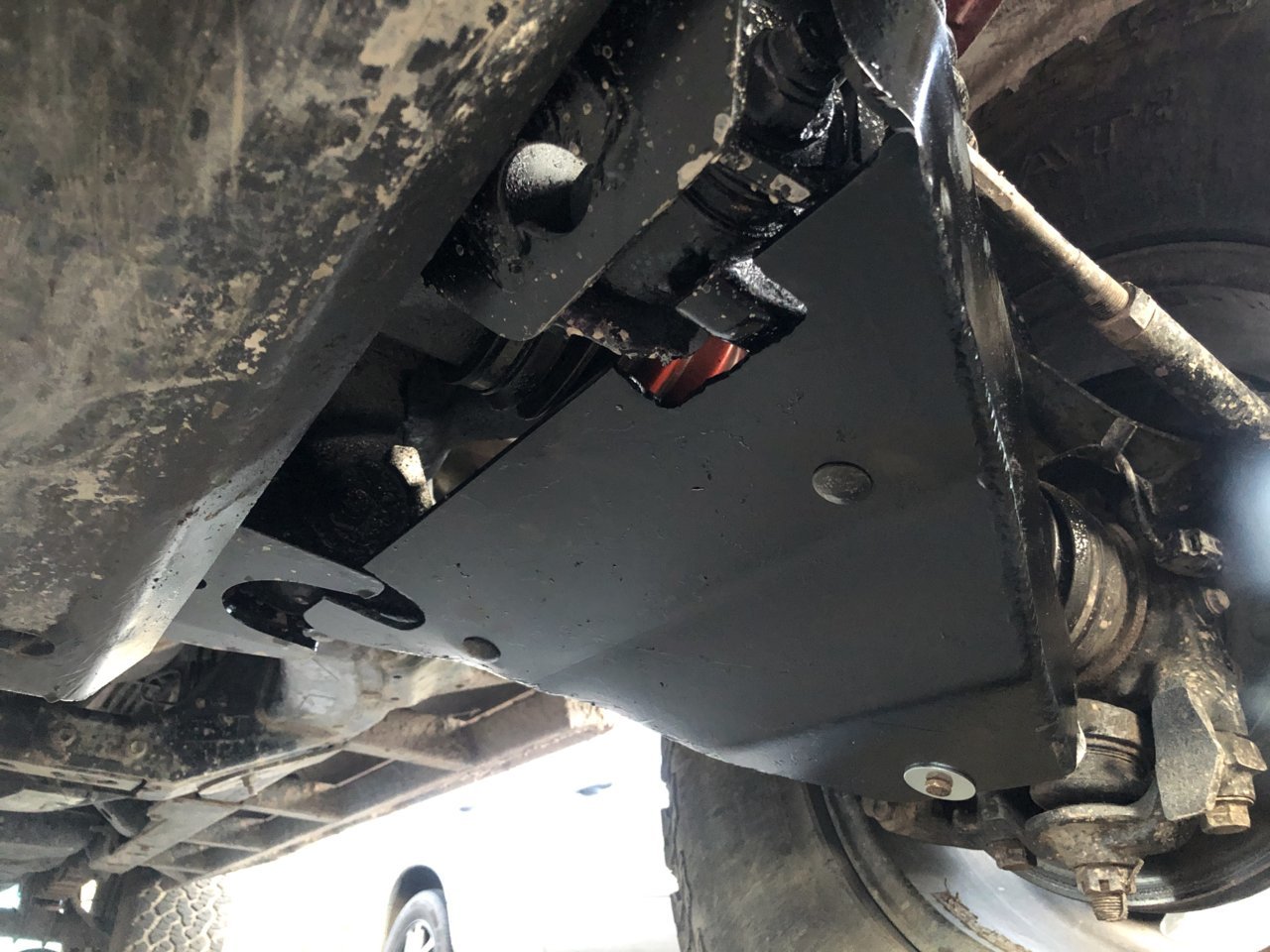

    aaaand here we are, HD style. thank you!!!
    IMG_20190823_112734.jpg IMG_20190823_112747.jpg IMG_20190823_112800.jpg IMG_20190823_112808.jpg
    Joey at Tandem did the install, his first of this kit, and he nailed it. Good work and thank you, Joey!
    you know, i can feel this upgrade on tarmac. i have my truck setup like a big kart for on-road fun and tossability, and i have the firmest E range tires i could find for my setup, so the front end is sharp. but it has always had a tick of slop with the steering as the front end flex eats the details. but no longer, i had a good chunk more steering response and feedback. very happy with this, thank you @BigMike!

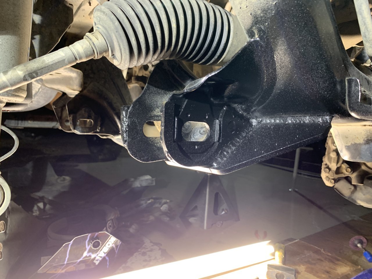

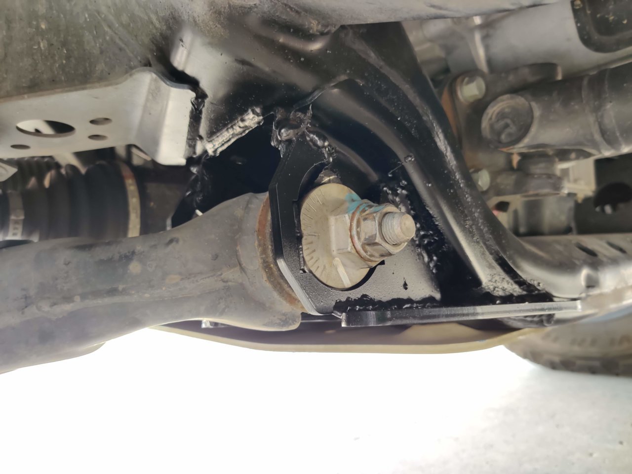

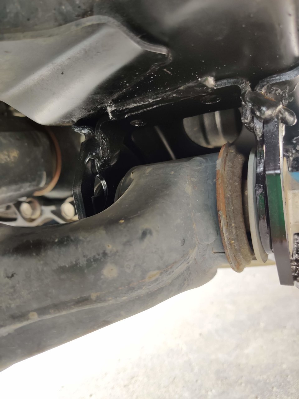

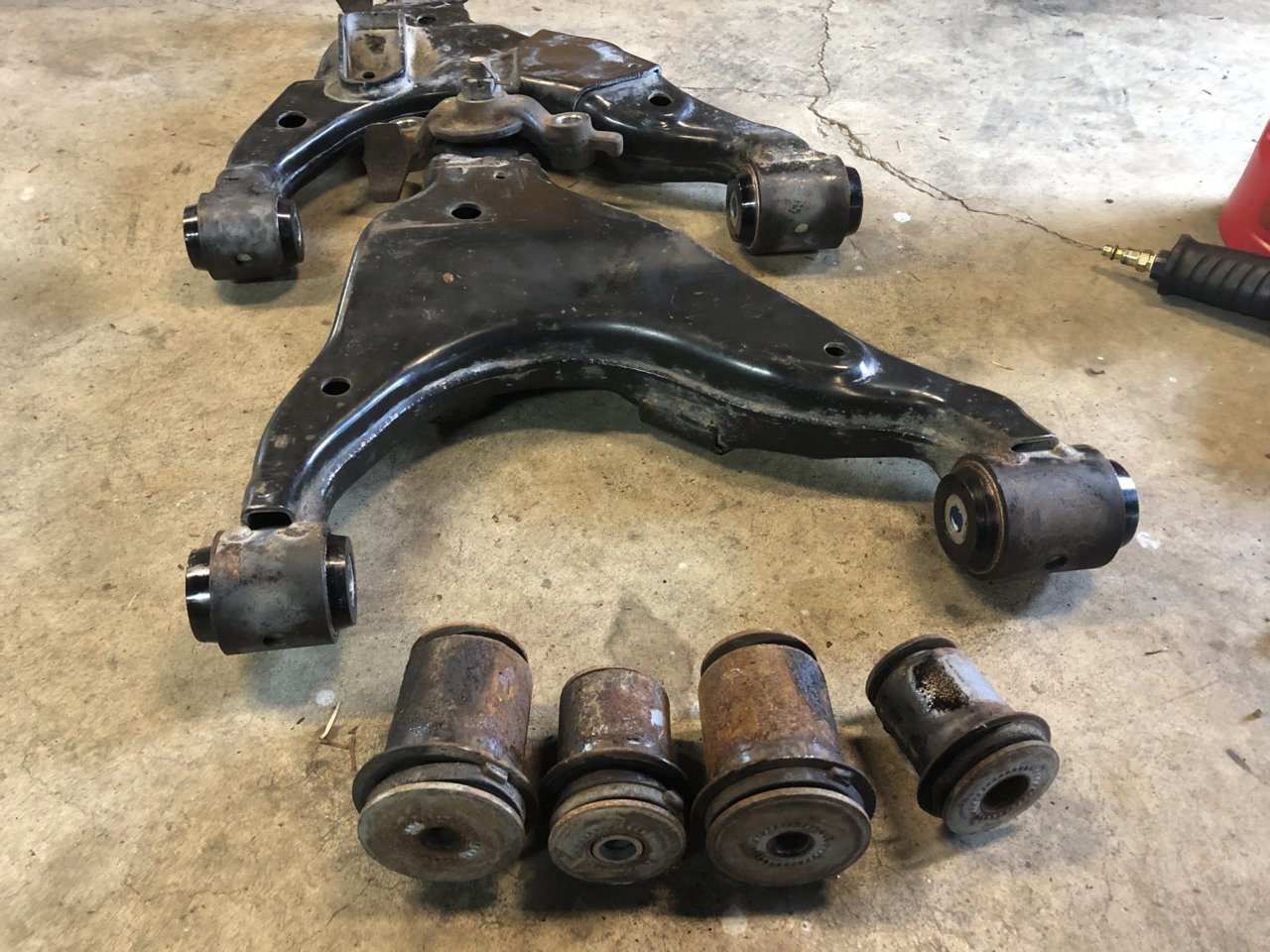

    About halfway done...
    Another happy customer! My installers @JimSnell first kit. He was very happy with the fitment. We did fully remove the LCA because we were changing out bushings. This also allows you to add quite a few more beads that you could not do with LCA in the way.
    Only change we would add is to tack all parts into place while LCAs are still mounted. We tackled the bushings first then the braces. When reinstalling the LCA we noticed very slight changes probably because the welding/heat pull things around. ADC33690-BBB6-41FB-8E0D-0826372566FD.jpg1750E0EC-9DE4-4919-A566-699A55C7EF87.jpg162EDEAD-C0E7-40B9-A241-351B19B21668.jpgB8ED494F-41B6-49BC-96DE-87DAB47676FB.jpg

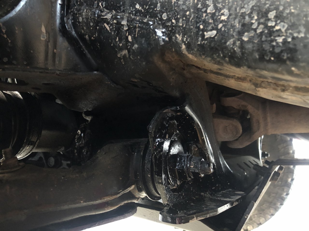

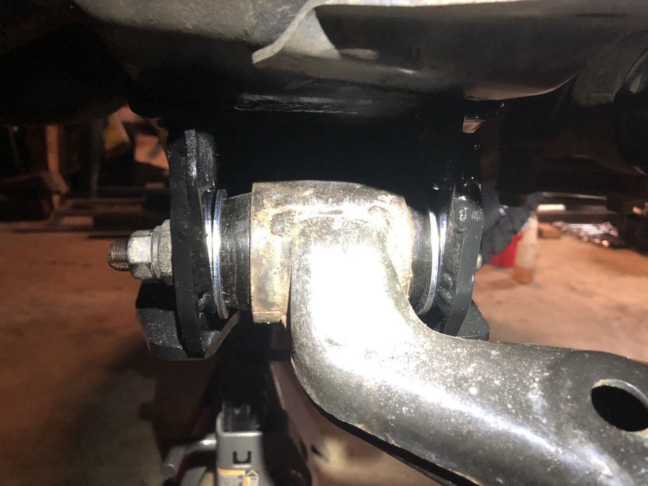

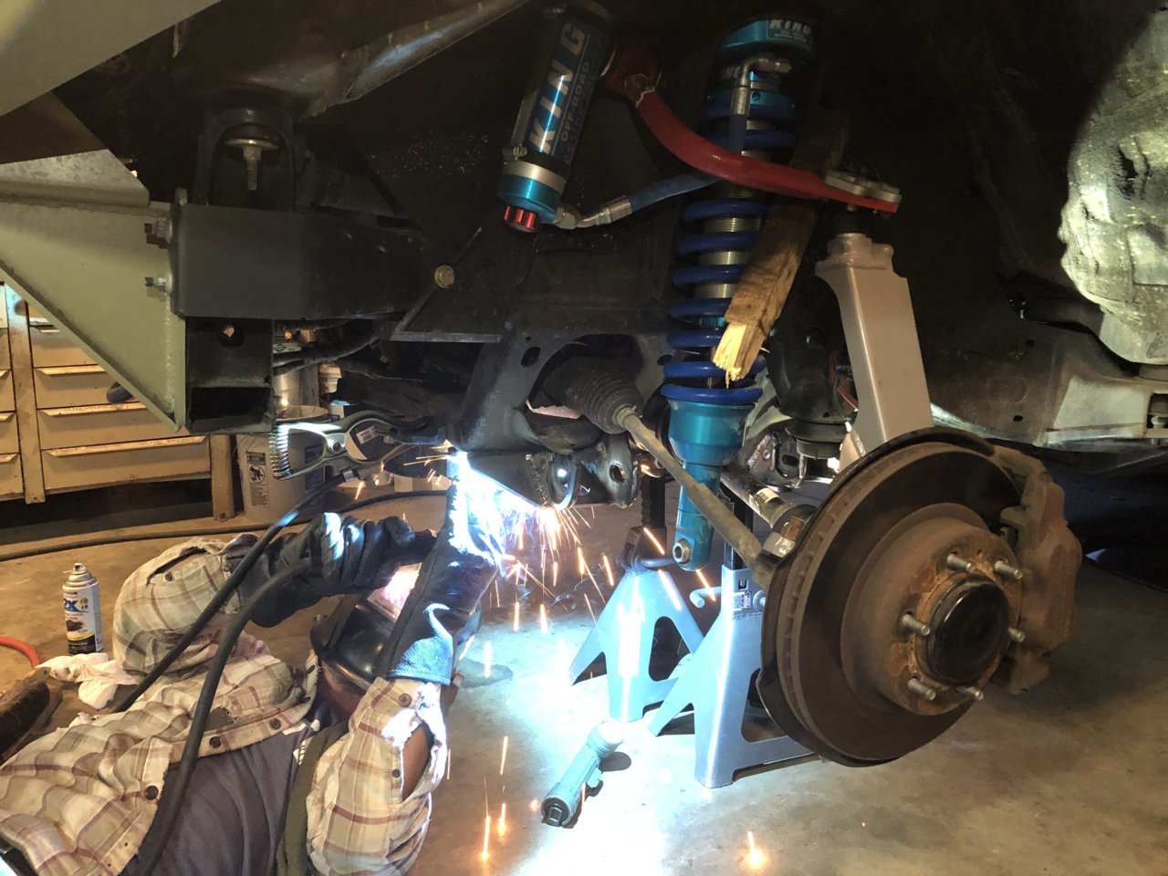

    @Skell Knocked these out for me! It was a bit of a PITA on my truck, since the majority of my tabs were bent flat.
    Overall Great product, I have much more confidence off road now!
    Found better pics:
    RCI LCA skids has to be Trimmed a bit

    Nice. What replacement bushings did you go with?
