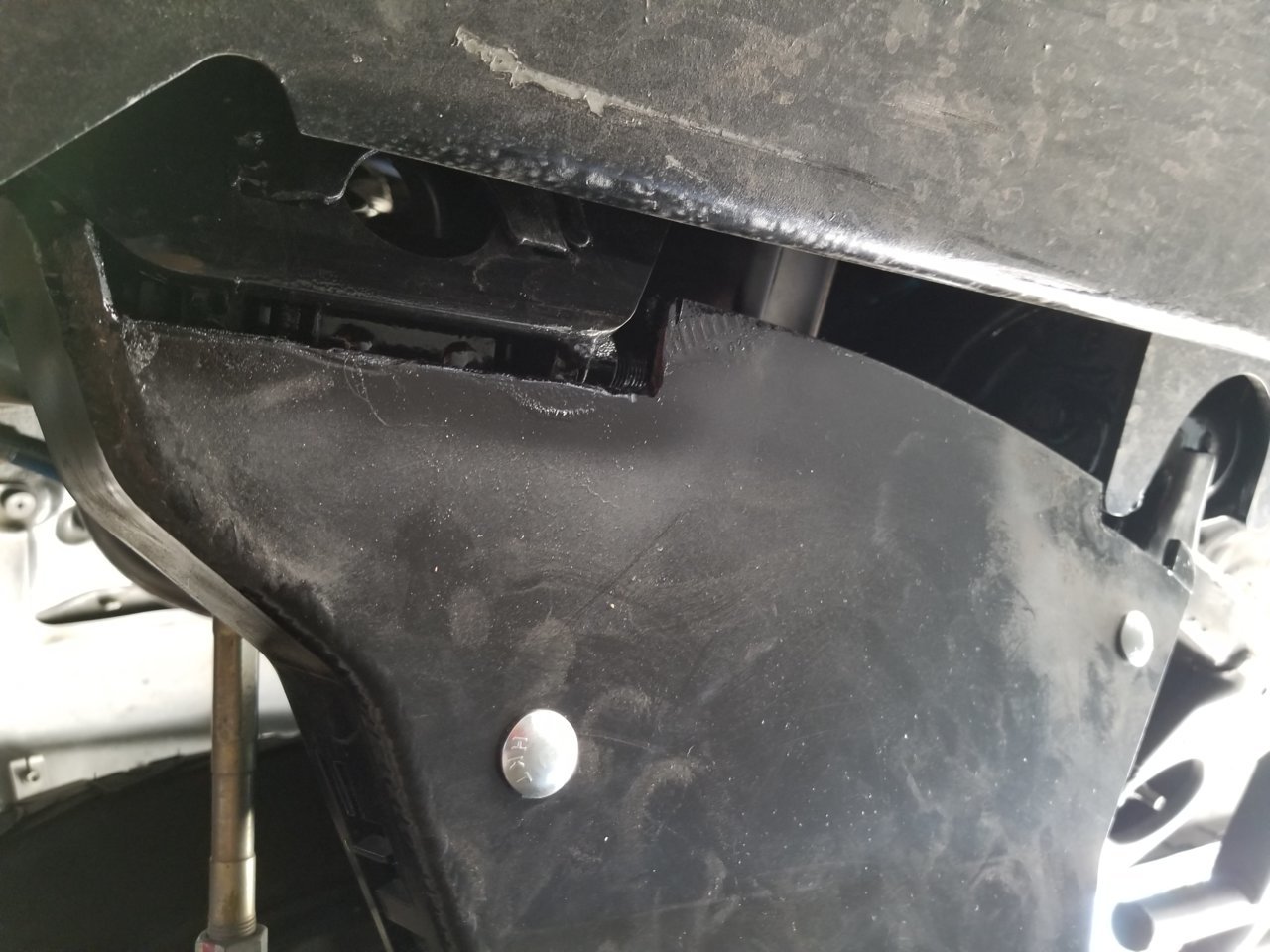

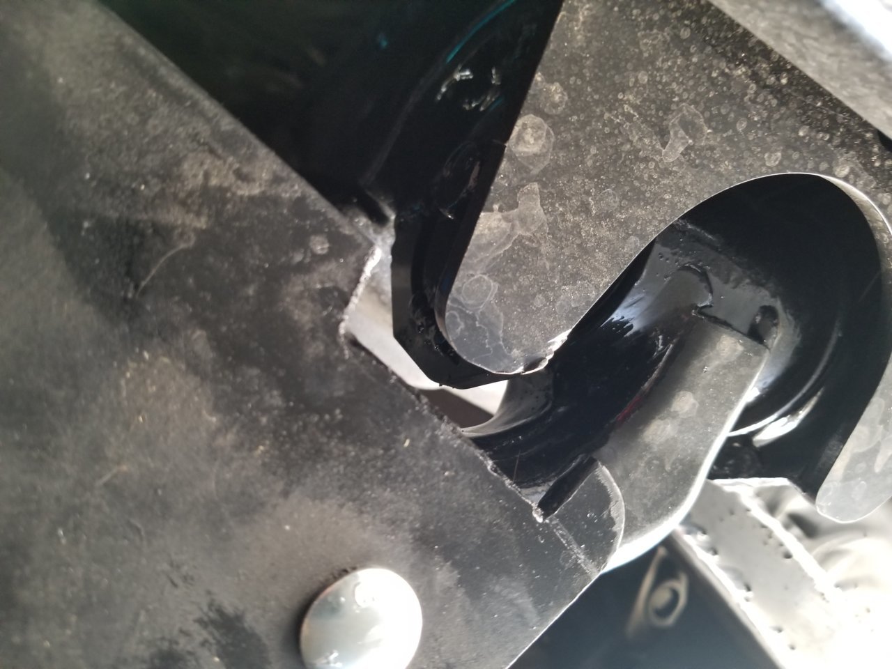

    Has anyone been able to run these gussets with a LCA skid
  7. Mar 25, 2020 at 2:39 AM
    #307
    Mully
    Mully Well-Known Member
    Feb 12, 2014
    #122907
    5,272
    CA
    12 DC 4x4 Lifted Sport
    Lifted, Kings, Locked, 295s and more.
    Yes, BAMF skids, had to make a small cut in them. No problems.
