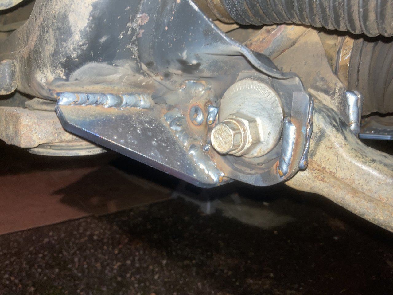

    Just posting this up for people that want to see both tc cam tabs and marlin lca brace kit together. It took hours of grinding to make the openings of the marlin braces wider to accept the tc tabs. I didn't have to grind the openings downward at all.

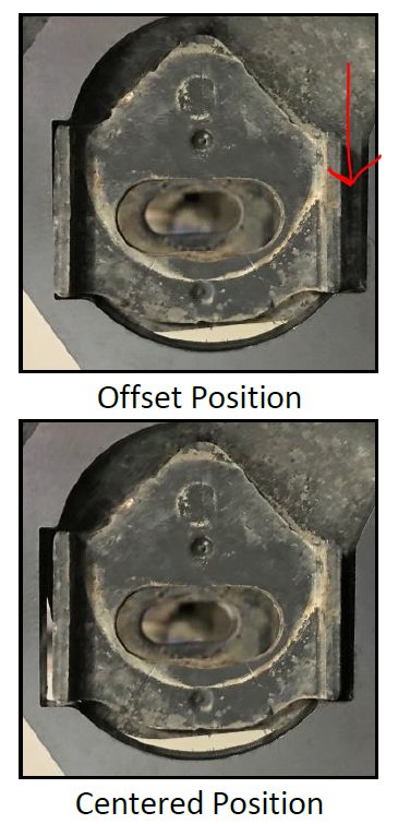

    With a break in the rain and a long weekend coming up I was thinking about finally burning in my cam tab gussets this weekend and have 2 quick questions.
    What material thickness are people setting their welders up for? I'm curious since the gussets are so much thicker than the frame material. Typically with dissimilar thicknesses I tend to set the machine in the middle and keep more heat in the thicker part so I was thinking maybe setup for 3/16"?
    Second, are folks welding the gussets to the tabs themselves? I haven't been able to find a clear answer on that one, seems like some do and some don't. I was thinking to use the "offset position" indicated in the instructions since my tabs are still straight and then laying a bead in the gap shown with the red arrow in the screenshot below. I'd leave the other tab unwelded since it's in contact with the tab supporting it. Any thoughts?
    It seems to me like leaving the tabs completely unwelded would fail to actually provide any additional support.

    I centered mine and burned a bead down the backside of the tabs. No problems, and I have ran it through Moab twice. Alignment is still spot on.

    centered and backfilled the one I did as well, set for 3/16th

    thanks guys, I appreciate the help. Game on for this weekend. Good thing I practiced on some 3/16 making hi lift mounts yesterday.

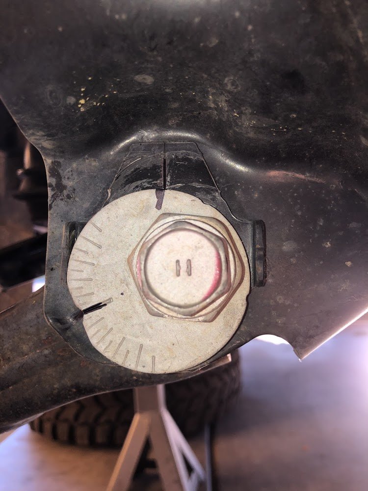

    On the front pass side , I had to trim front & back , of the bottom of the marlin tabs (see crappy pic). I had to do this in order to clear the cam bolts. Not sure if the subframe moved or Toyota factory drilled the hole too low cuz subframe was slightly off? What ever , it’s all in there now !

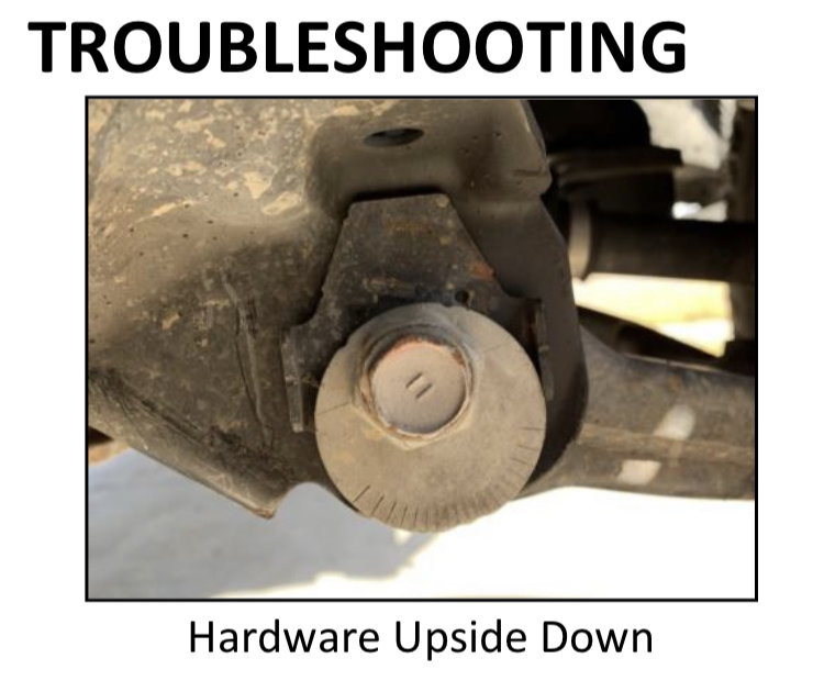

    I think your alignment cams might be upside down. Probably explains your fit issues. I stole this photo from the Marlincrawler installation documents:
    thanks! I bought mine back in august and finally got the nerve up to burn them on. Not familiar with your machine so can’t help you there. I can say welding the 1/4” plates together I wished I had a 220v outlet for my dual voltage welder. It did the job on 110v but alittle extra juice wouldn’t have hurt.

    The Toyota dealer alignment dude said this is how he was able to achieve the caster we were going for. I assumed this was the case but F it
    I like how JD fab sells that new lower a arm subframe which“pushes forward the lower control arms 0-1” giving a bit more caster and potentially keeping it all fixed and not adjustable (so the lower can’t get knocked out of alignment or ovalize the pivot holes). All the alignment should be done via the upper control arms on heim pivots ! My old trucks have all had LT suspensions so seeing this made me sad. Next best thing was for me to weld in the marlin gussets and get full uniball control arms so I can remember fonder times before kid car seats :rolleyes:
