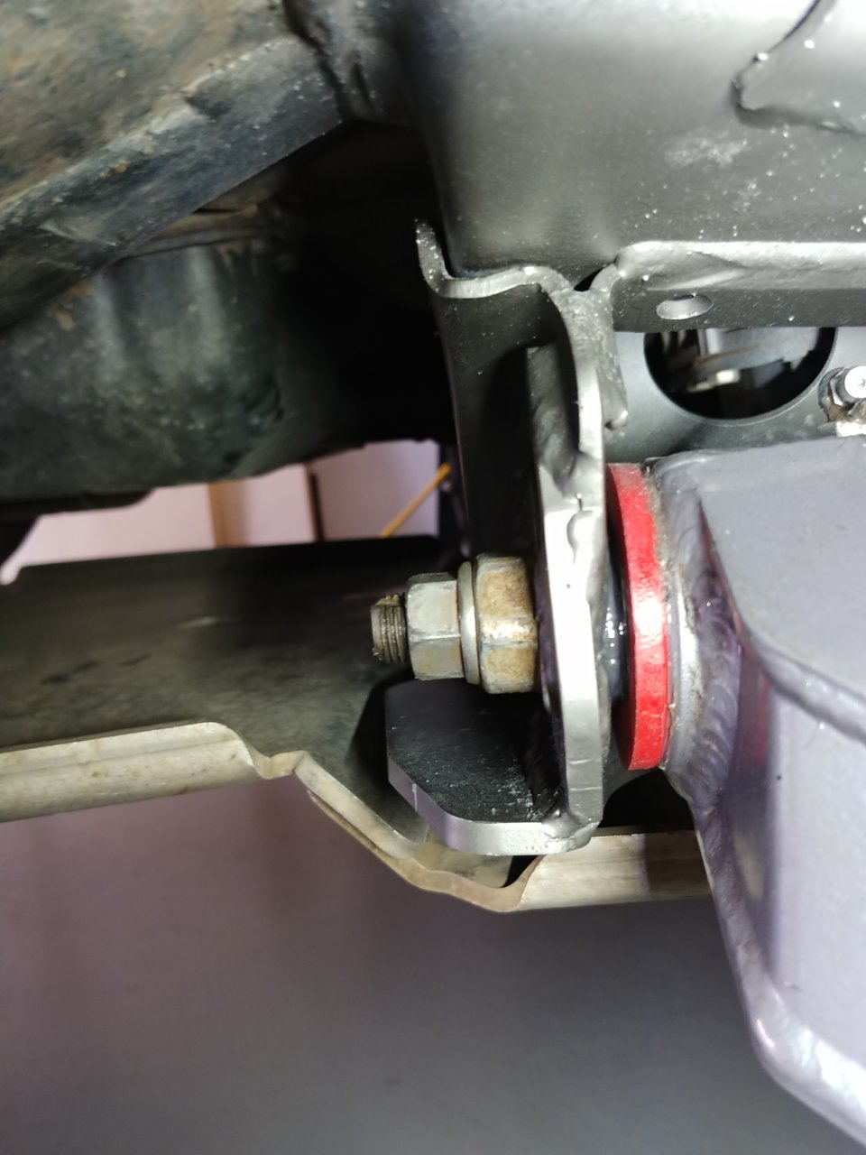

    Anyone have these installed with BAMF IFS skid? Saw Mully had BAMF lca skids. Need to install my kit and most likely will need to trim. Thanks to all that post in here!!

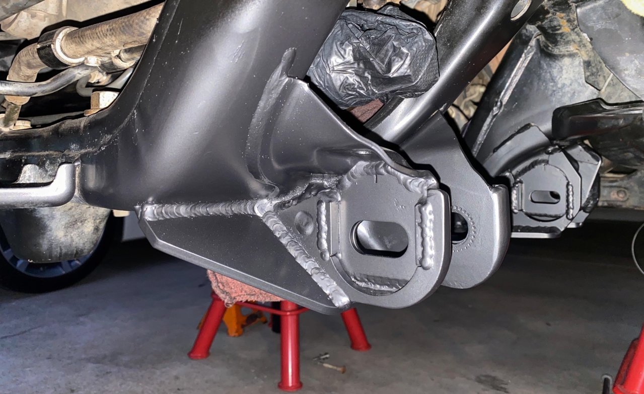

    Sucks man sorry, This happened to me, as stated with LCAs out the welding can pull them apart.
    here is a pic of how it was fixed. It was cut then the control arm mounts properly spaced and welded

    Gonna have to trim those skids. Real easy, and good luck with your truck.

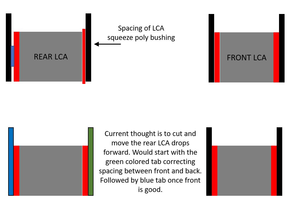

    Hey BroID, Was the spacing between the drops out on yours, or was it the spacing between the front and back drops? What I'm seeing is that the front and rear fit, but the front poly bushing on the rear of the LCA is being squashed and the rear bushing on the rear of the LCA has the gap. Besides the obvious that it should have been done with the LCA Installed from the start, does this sounds like a good fix to the upgrade? I'm looking to measure and ask the dumb questions before cutting and grinding. Feedback from the boards is helpful!
    When I got home and greased the joints is when I noticed the gap.

    Spacing on the drops was out on mine after being welded in. LCAs where out when welded and I believe when the kit was welded in it pulled them apart. I was unable to keep an alignment afterwards and had a bit of play and wobble in the LCA most specifically the rear.

    Even with the gussets welded around the lower arm pivot , the spacing has some flex in it. I think this is a good thing as it will “clamp down” as you torque the bolts down. It also allows it to “open up” when loose so you can remove the lower arms if needed. The bushing inner bolt sleeve will ultimately determine how wide the final slot will be when tightened. You should measure all the inner sleeves , bushing widths and even outer sleeve tube widths to confirm.
    this is another big reason I went with uniball inner pivots. Once tight between the misalignment spacers , the uniball and lower arms will absolutely not make contact with the mounting face or flex at all. This is opposed to a bushing which will either flex about the inner sleeve and cause the metal outside bushing tube to scrape against the chassis. If torqued too lose or even too tight the poly bushing can bulge and excessively wear against the frame pivot walls. Also, in your case , with a uniball pivot you can simply add a washer or shim washer in between that gap and not effect the uniball at all. That won’t be the case for bushing . It’s overall a sloppy “getter done” pivot , intended to supposedly reduce maintenance and “sound”. Absolutely sloppy and loosely goosey IMO. Most people who don’t like heims or uniballs have never even ran them on anything in their life yet are so opposed to them for ... reasons????

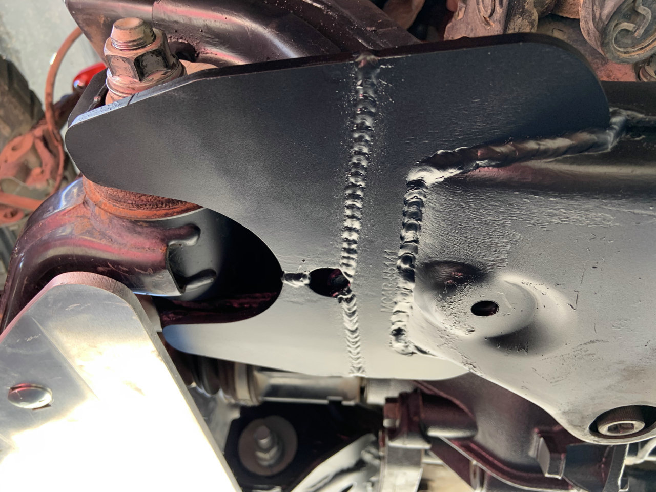

    Dropping this pic for those with or looking to get rci skids and the marlin brace kit. I notched the lca skids for full clearance while cycling the suspension. The front skid and transmission skid had to be notched as well to clear the rear marlin brace.

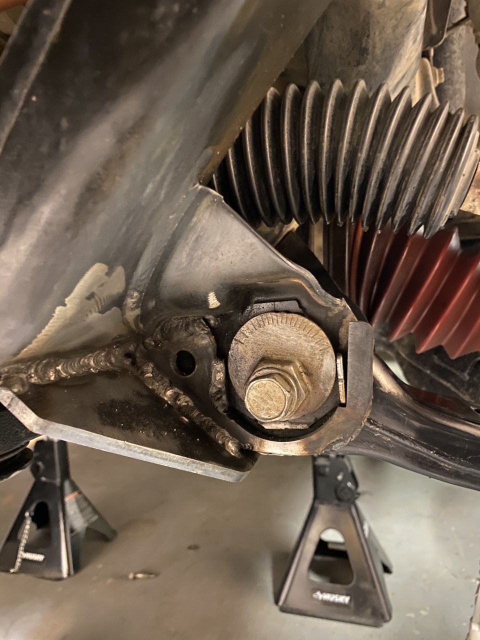

    Well started welding the brace tonight and nobody told me how crappy welding on your back is. Was pretty decent at welding on a table but this a little tougher than I thought. Def helps if you weld with the arms on with not separating the tabs. Mine are perfect and I haven’t had any bushing issues. Did catch some powder coat on fire for a sec but shot some water and it was fine.

    Finished up the gusset this weekend
