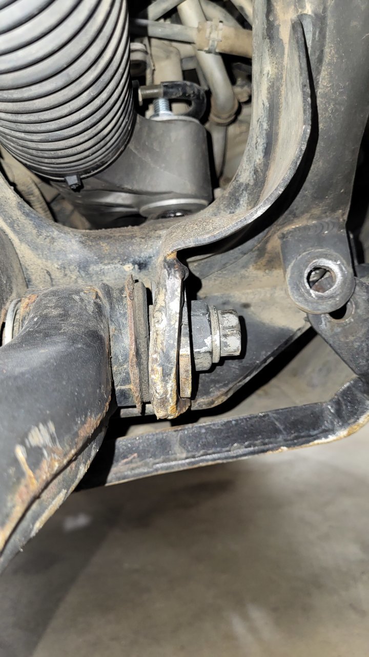

    Folded the front tab in via rock

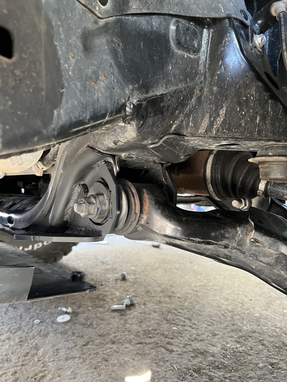

    Just installed the kit this weekend with @Jkriegs.13 . Didn't remove the LCA, didn't melt the bushings.
    No issues with the bison cams, either.

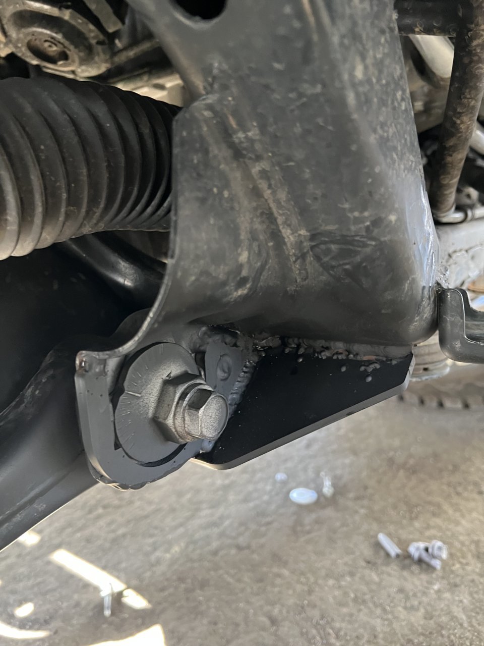

    Finally got around to installing these after the 5th alignment knockout. Drivers side tab was bent pretty badly but it’s all installed now.
    These are probably overkill given most of the extra protection is under the skid plate but it feels good to have them on.
