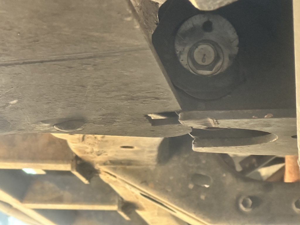

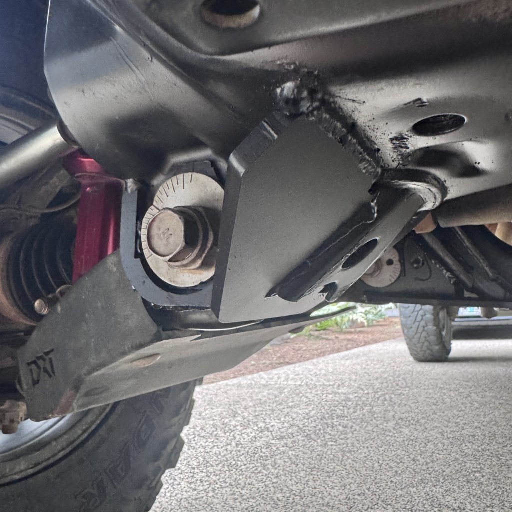

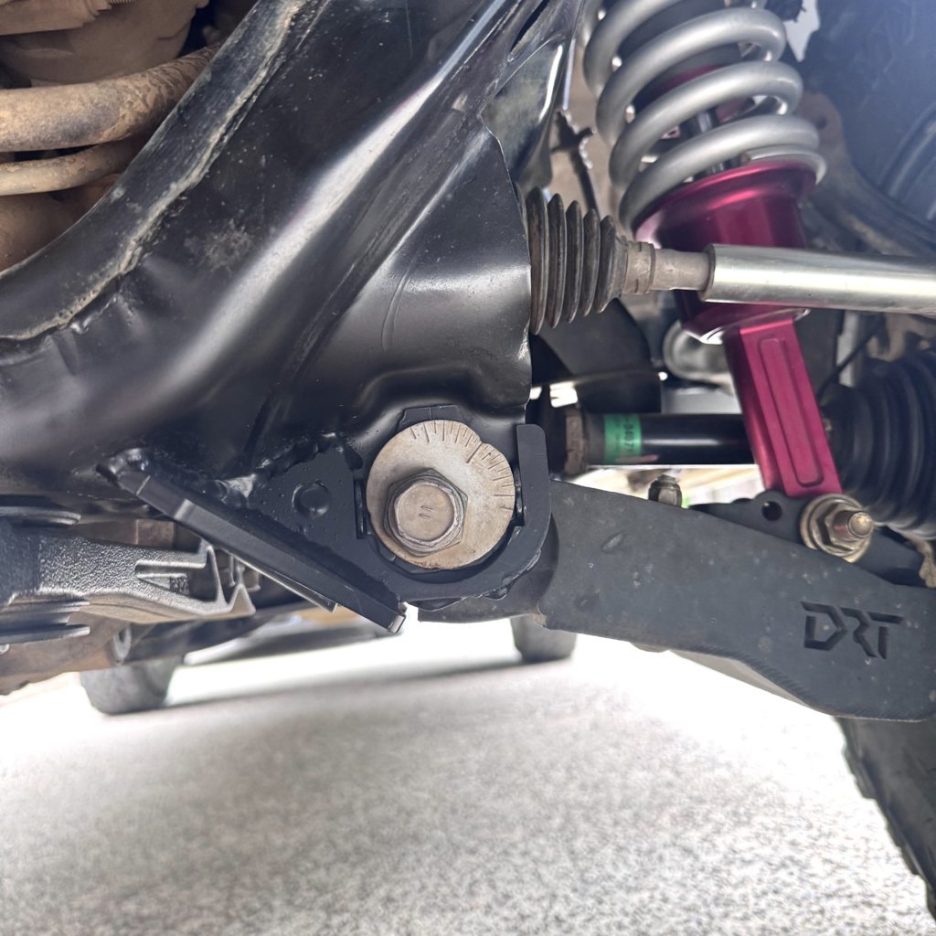

    Wait what??? Why? Just notch the lca skids. All u gotta do. I have have full skids, minus fuel tank and I didn’t have to notch’em. Post pics when u do, I’m curious to see. I’ll get u my pics up today

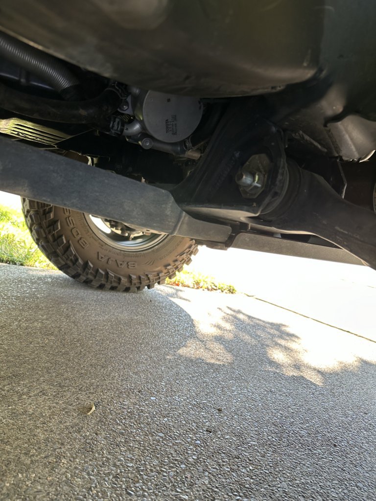

    2nd pic is driverside looking down towards the rear. 1st is passenger side looking up from underneath. Too lazy to lay down in the dirt, but that’s where I notched. I only had to cut out the back ends on both sides. IMG_1420.jpg

    I have RCIs too, show me ur cuts! Please.

    I have a RCI engine/trans skid and needed to trim the trans skid a bit. 5 minutes a side with a cut off wheel, 5 minutes a side cleaning it up with a carbide burr. 5 minutes a side painting the cuts.
    DRT LCA skids do not need trimmed in my case to fit this.
    Makes a big difference in how your truck drives, really tightens up the front end feel.
