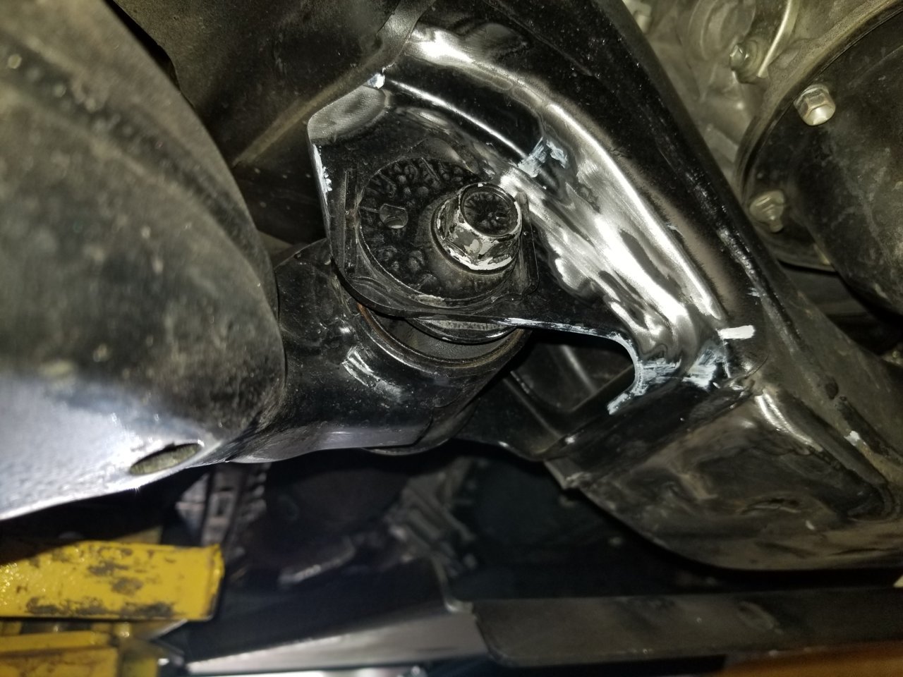

    To be clear, I have replaced both Lower control arms with Total chaos ones, the LCAs themselves certainly aren't bent, it is the LCA mounts on the frame that are bent backwards. I had the frame inspected and is it 100% straight, but the bent lower control arm mounts are not allowing my alignment to be 100% in spec. Im just trying to figure out the procedure for aligning them before I weld these in. I thought when I first read your post you had a similar situation but I went and re-read and looks like you just bent the tabs and not the entire flange. In any case Ill be ordering a set and it looks like it should help me get them aligned and not run into the issue again.

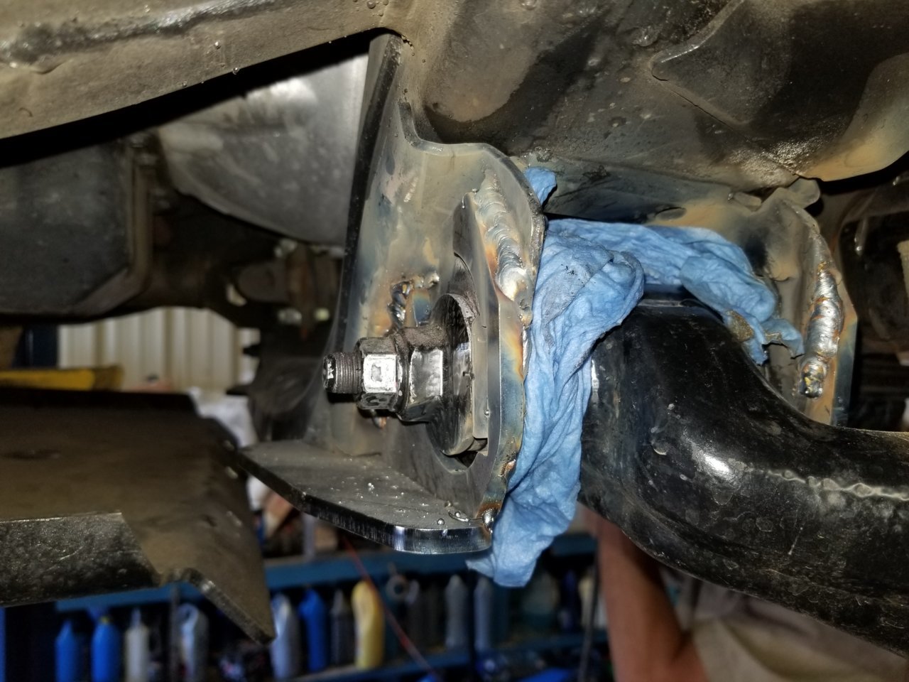

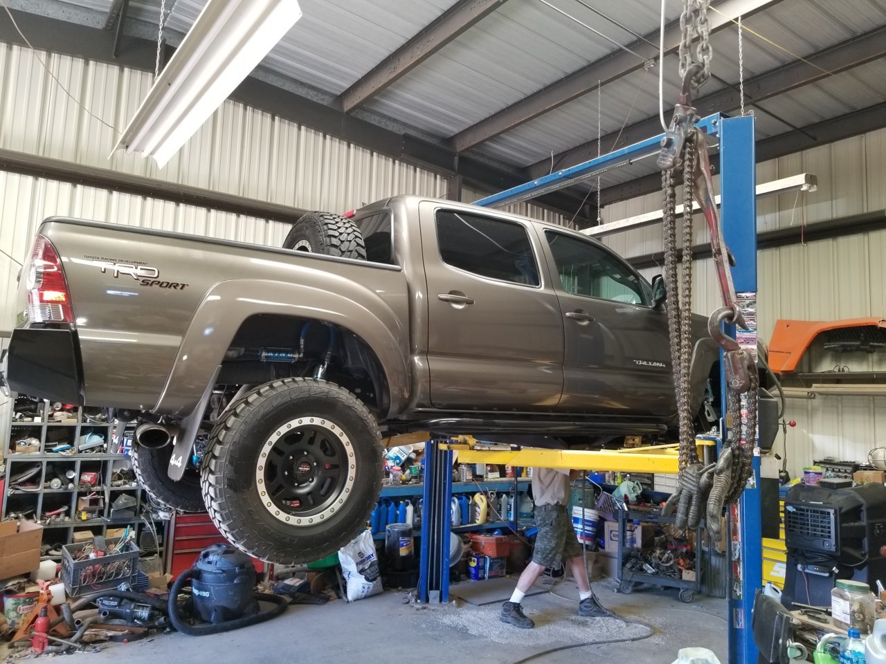

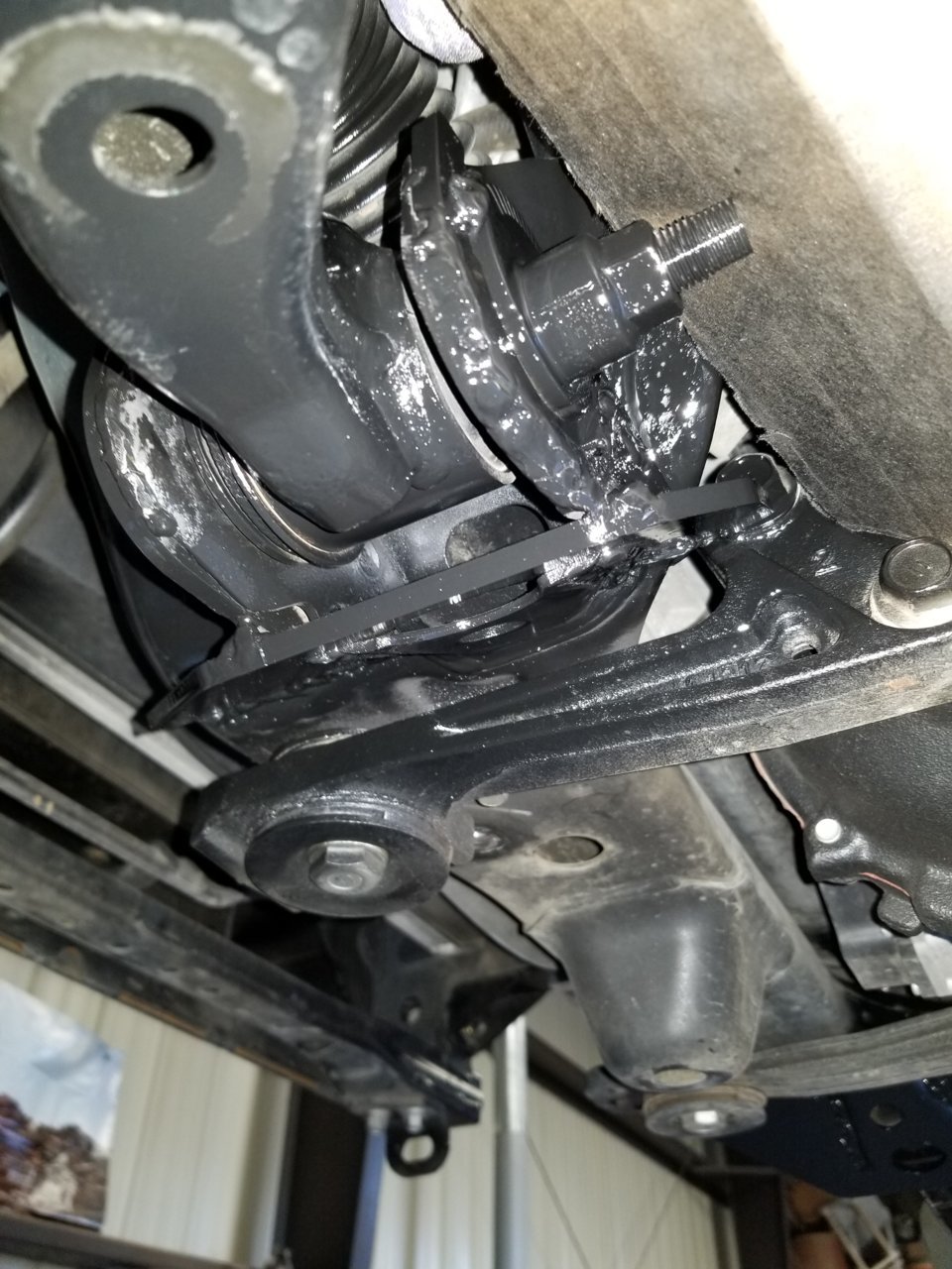

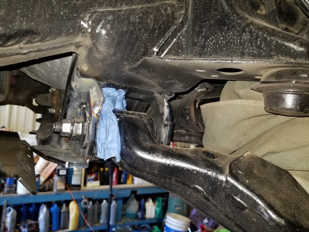

    In the process right now. As Big Mike said, you can do it with the arms on the truck. Wrapped CV, steering rack boots and using water to keep bushings cool. Stitch welding a little at a time. Will post more soon.

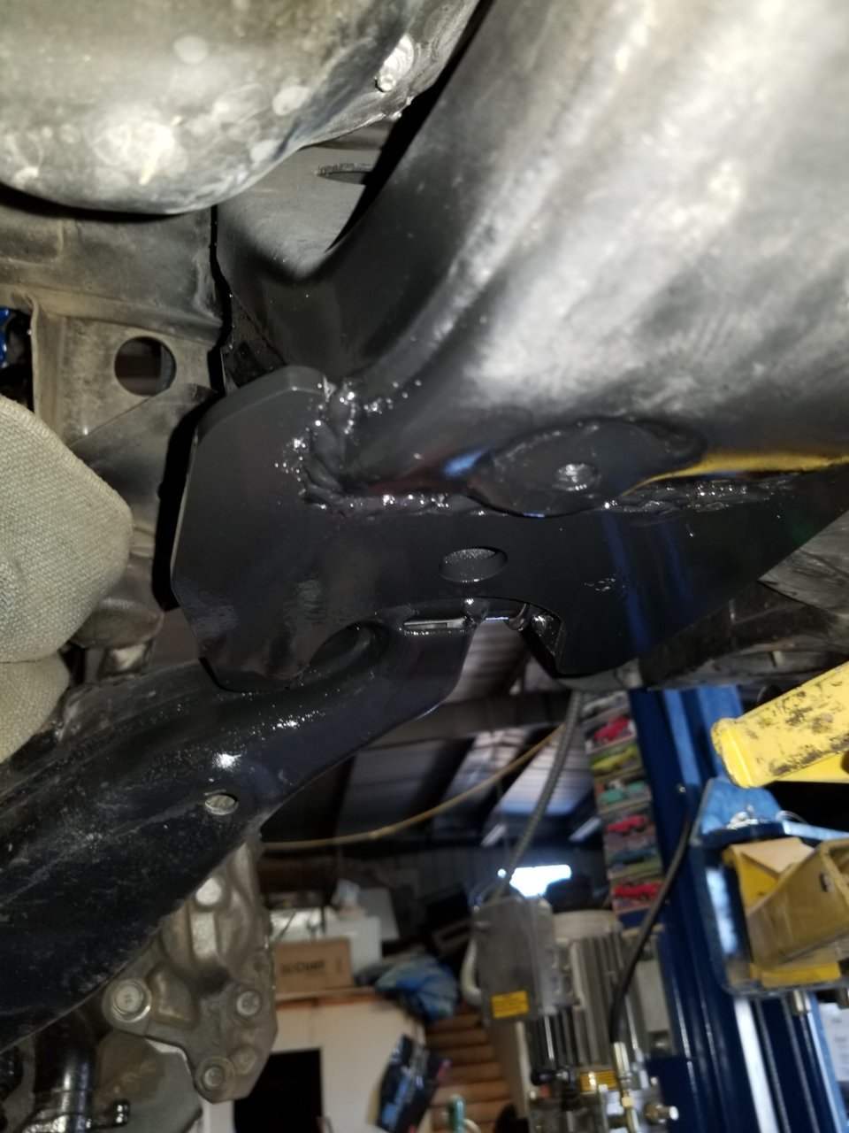

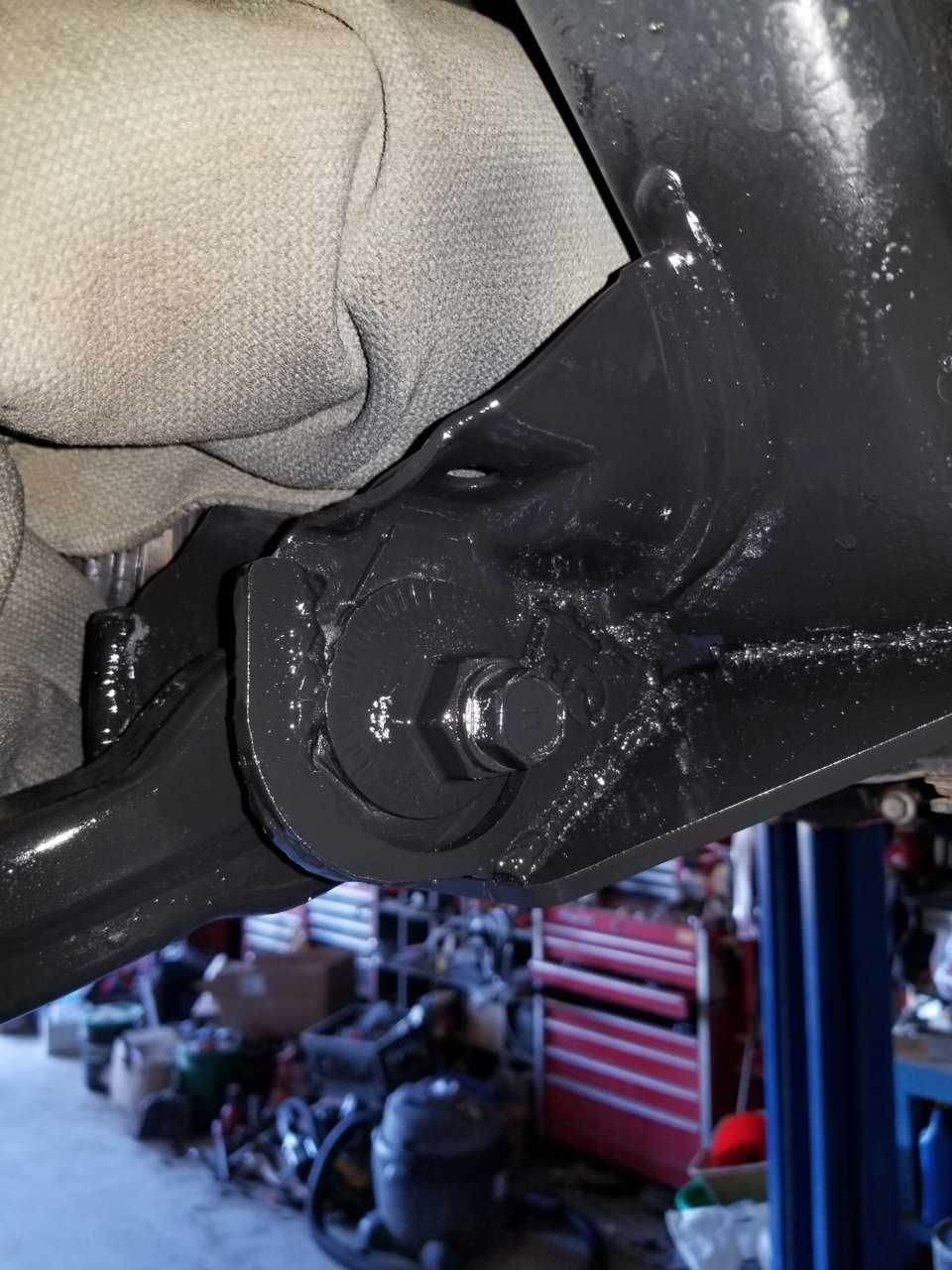

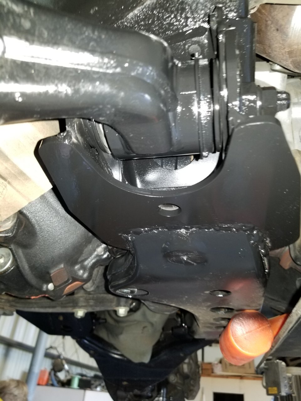

    Done, glad I did this. What an awesome product. We took our time, measured twice or more and burned them in. Bushings never got overheated. Wet rag trick was a great idea. Thank you Big Mike.

    No problem, I marked where they needed to be welded, cleaned up the burn area and went to town, jumped from brace to brace so not to damage bushings. Used wet rags to keep them cool. Good luck.

    Chris, what did you spray on it after? Did u just use spray paint or an undercoating??

    Just some Walmart cheap paint. Going to paint up the entire subframe with this now.
