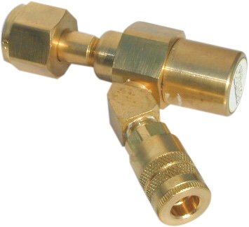

    Then ordered this guy to help complete my 20# CO2 tank

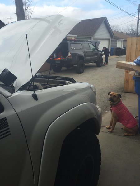

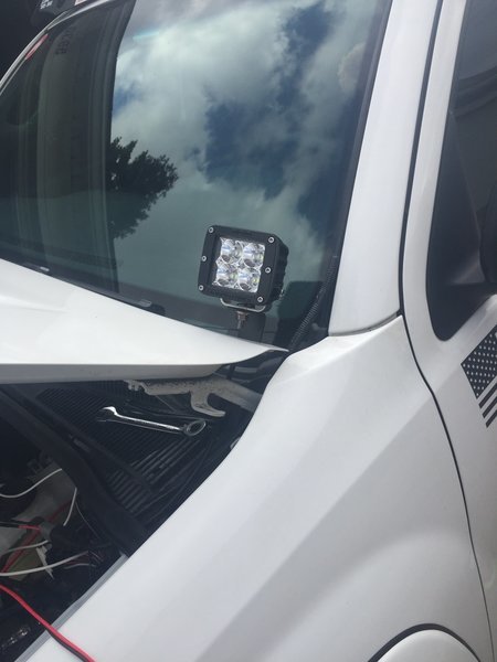

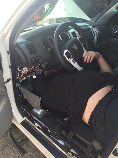

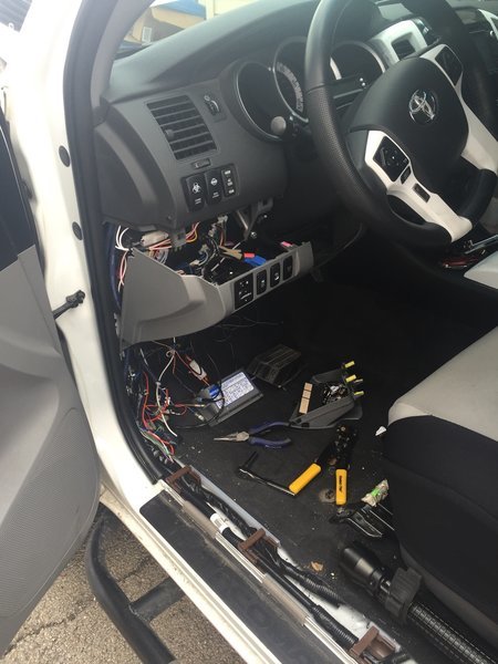

    Had a mini mod day with my brother (@geekhouse23)
    Oh. And Ellie

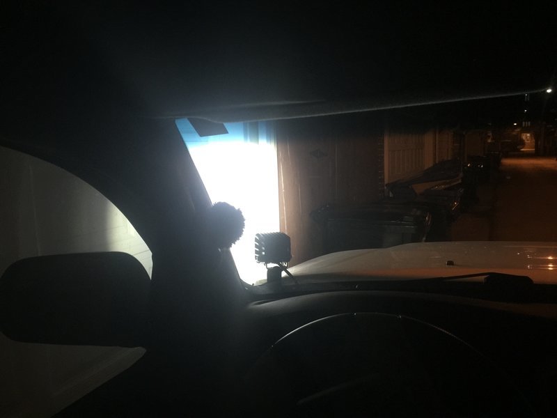

    Finally got some wiring done on Ashlee
    Upgraded ditch lights to rigid (finally starting this long process)

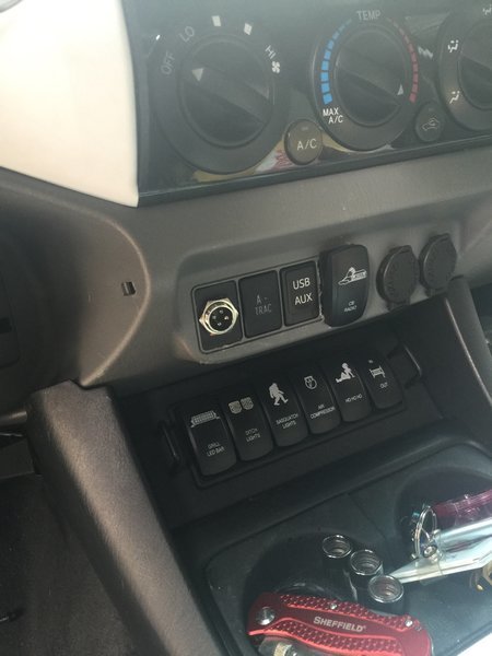

    Fixed my CB wiring so it should work better now
    The things we do to access wires.....
    (Excuse my beer belly haha that too is a work in progress)

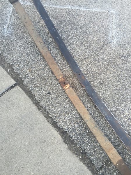

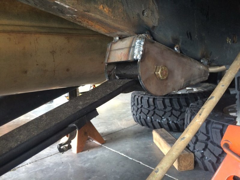

    The process has official been started
    These weren't dipped in vinegar but I don't think you really need to do it. I've exposed some metal but I'm more concerned with getting the rust gone so I'm happy. The ones soaked in vinegar should be easily to do. These are now soaking to make removing the bushings easier :thumbsup:

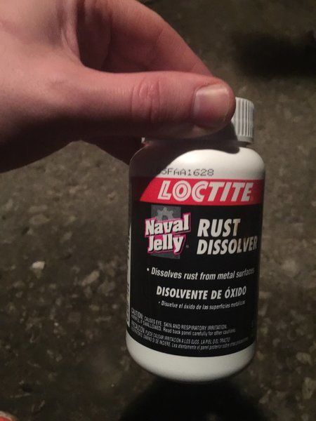

    So I've been working on the 63 leafs this weekend. I've tried different things to remove the rust. Fastest is the flap wheel. Hands down. I'm going to sand them by hand so look isn't terribly important right now. Plus I'm painting it with por-15 so it should be fine.

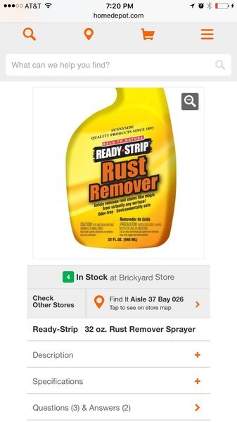

    I did try some loctite rust remover
    It did work but too much patience and effort compared to the flap wheel.
    I also tried rust remover drone Home Depot. Same review. Not as fast but still works if it's something small you want to take light rust off.
    Also white vinegar loosens it up but it takes wayyyyyy too long
