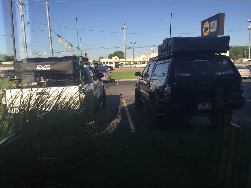

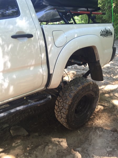

    @geekhouse23 and I always end up at bdubs. This time on the way to @NwiTACO for new bumpstops and putting in the 4th leaf for the Chevy 63s

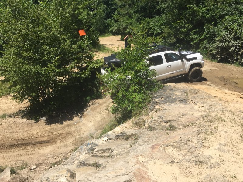

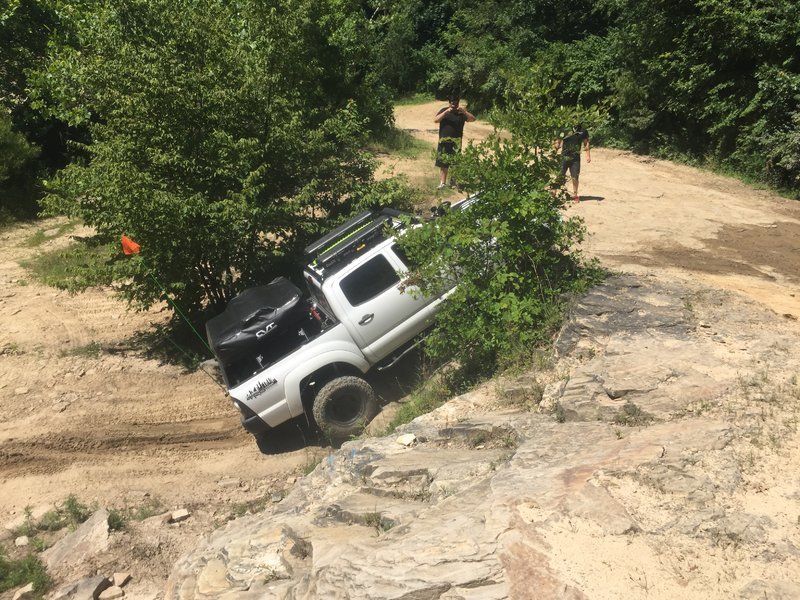

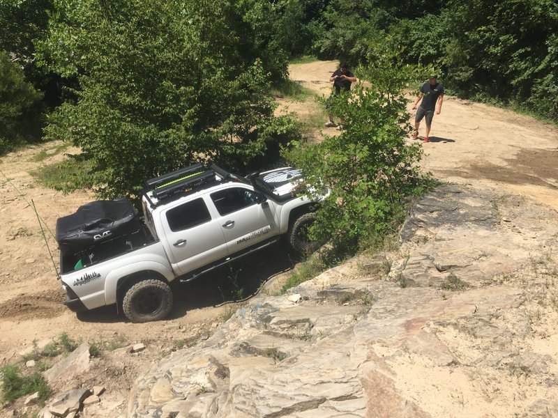

    Heading up the wall at badlands

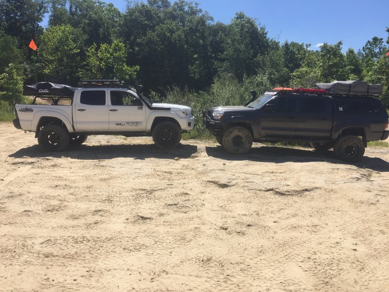

    @geekhouse23 ans I

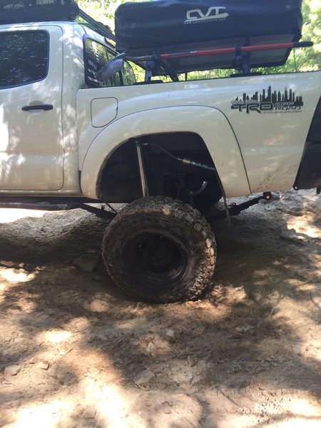

    Had to test the flex of the Chevy 63 swap

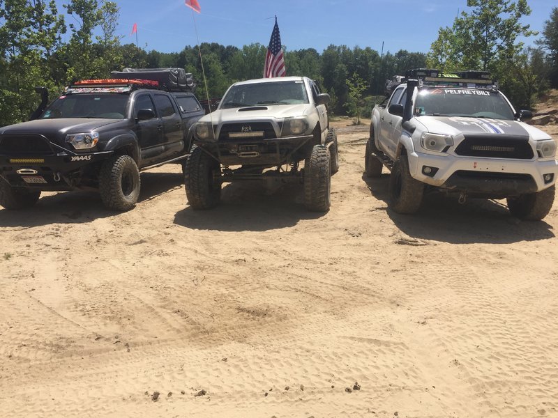

    @geekhouse23, @NwiTACO and myself

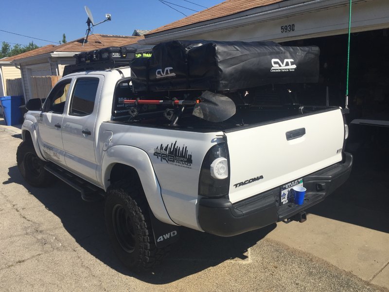

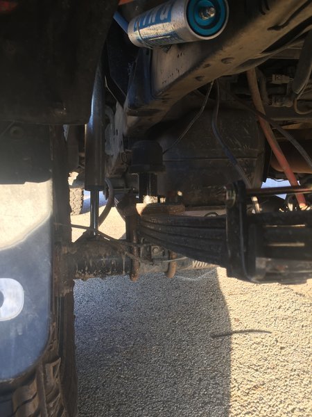

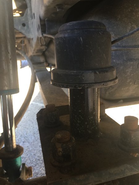

    Finally took some better photos of the new leafs with 4 instead of 3 and my new bumpstops from @NwiTACO
    And yes. She needs a wash
    ChadsPride likes this.

    Get. Limit straps. Asap

    Next purchase. Have some personal finances to take care of so next paycheck or two. Plus still trying to figure out where/how to mount them.

    Don't flex too much until then haha you'll blow the seal

    Sorry still learning but are you talking about for the rear?

    Yup. He needs them because the 63's will flex beyond the shock so you need to limit the droop so you don't over extend the shock. You and I have dakars that limit the droop at the same point
    Not sure why people put limit straps up front with a MT build.. Can't droop far enough to bind a cv

    Actually his 63s are maxed out for droop at the same time his shocks are. It's all about how it's setup. His springs are maxed on droop and then were forced beyond taht, then the axle end mounts positioned.
    Blanket statements are why people rush out and spend money they don't need too.
