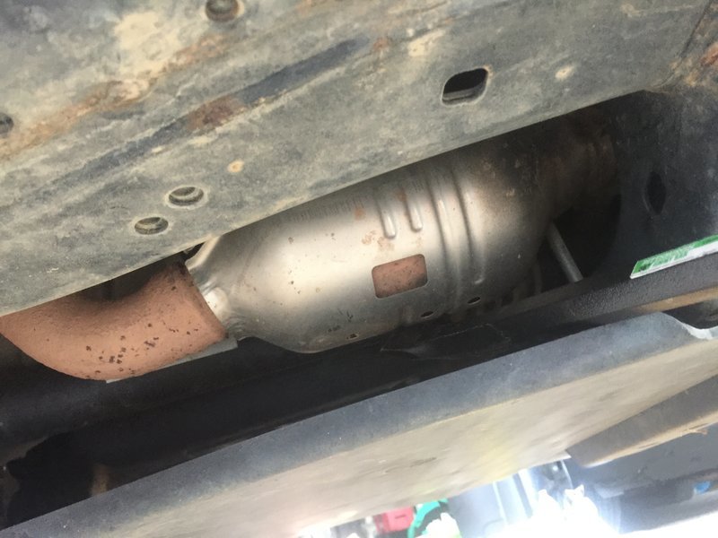

    Well I figured out the culprit
    Went away and two days later it started again. Now the exhaust is rubbing on the last skid. So I'm going to drop the skid till I can get the exhaust done so there's more space and won't rub. Also got a squeak up front from suspension so going to recheck and retorque bolts tomorrow

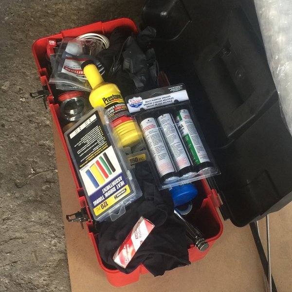

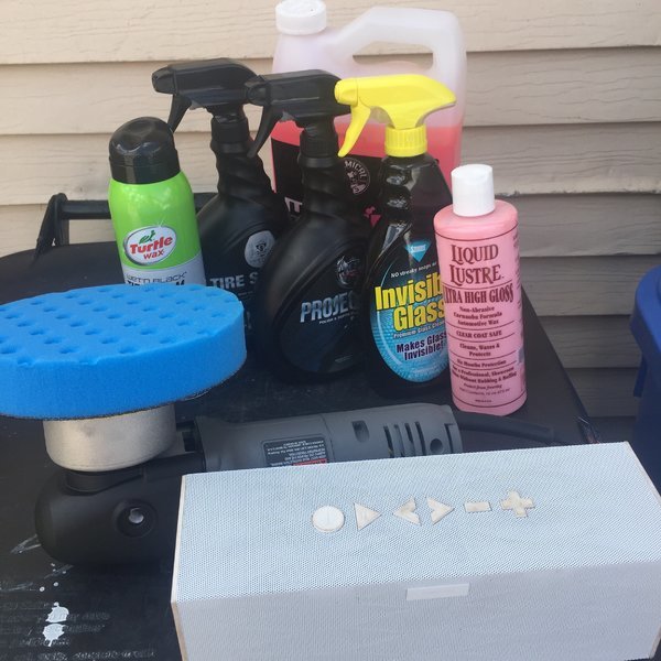

    Haven't been on here in a while. Started what I hope to be my last year in grad school Monday. And since I couldn't make it on a wheeling trip last weekend I decided to wash my truck.
    This contains all the tools I have in my gun case
    ChadsPride likes this.

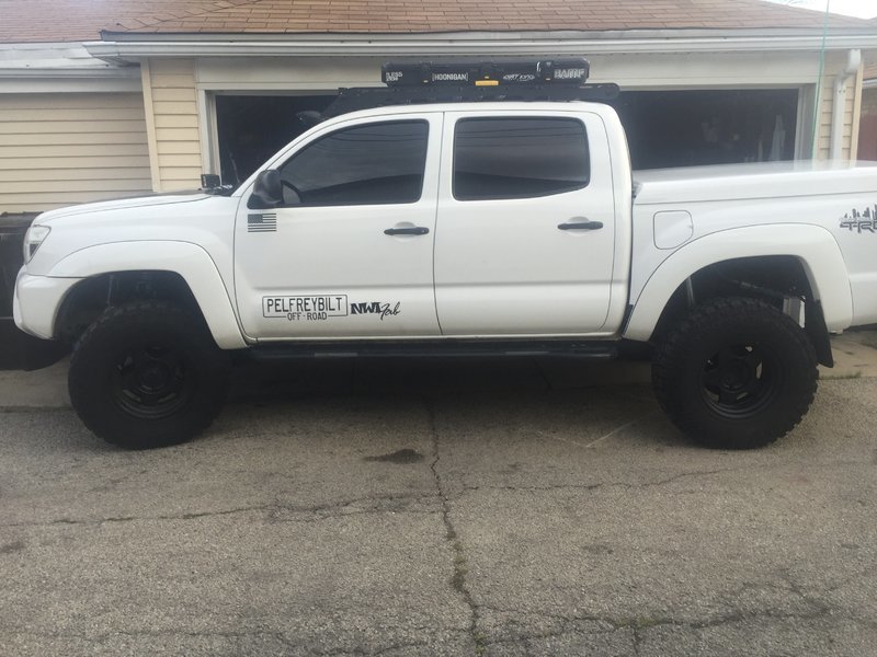

    Since I now have to save money for bigger spending I've been getting all the stuff installed I've been meaning to. Huge thanks to @geekhouse23 for helping me. Finally put in the top plate spacers (1/2" pass and 3/4" driver for the lean) it rides the same, no issues thus far. Tightened up all the bolts after a few miles on it and it finally sits up and level and don't have to worry about the coils because the preload is the same. For now this is not the best option but it has helped a lot.

    Uhhh why did you put top plate spacers on kings..?

    does kinda defeat the purpose of adjustable coilovers..
