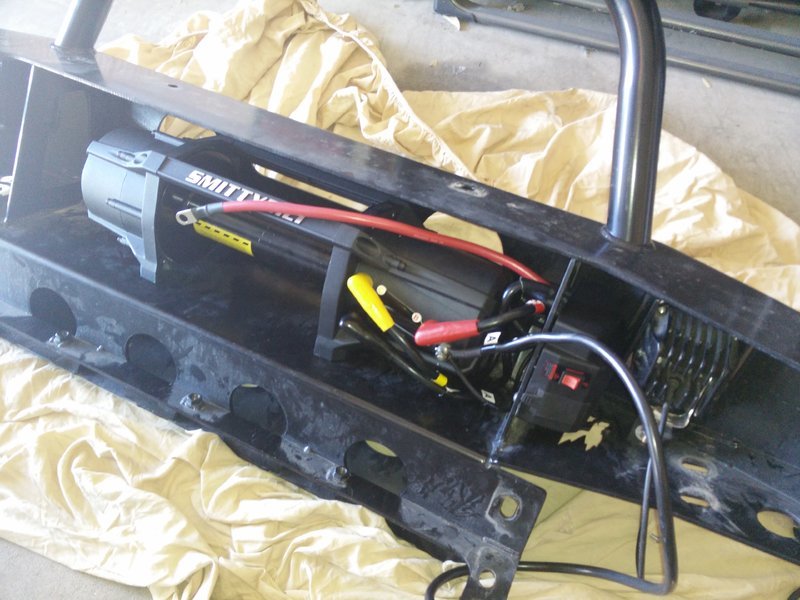

    Put the winch on. Here are pictures. In general the wires from winch to controller were extended from the factory 1 foot to to 5 feet. The control is mounted under the hood between air box and ABS module. The winch control switch plugs in and routes out the hood for now. In cab switches are the menu soon.
    now for the pictures....
    Inside of the M8000S controller with original 1 foot wires
    New longer wires on winch
    Hole to get wires from bumper to inside engine bay. Lines with rubber to prevent damage.
    Winch in the bumper (this will be the second time the bumper has been mounted).
    Winch controller mount, on a bracket I fabbed up.
    All buttoned up and wired. Ready to be spooled in.
    It was dark when I finished spooling it in, and I like this picture.
    Lights will be mounted this week.....I hope. This is with factory skid plate. Hopefully the new skid plate will also get mounted this week.

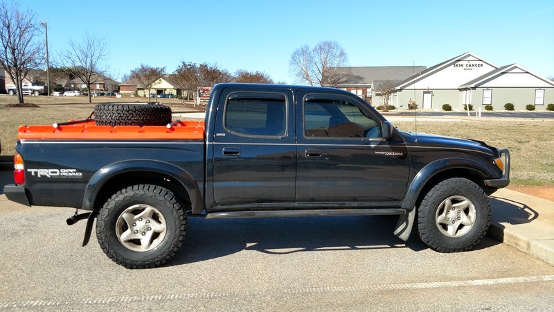

    New tires. KO2 265/75R16 on 5 matching rims so rotation can include all of them.IMG_20170130_124043316_HDR.jpg

    Well.....The new tires rub the driver's side frame rail at full left turn. Grrrrrr.

    To address the new (slightly) bigger tires rubbing on the frame, I put on some BORA 0.75 inch spacers. They stopped the rubbing on the frame and exaggerated a little rubbing on the mud flaps. The mud flaps are now gone on the front and there is a little rubbing on the plastic fender well. I will address that with a few zip ties. The windshield washer fluid bottle is also rubbing. Since it sticks out under the front bumper, the plan has always been to move it, guess that is a higher priority now.

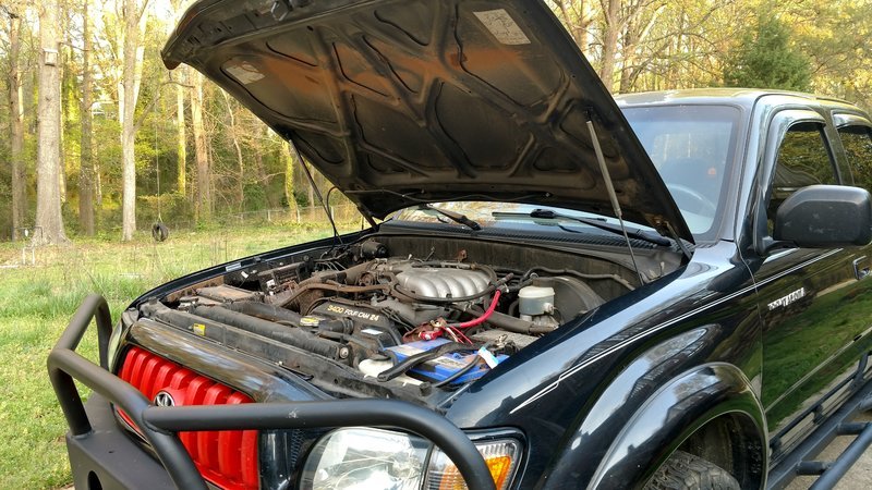

    Recently I was out in a trail and need to open the hood on a hill, in a weird spot. It was difficult to get the hood prop in place while hiding the hood open..... So I bought the redline hood struts. These took about 20 minutes to install. They are awesome!
    Pull the hood release lever and the hood pops up about 1.5 inches. Then push the release lever in the grill and lift about 4 inches and the hood lifts itself the rest of the way.
    I left the hood prop rod as a fall back, but I never want to use it again.

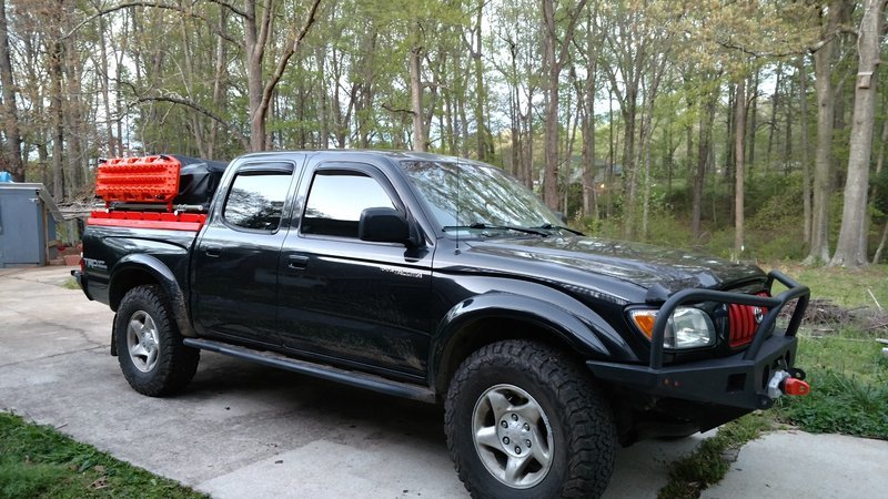

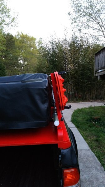

    Mounted some maxtrax with a couple U-bolts and plates I whipped out.
    To which my girlfriend promptly pointed out that with the tent open the window won't open if the maxtrax are still on the mounts. Doh. Guess they come off to open the window for now.

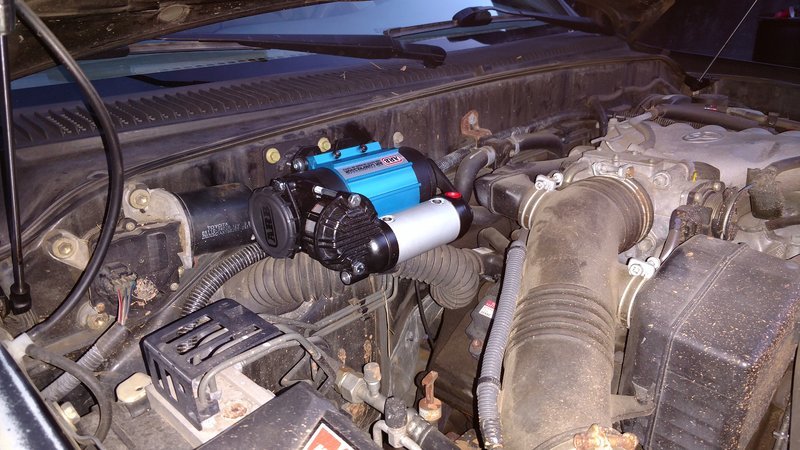

    Started mounting ARB air compressor.
    Made a bracket
    Mounted bracket to engine bay
    Mounted compressor to bracket
    Hood closes
