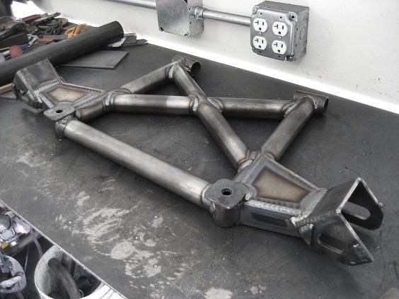

    Got any pics of the custom sub frame on the truck?

    Can't really get a good pic of it on the truck because lower skid plate pretty much covers up the entire thing, but here's a pic of the subframe off of the truck:

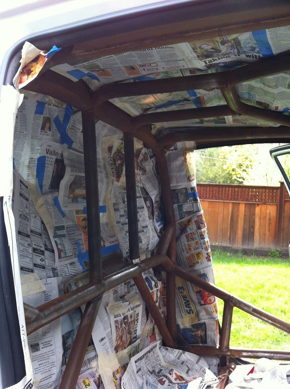

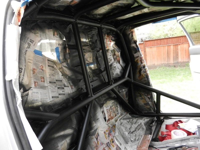

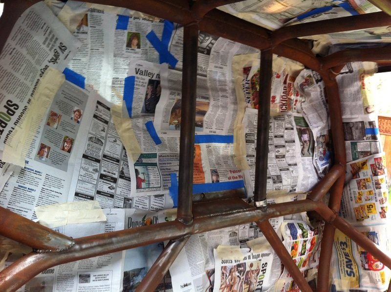

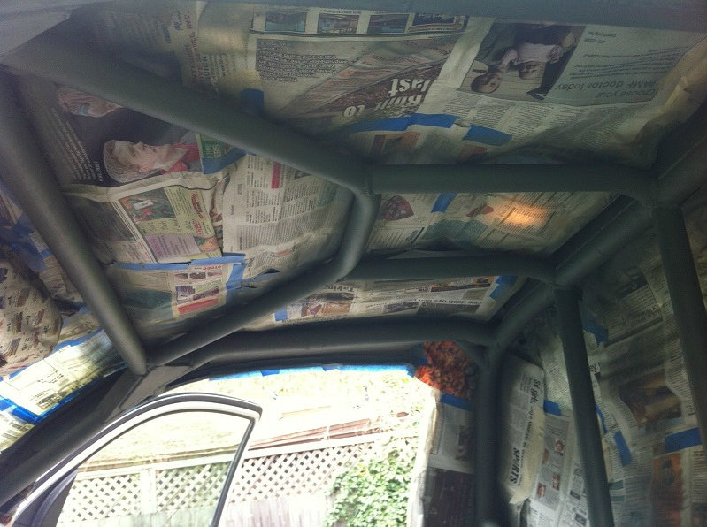

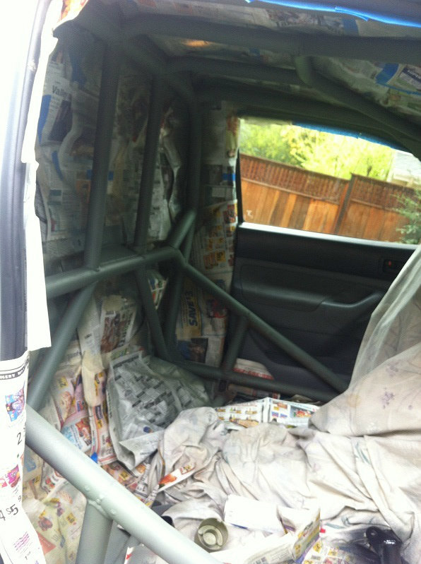

    Finally painted the cab cage. Masking everything off was a biiiiitch. But totally worth it.
    Used 3 cans of Derplicolor self-etching primer, 2 cans of Derplicolor bedliner and then finished it off with one can of Rustoleum Bedliner for a nice satin finish.
    The Derplicolor Bedliner is lame but I couldn't find any more Rustoleum which is much much nicer.
    My recommendation to anyone planning on a cab cage: Paint as much as you can before you completely install it.

    :eek: You flipped it! Lol looks good
