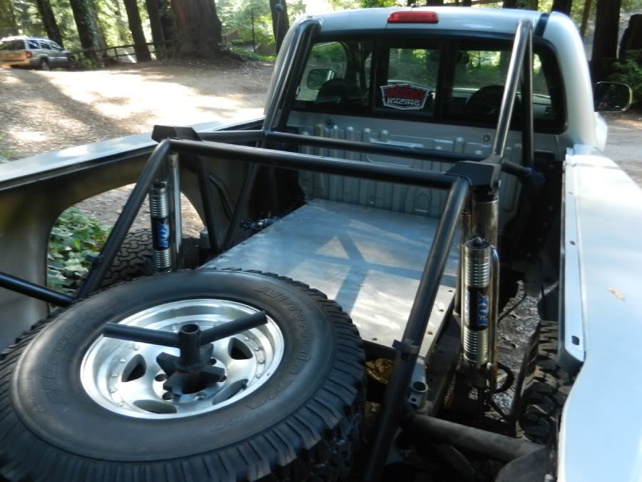

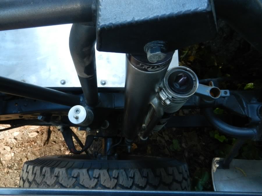

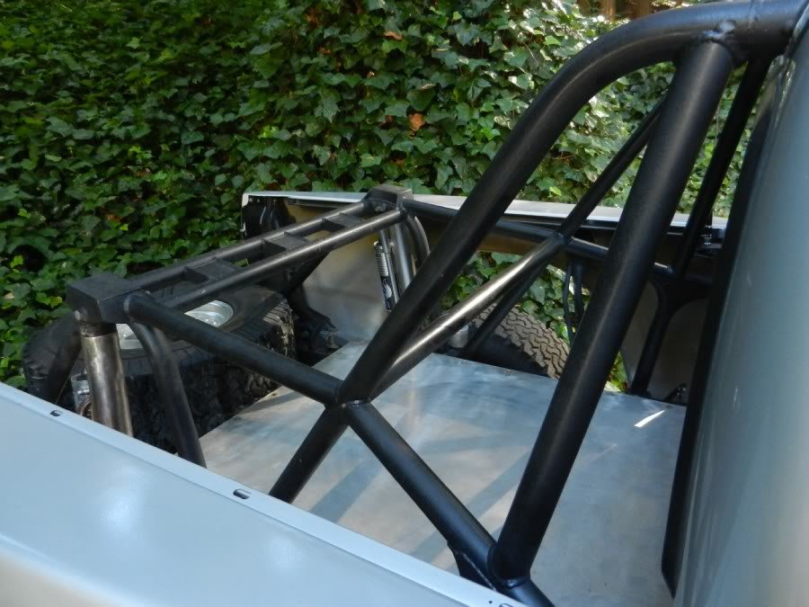

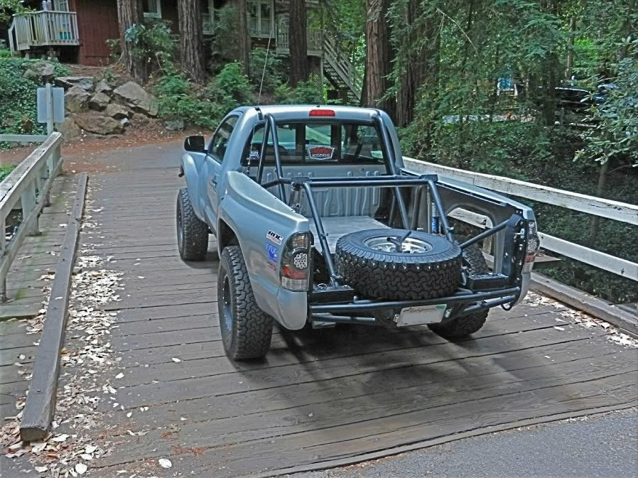

    As requested:
    "Bed Cage"
    and a for a nude shot...
    Let me add a little info here:
    To the keen eye, you can see that the bed-cage began life as a simple hoop with cross support. The bed was retained and the truck used that way for a while. It was the original owner's intention to keep the back multifunctional and build onto the cage while retaining the composite truck bed. Things quickly escalated and the bed soon ditched as the cage-build spun out of control manifesting itself as the form it takes today. Bedlessness (new word) is a trade off and something I decided to look past when making this purchase. However, I plan to continue where Fabien left off and box in the bed plate he laid down. It was his intention to create an open storage bin using the bed plate as a base.
    On an additional note: When the spare is removed, a tailgate can be re-installed and be functional.

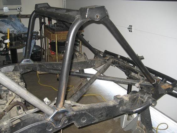

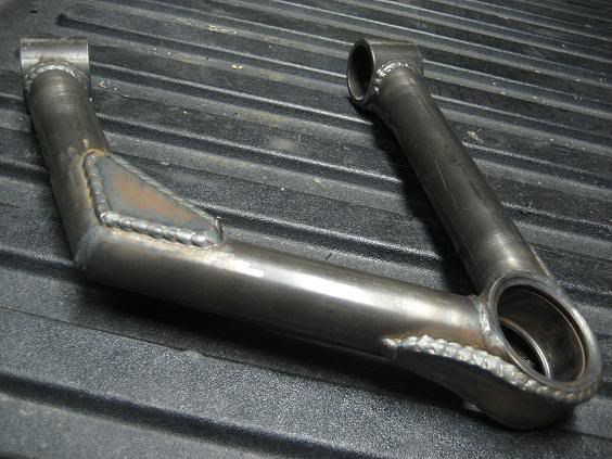

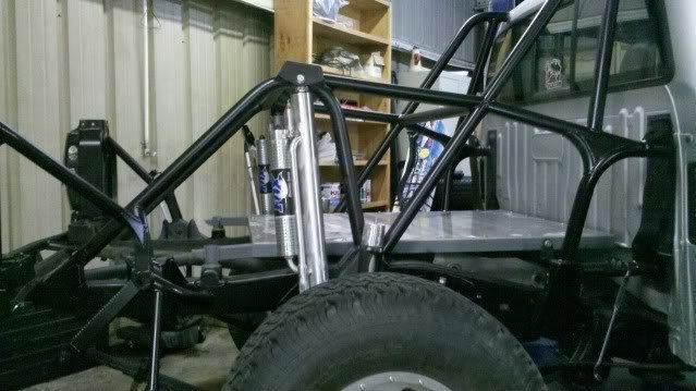

    I don't really know much about it. I do know that the LCA and UCAs use the same mounting points and angles as the Total Chaos kit. The lower control uses one Heim Joint and the stock ball-joint.
    There was a predecessor LCA and UCA that he fabbed but later had changed:
    First UCA:
    First LCA:
    First stage of cage:
  16. Aug 2, 2011 at 9:02 AM
