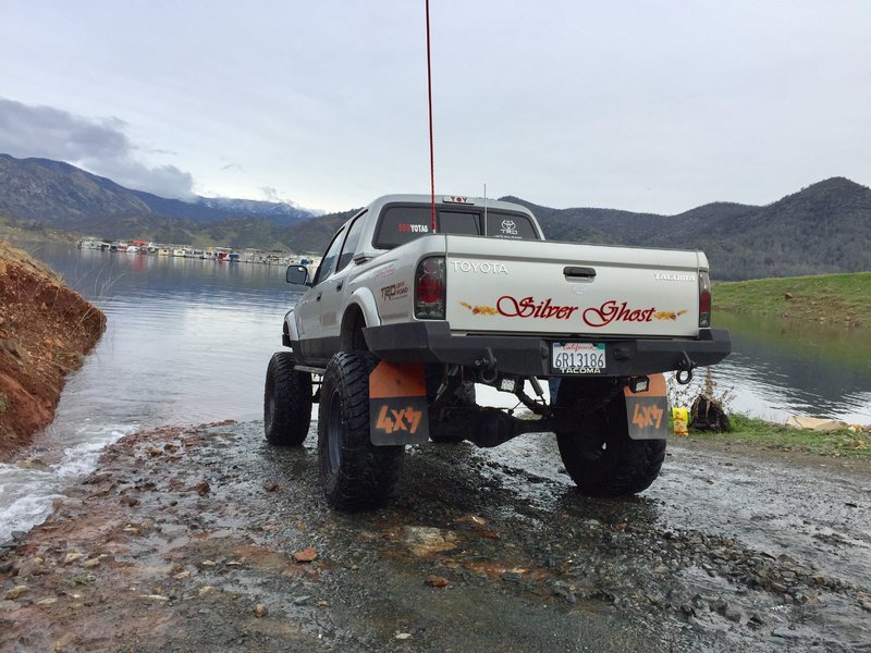

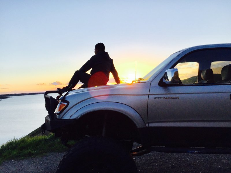

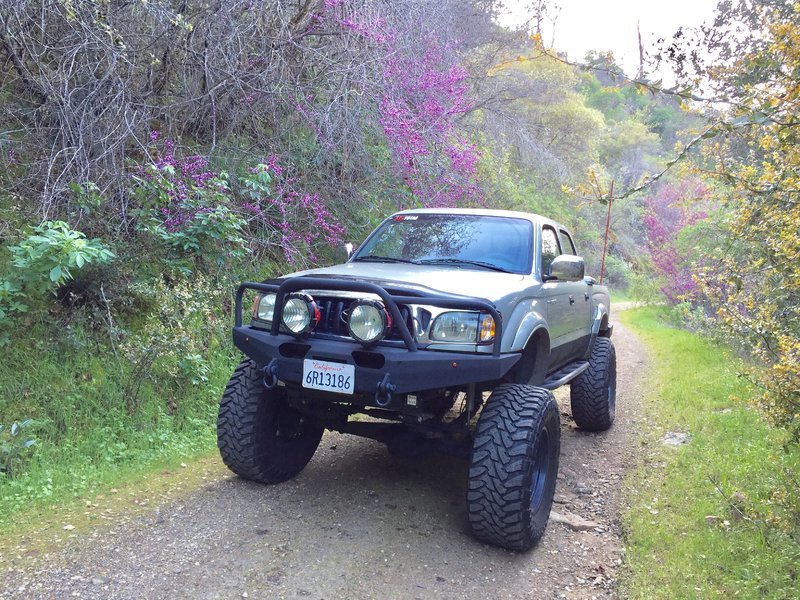

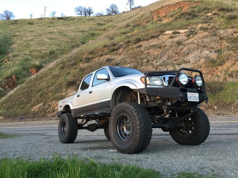

    Been using it ever since my 01 taco turned 2 year old 1 quart every oil changed and pour 3 ounces into the gas tank every 4 months Marvel Mystery Oil works like magic. My taco is 16 years old and trouble free runs like champs IMG_6697.jpgIMG_6518.jpg IMG_6141.jpgIMG_6511.jpg
