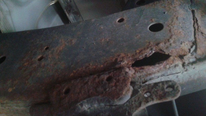

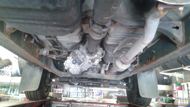

    I drove the Tacoma that I just bought this past Saturday into work today and got it up on the lift so I could evaluate the frame rust and the 2 areas pictured is what I found. I tapped on the entire frame with a hammer and besides the obvious rust the rest of the frame is solid. I'm planning on cutting out the old rusted metal and weld in new. A buddy of mine works in a steel plant and offered to fab me the replacement metal patch panels. Luckily the rusted areas is easily accessible.
