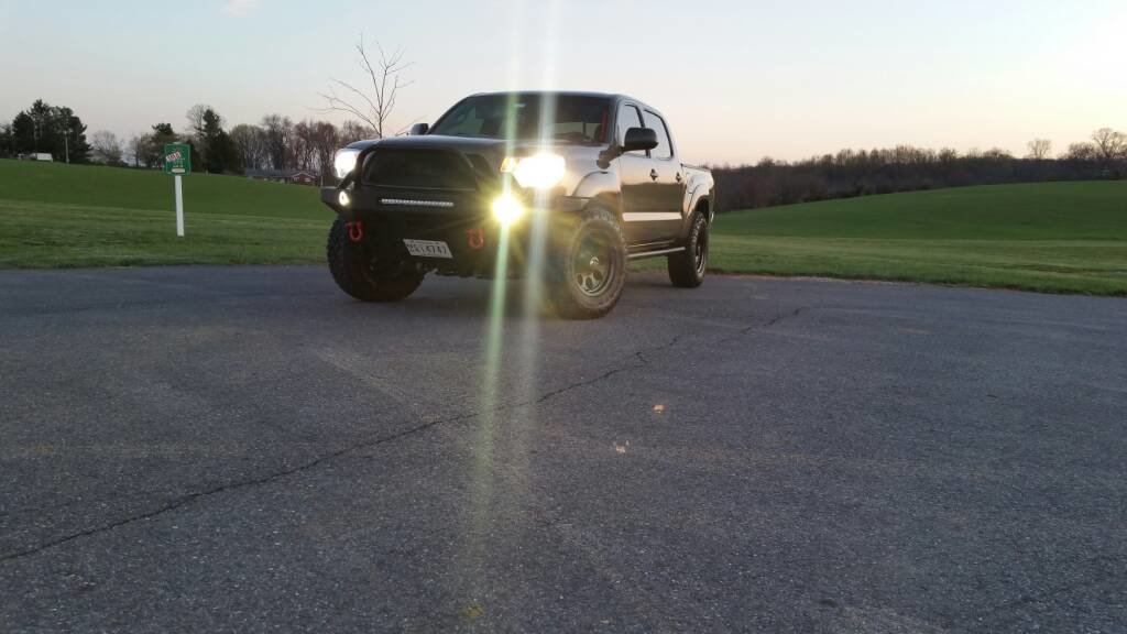

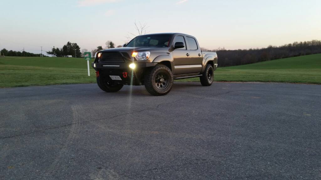

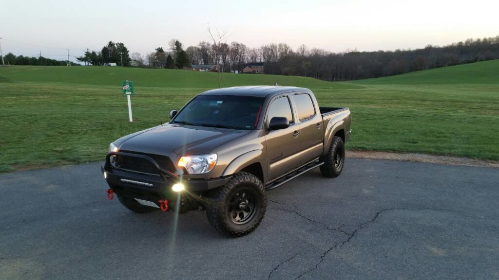

    This is everything on, I need to find an open space to align it all. 20035afa8c972bc80bdf3241b23640cc_b958cdbaf933261e3379203dd5b655e717f1248c.jpg
